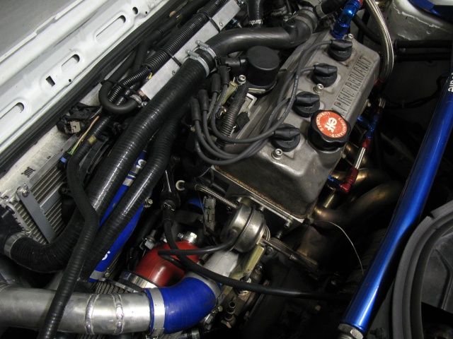

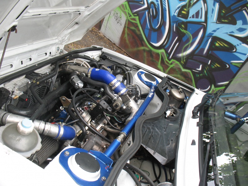

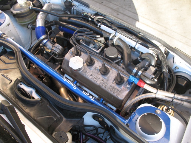

Hello, i present my project 5GTT ph2, year 1985 white 389.
Engine
- piston Wössner
- FGS800 shirt
- 314 cat cams camshafts
- Dump Bonalume

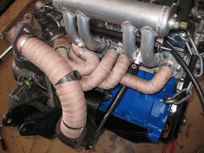

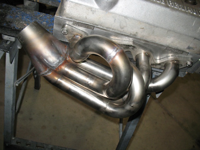

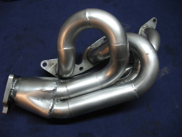

- Inoxline exhaust manifold

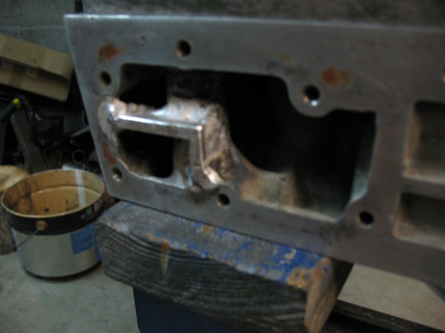

- Intake manifold injected R5GTT
- Megasquirt ECU, sequential injection, ignition coil jumostatique, Map 0/43 psi, launch control and flat shift
- Walbro fuel pump
- rev limiter 7200
- ratio of 8.0 / 1
- down pipe KTR 2 "1/2 (63mm)
- exhaust system KTR 2"1/2 (63mm)

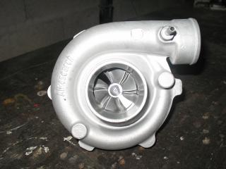

- T25/T28 Hybrid turbo
- Intercoller forge

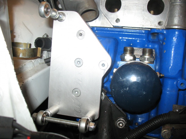

- 13 oil ranges
- S5 radiator diesel

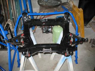

Suspension Details
Front:
- Viarouge
- Apex -45mm
- 20mm spacers
Rear:
- Viarouge
- Clio 16V rear-wheel axle unit
Brakes
- Pug 406 V6 23,8mm master cilinder
- Brake caliper Brembo, front disc 280 clio rs.

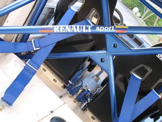

Interior

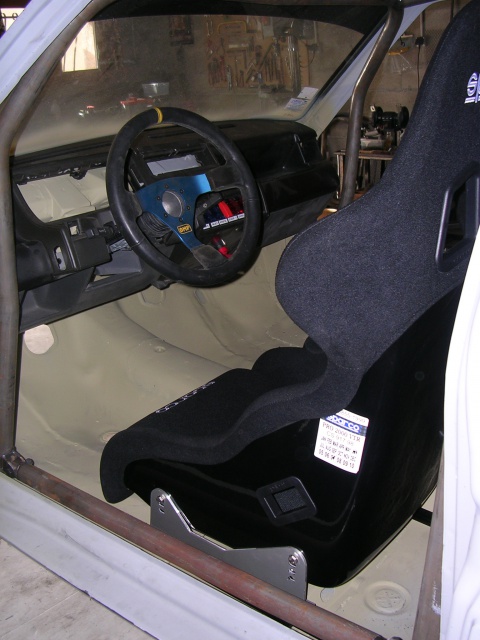

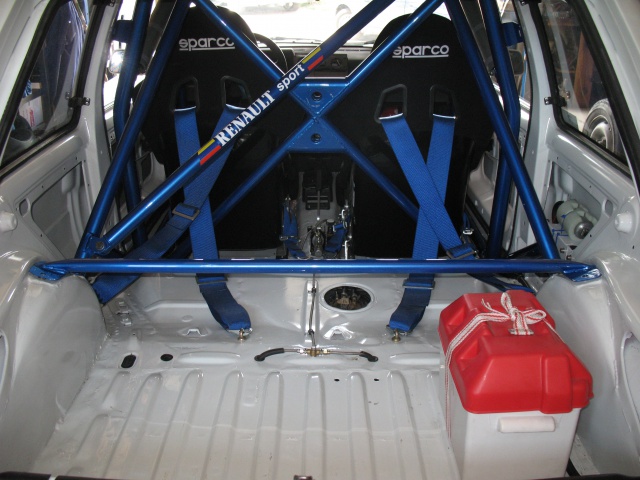

- Sparco seats

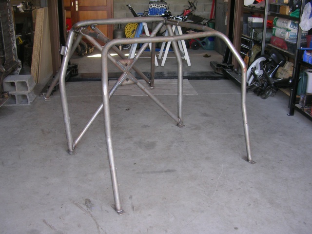

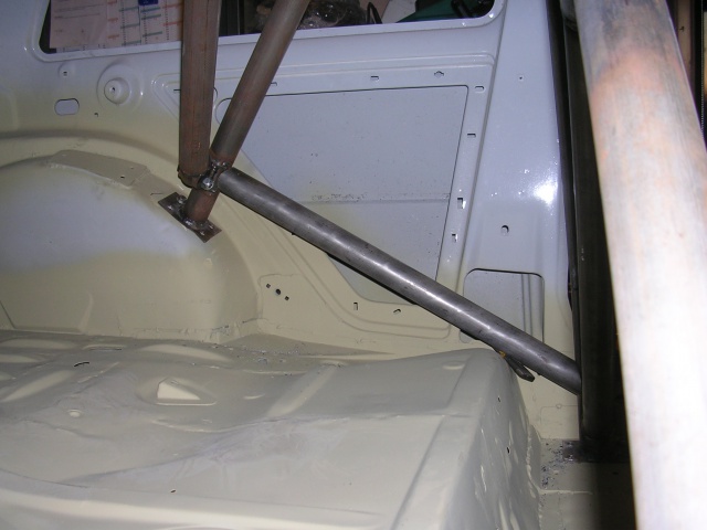

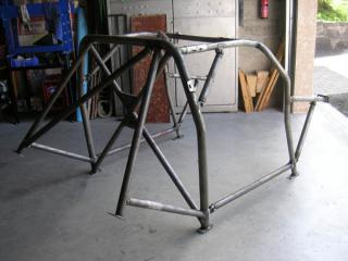

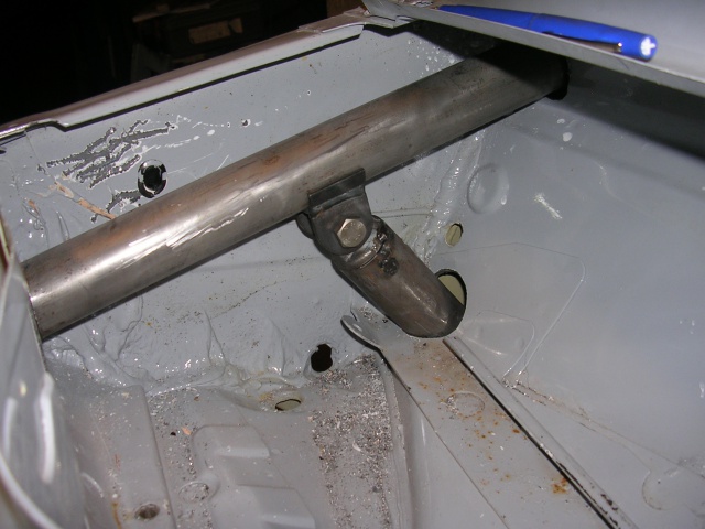

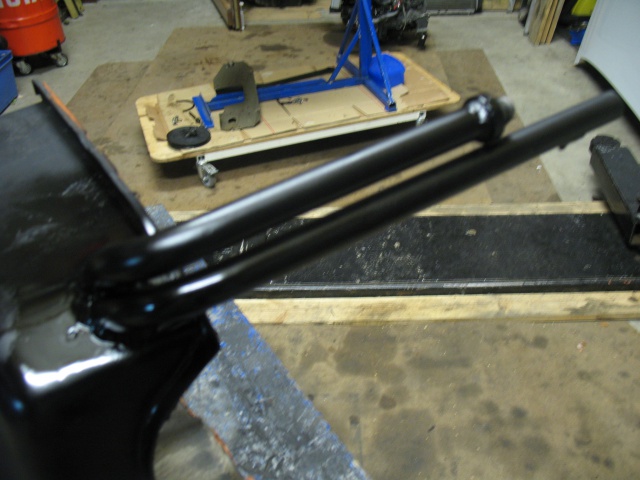

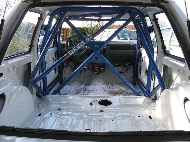

- Multipoint cage hoops

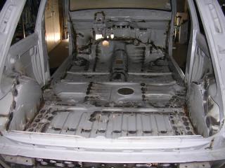

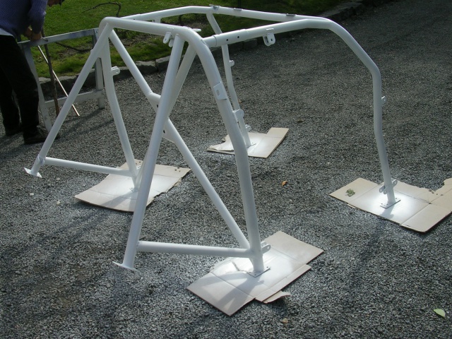

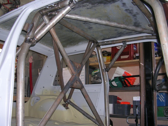

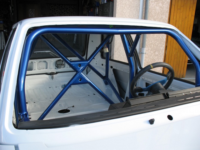

photograph here :
Multipoint cage hoops :
front :
Inside :

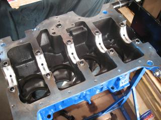

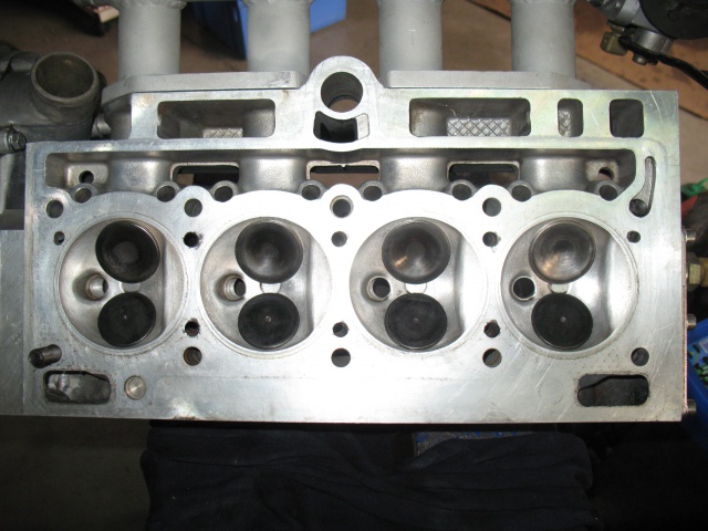

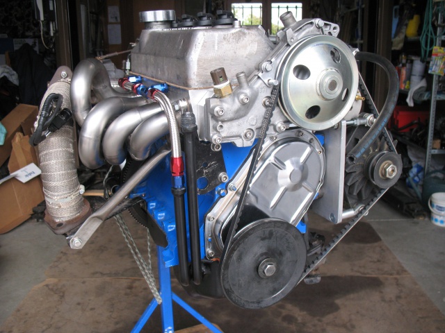

Engine :

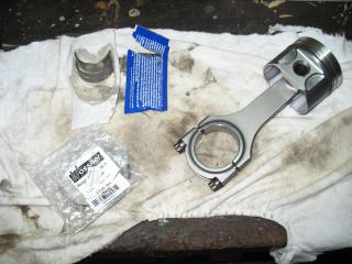

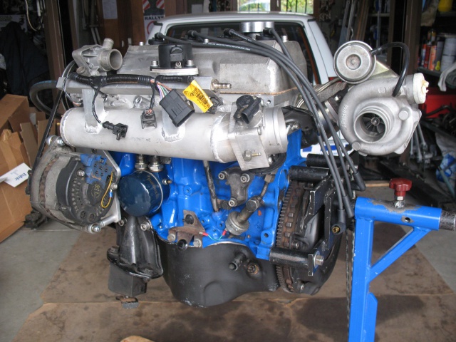

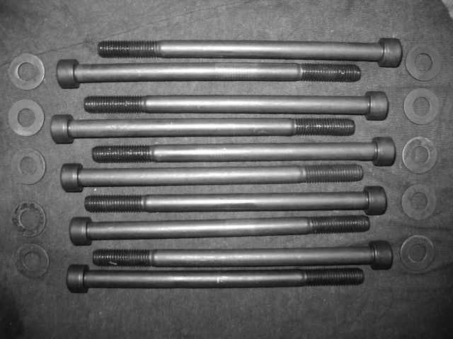

connecting rods and pistons Wossner :

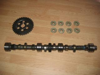

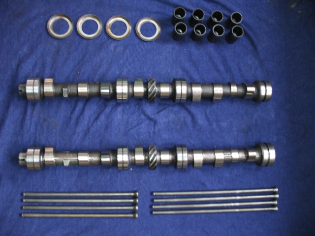

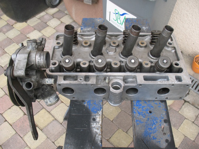

CAMSHAFTS Cat cams 314, SPRINGS, PULLEYS KITS
Inlet manifold efi :
T25/T28 :
Engine :

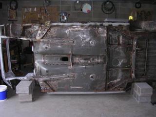

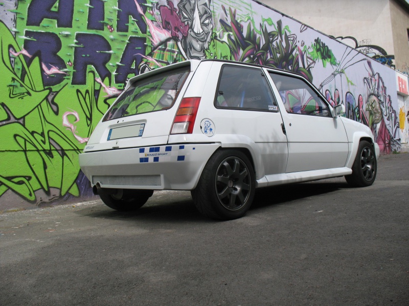

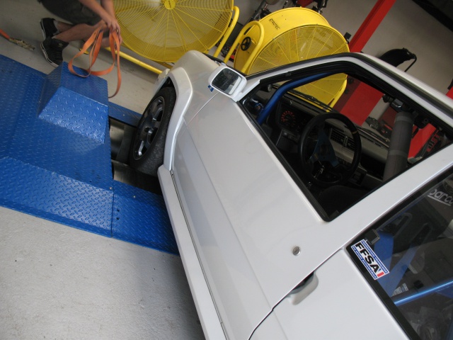

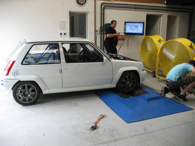

The cars :
