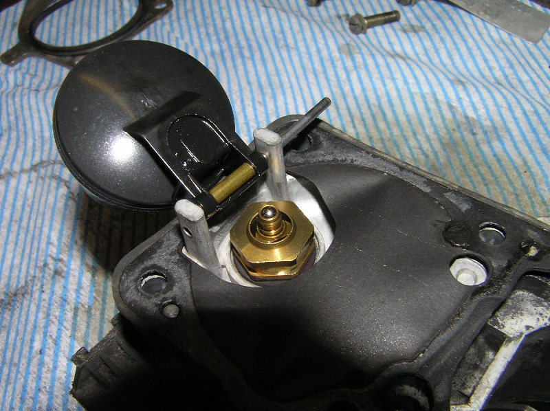

9. Unscrew the float valve, and remove along with it's copper washer.

13. Fit the new float valve and washer from the kit.

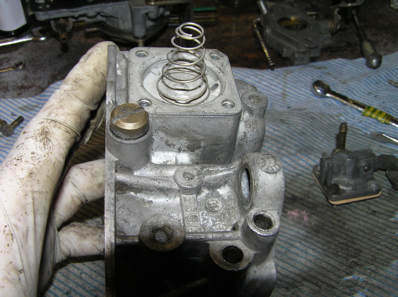

24. Undo the four screws holding on the accelerator pump body, and remove.
25. Remove the diaphragm and spring.

39. Refit the accelerator pump spring - note this goes the opposite way round to the original, as the replacement diaphragm has a smaller metal disc in the centre.
40. Fit the new diaphragm to the cover, and refit the accelerator pump to the carb.
