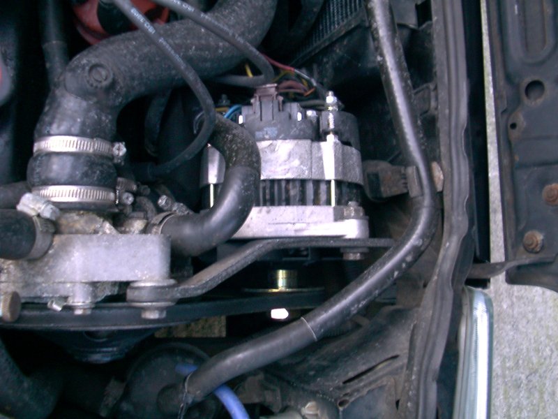

To replace the alternator:
1) Disconnect battery negative lead.
2) Disconnect the wires from the positive alternator connection (nearest engine, 10mm nut).
3) Disconnect the wires from the negative alternator connection (8mm nut).
4) Disconnect the warning lamp connector (top of alternator, brown plug).
5) Remove bolt from top of alternator, where it fixes to the adjustment rail (13mm).
6) Pull alternator away from front of car, and remove the belt from it's pulley.
7) Swing the adjustment rail upwards, out of the way (you may need to unclip the coolant hose that runs along the front of the car)
8) Swing the alternator forwards, so it's resting on the plastic shield next to the headlight.
9) Remove the other alternator bolt (13mm).
10) Remove the alternator from the car.
11) Clean up the connectors on the wires with glasspaper or a wire brush.
12) Fit the new alternator into position, and refit the lower bolt.
13) Swing the adjustment rail back into place.
14) Swing the alternator back up and slip the belt over the pulley.
15) Refit the top bolt, and push the alternator forward to get the belt tight.
16) Tighten the top bolt.
17) Connect the warning light plug.
18) Connect the negative alternator wires.
19) Connect the positive alternator wires.
20) Connect the battery negative lead.
21) Start the engine and check the belt isn't wobbling/slipping/binding.
