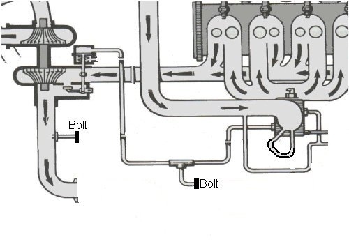

It involves simplifying the boost control pipework. This consists of removing the T piece and short pipes from the carb top to carburettors middle outlet and connecting the front actuator port direct to the carburettors middle outlet and blocking the carb top. Removing the pipe from the rear actuator port to carb top to turbo elbow and blocking the turbo elbow and carb top.
The carb top is easy, just loop a short length of small hose to the two disused ports. Or on some matal carb tops unscrew the two ports and fit two bolts which will be either M8 for K-Tec or 1/8 NPT for GTTuning.
Leave back actuator port open to air. Sometimes people find they get a bit more boost by blocking this. This is because the actuator spring has weakened and the actuator needs to be replaced.
For the turbo elbow Renault used to sell a plug, part number 7703075121, it's no longer avaliable and the part no has been taken off the system.
A cut down wheel bolt works but you can buy, probably for a few pence from your nearest hardware store, a 12mm diameter bolt with the standard 1.5 pitch thread, known as isometric M12.
If you or you local shop are not sure what one of those is then you can take to the shop the original fitting that held the metal pipe work into the elbow as it has the correct thread on there. Get them to offer this thread up to the bolts they sell until they find a match.
It only neds to be about 20mm in lenght with the thread going right up to the head. My local shop only had 50mm bolts with the thread going only part way.
As a temporary fix for the turbo elbow or for a quick test you can simply block the rubber pipe at the end of the metal pipe where it leaves the one way valve by the carb top.

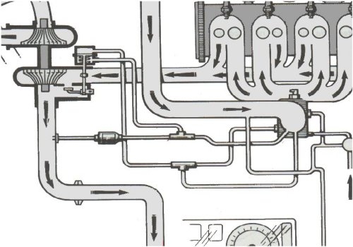

 | Standard system | Modified system | 1) Carburettor body,
2) Carb top elbow,
3) Turbo actuator,
4) To the exhaust elbow,
5) Actuator adjusting rod |

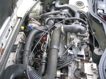

Showing the carb top and pipe from carb middle
Phase two standard pipe arrangement
Cup mod pipe arrangement

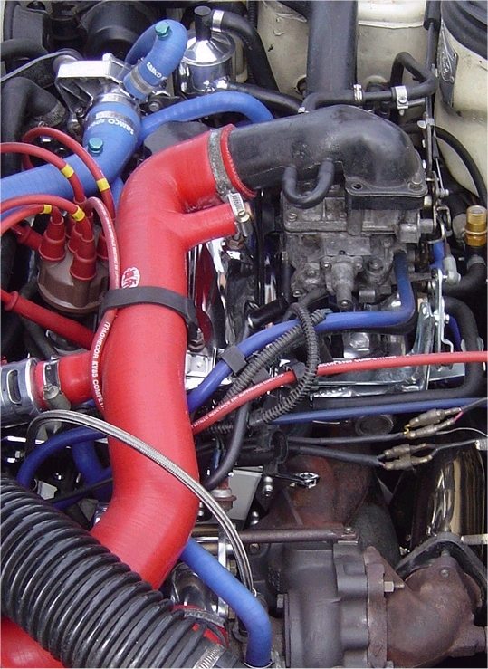

An early phase one with cup mod as standard

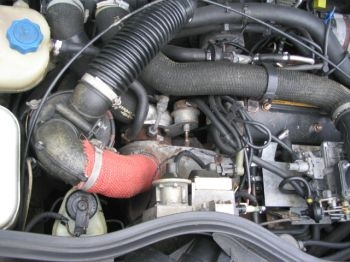

Showing early single port actuator
