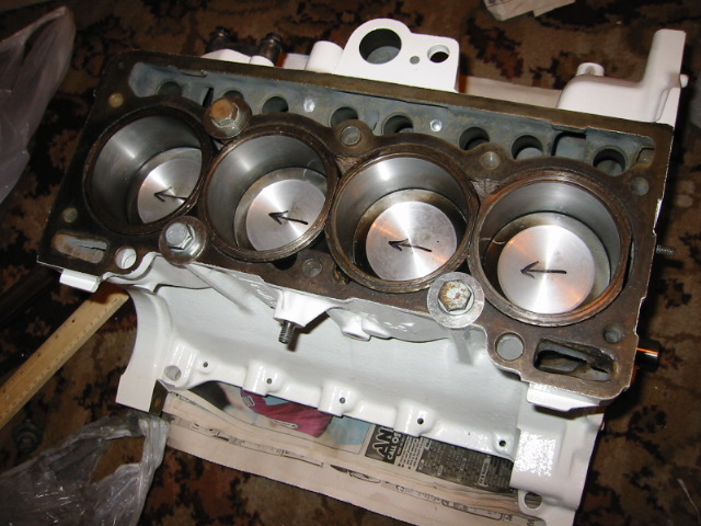

Measure the depth of the area rebated into the top of the piston and measure the width of that area.
To measure the depth you could lay a rigid bar across the whole top and use a dial or digital calliper to measure from the top of the bar to the bottom of the rebate. Then measure the bar thickness and subtract that from the overall, and that leaves the rebate depth only.
The width is a bit of a guess as the edges will be radiused a bit. So pick a place maybe half way up. Also it would be wide to measure the top of the rebate and the bottom of the radius, so as to be sure the pistons are all the same.
Also you could measure the overall diameter of the pistons across the width of the top, and the depth from the top to the upper piston ring. Should be the same but if the pistons are a different make from different years, even though they're all from the same 'tuning company' or parts seller, they could be different. 'Tuners' had some machine out the rebate in lowered compression versions, they don't come from Tarabusi or Perfect Circle like that. If they are forged, then from another manufacturer, but not dished unless specially ordered that way, and maybe not even then. From year to year 'tuners' may have use different machining companies and they may have take different sizes of metal out. It might be possible to get them matched if they are slightly different. They best be the same make though.
From those measurements you can calculate the volume of metal that's been removed and then the compression ratio.

My dished pistons
