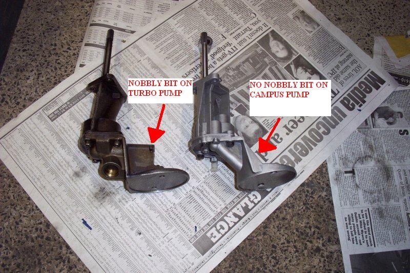

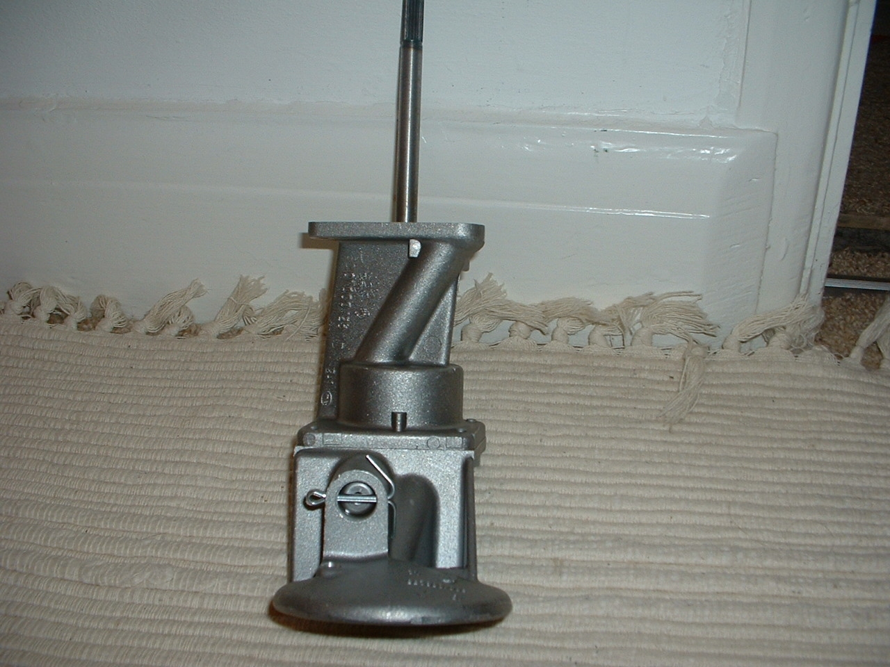

They don`t have the part number (7701635029) stamped on the pump.
Turbo pump has a split pin.
Campus pump doesn`t have a split pin.

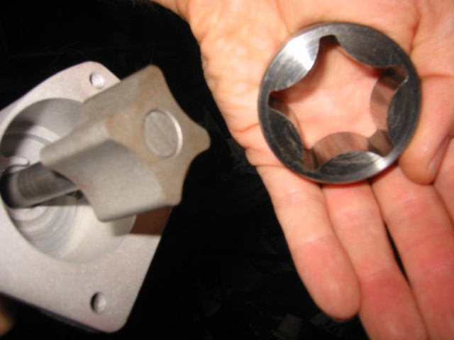

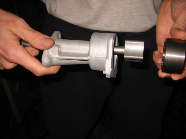

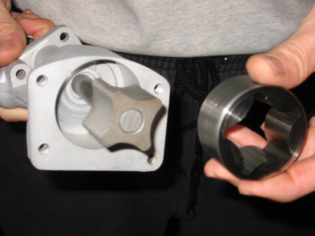

-With the oil pump housing separated it is possible to remove the two parts of the rotor, do this and wipe all the internal surfaces of any oil.
-With all oil cleaned the two parts are re-fitted and measurements of rotor clearance can be taken. See Picture 2;
The clearance allowed for A are: min 0.04mm and max 0.29mm.
-For the second measurement turn the rotor until it matches the same position in picture 3, then take measurements at both B.
Clearances allowed for B are: min 0.02mm and max 0.14mm
-If the wear exceeds either of these tolerances the pump must be replaced or new internals fitted.

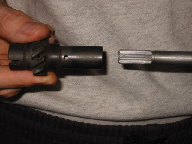

See the wear on the splines
5GTT pump on left and 'Campus' pump on right

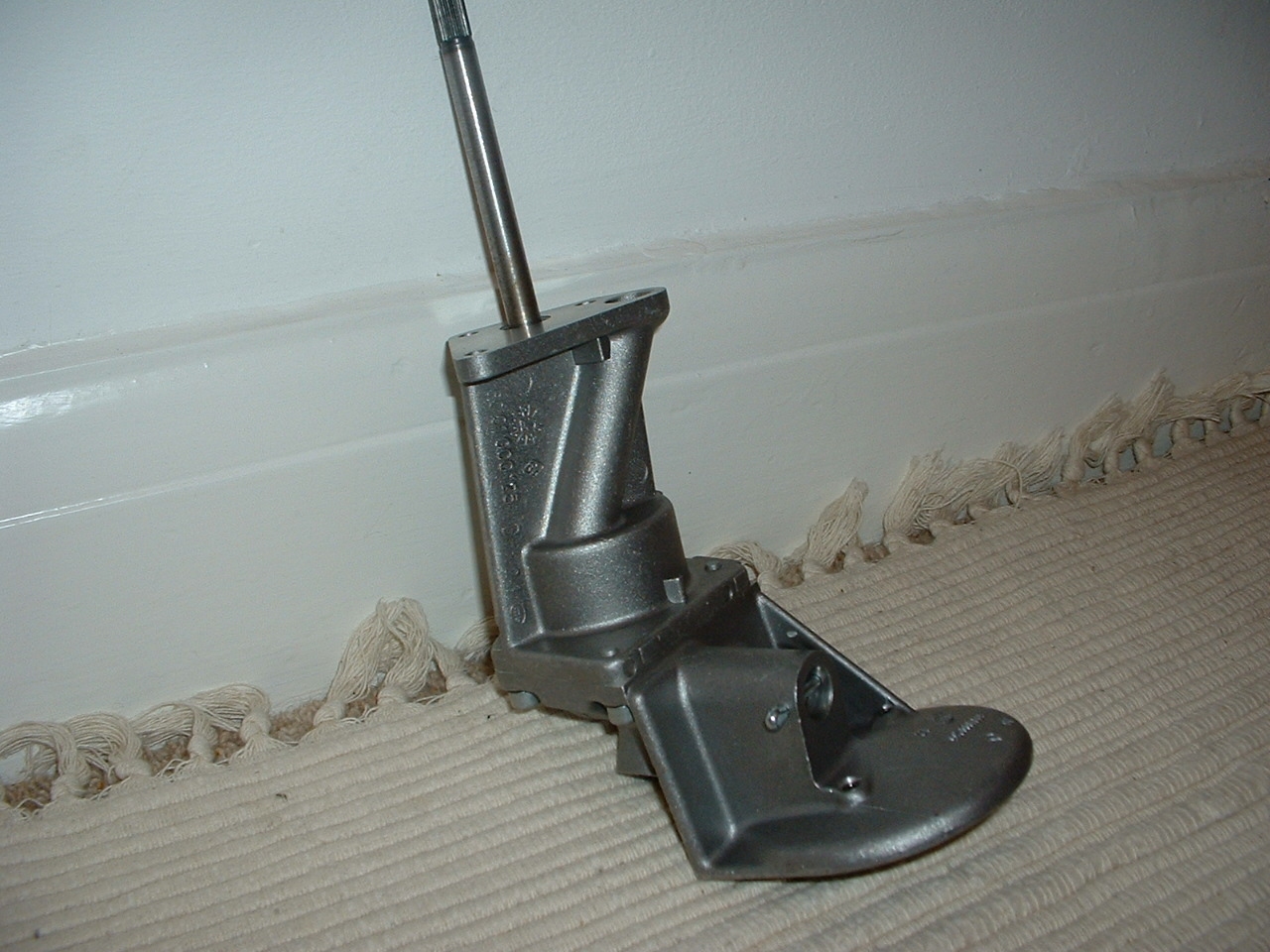

5GTT oil Pump
5GTT oil pump
