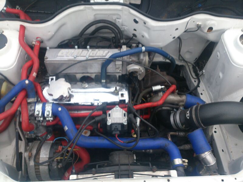

Here is a pic of one of my old GTT's. I turned the associated heater matrix hoses over so it ran the other side of the bay (and with a bit of tie-wrapping, it just fits, if not the best shape), chopped the small top hose down to the right size to fit straight on the swirl pot and then butchered the other hose to the water pump and joined it up (you can see the two jubilee clips in the pic). No bracket required, the header tank just sat there due to the position of the hoses.

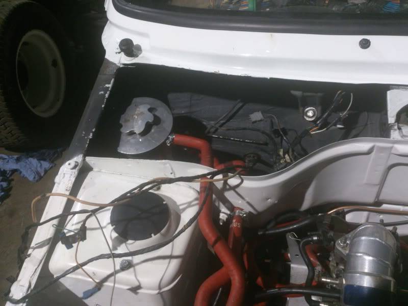

Drivers side scuttle area Trev.

Good pictures them to go off. Same way i did mine

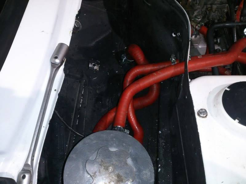

All done

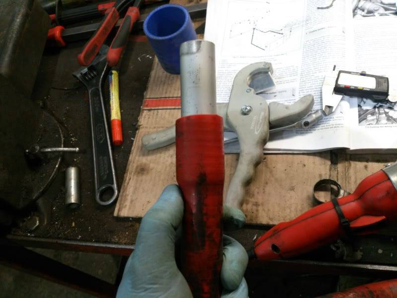

Top tip for cutting your hoses straight , put a jubilee clip on it then cut around the edge
