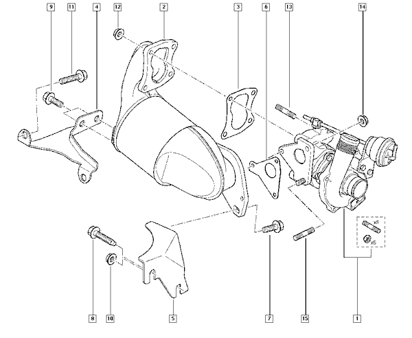

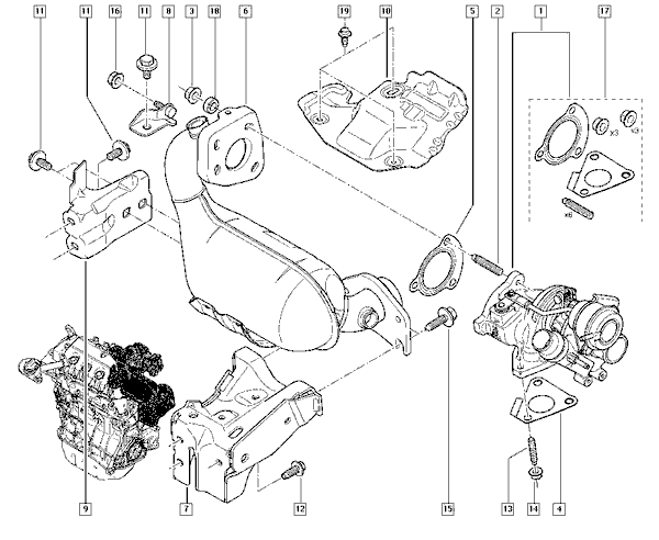

The top one's a KP35 Borg warner unit, super small, a T2 is larger in comparison.
The second is a Mitsubishi turbo, not sure of what frame though. A TD25 of some sort?
The top one also looks very similar to the clio diesel 1.5 turbo, the same one used on the Micra.
Don't Renault also use KKK on the deisel range and Mitsubishi for the petrol...

uber small units then, what boost they good for adam?
just found this on the borg warner unit
http://findarticles.com/p/articles/m...67/ai_76736517
not sure if converted the quoted boost pressure right but im sure it equates to over 30psi, but lists it as the diesel turbo
They've all got 360 thrust bearings as std, but that doesn't really count for much. I can't remember what boost they run stock either. Personally, I wouldn't try much over stock boost.
I doubt they run 30psi, i've only ever seen big cranes and CAT machinery run that kind of boost.
Around 18psi would be a good guess for a diesel. For a petrol the actuators are usually set to 5psi or so, the rest is controlled by a solenoid.
Ah, wait, I just remembered. I tested one of those KP35's a couple of weeks ago to get a boost reading and it was 25psi or so. So I guess it's not all lies...
ill wait to get the reg to find out what turbo is on the car. surley such a small turbo cant be efficient at such high boost?
They flow a hell of alot better than the old turbo's. The comp housings on those Borg warner turbo's are so smooth inside, perfect moulding, nothing like the old T series. It's the same with the comp wheels and shafts.
