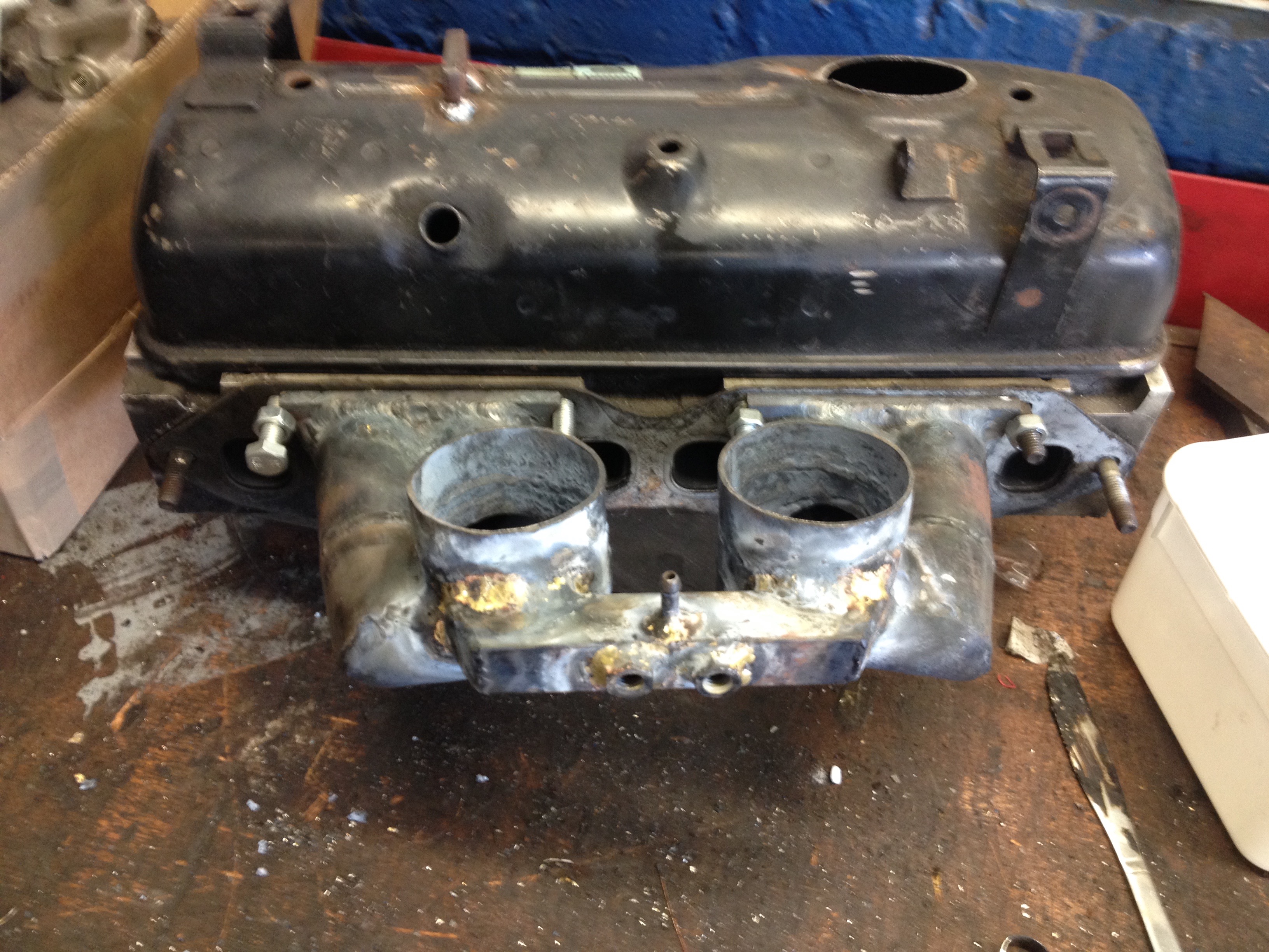

    I will be blunt, but I'm not convinced with that manifold? it's certainly not the prettiest thing I've ever seen. I guess the proof will be in the pudding and I'll get my spoon ready!

    You could well be right Matt. It should flow and mix I just hope each cylinder is equally served, there is a potential for the outer ones to run lean. I can try a infra red thermometer on the exhaust manifold or a cooking thermometer might show up a issue. We have to get it to run first!

    Hi Russell, I don't want to sound overly negative or excessively critical, and it's sometimes somewhat interesting when people do an EFI conversion to their carb'd five. And perhaps that photo is not representative of what is going on there, but from that it looks like it shouldn't flow! There can be a fair bit of engineering to this task to optimise it, and from that it looks like none has been applied?
    There have been / should be so many photos of EFI conversions around to have a look at. A few with 5GTT C1J's. philr5t 's one made maybe 330BHP from a single throttle body and a smoother looking manifold with no 90° bend in the middle.
    That welding (brazing) on yours is terrible looking. Maybe it will grind off but should not be like that in the first place.
    Have the people you're using ever done welding before? Or made and inlet manifold?

    You need a bit of swirl! besides nothing set in stone we can always have another go. It may leak like a sieve when we pressure test it. Your comments will go down well with the pit crew (especially Andy's co workers!)

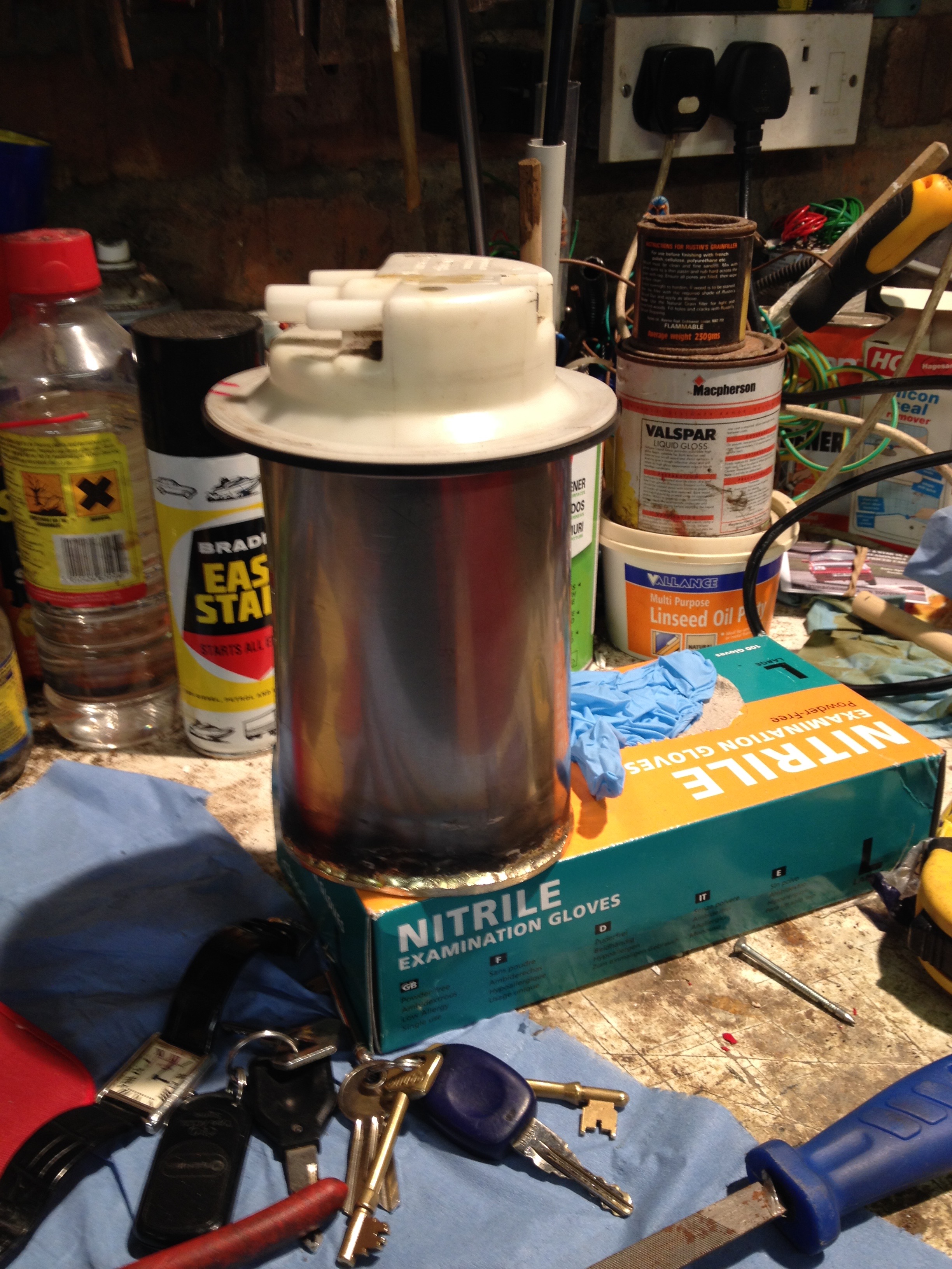

    Anyway a more pressing issue has arisen. Due to a misconception of how the reserve tank fed the main tank, with my swirl pot in place she ran out of fuel (with Andy driving and he had no phone so left to walk back to the garage). Heads been scratched and back to the drawing board.
    Russell

    For an optimised setup you really need 4 ITBs joined together with a plenum or a plenum with a single TB on the end.
    On an inlet manifold with a small volume you run the risk of unequal charge getting to each cylinder, as the the pressure in the inlet doesn't stay consistent.
    What you have there, is effectively 2 inlet manifolds which are now of a Siamese port design. This isn't too much of an issue on a carb as you have a wet manifold setup, but on an EFI setup you can have serious issues with charge robbing between cylinders.
    If you plan to run that inlet manifold, you really need to test it with an equal length exhaust manifold with a EGT sensor boss on sample tubes on both inner and outer cylinders to check the difference.

    I have the same concerns Matty hence the comment about using an infrared thermometer. I wonder if you can get temperature sensitive paint. In medicine we use a tape that changes colour at a certain temperature to show that instruments have been correctly sterilised. I could put that on the exhaust runners. Thermocouples would be another idea.
    I reckon that the induction strokes on the 2 pairs of cylinders follow each other so as long as the turbo can supply the air flow the second induction stroke should obtain the same air fuel as the second assuming the path into the cylinder is not unfavourable. We have connected the 2 sides so as to help equalise the pressures. Anyway as I keep saying we have to get her to run first.

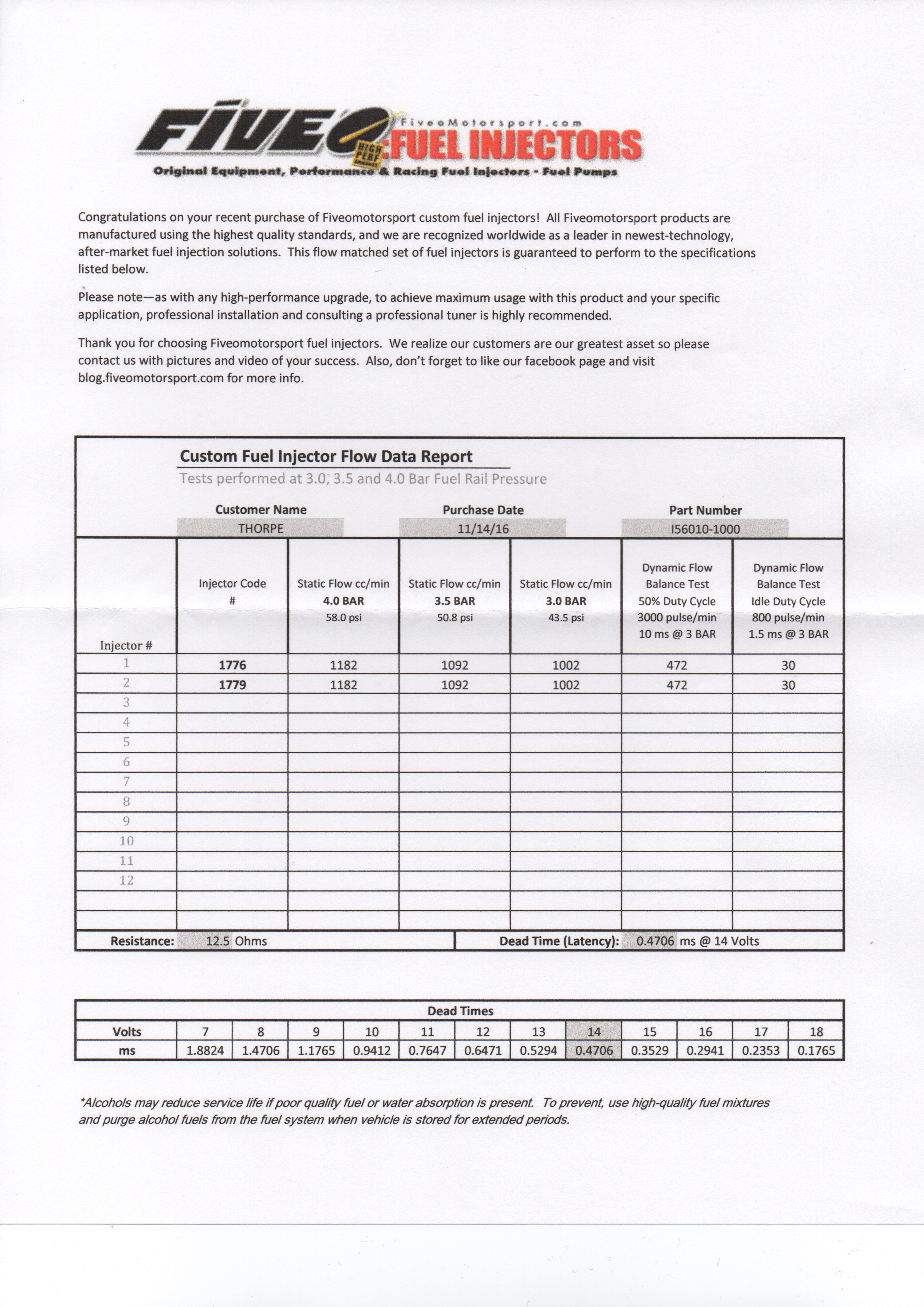

    The injectors arrived today

    If I'm not confused, adjacent cylinders, will be sucking at the same time. One nearing the top of it's exhaust stoke and the scavenging sucking some initial air in during the overlap. And the adjacent one nearing the bottom of it's induction stroke, hence the robbing of air.
    Or maybe that's one and three, etc. I can't think it through clearly just now.
    Is it not that air is elastic and columns of it squeeze up behind a closed valve and burst through as the valve opens. A pulsing effect.

    An infrared sensor will work if you can get one that goes high enough, mine goes to 300 degree C then won't read.
    Exhaust temps will be around 600-800degrees I would think.
    Ian with the firing order being 1342 or if you look at it 3421 3 and 4 and 2 and 1 is where you get the issues. When 2 opens the air is effectively static on that runner, so you get a momentary pause on air going into that cylinderswhilst fuel is being squirted in, so when 4 opens air is already flowing through that port (TB in this case) so you can end up with a leaner mixture on the second pot to take the air.
    Depening on the runner efficiencies and lengths they can run more efficiently at different rpms. So you may get rich inners at low RPMs and leaners outers the opposite at higher rpm. With a single lambda reading taking the average, it doesn't give a true reading of what is going on with each cylinder. Tuning slightly on the rich side is a compromise to stop det but may sacrifice some power.

    The new injectors fit with no need to modify the throttle body or the fuel rail, which is good.

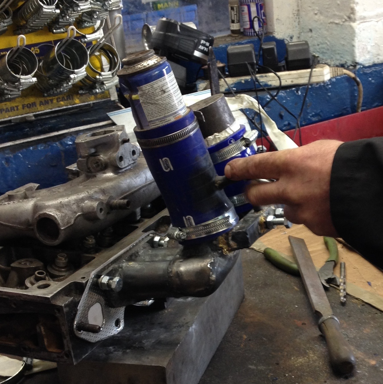

    First trial fitting of the new inlet manifold with the TB's on Doris

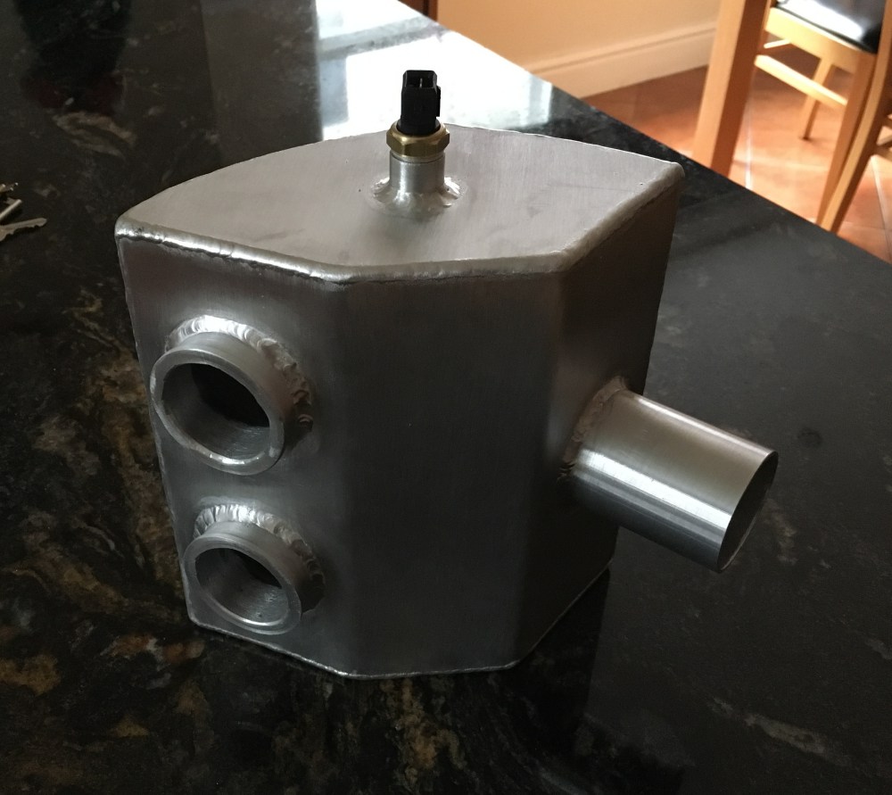

    Plenum back from the welders
    https://www.rtoc.org/files/Technical%...num%20done.jpg
    Note my plenum is before the throttle butterflies not after it/them. Is that significant?

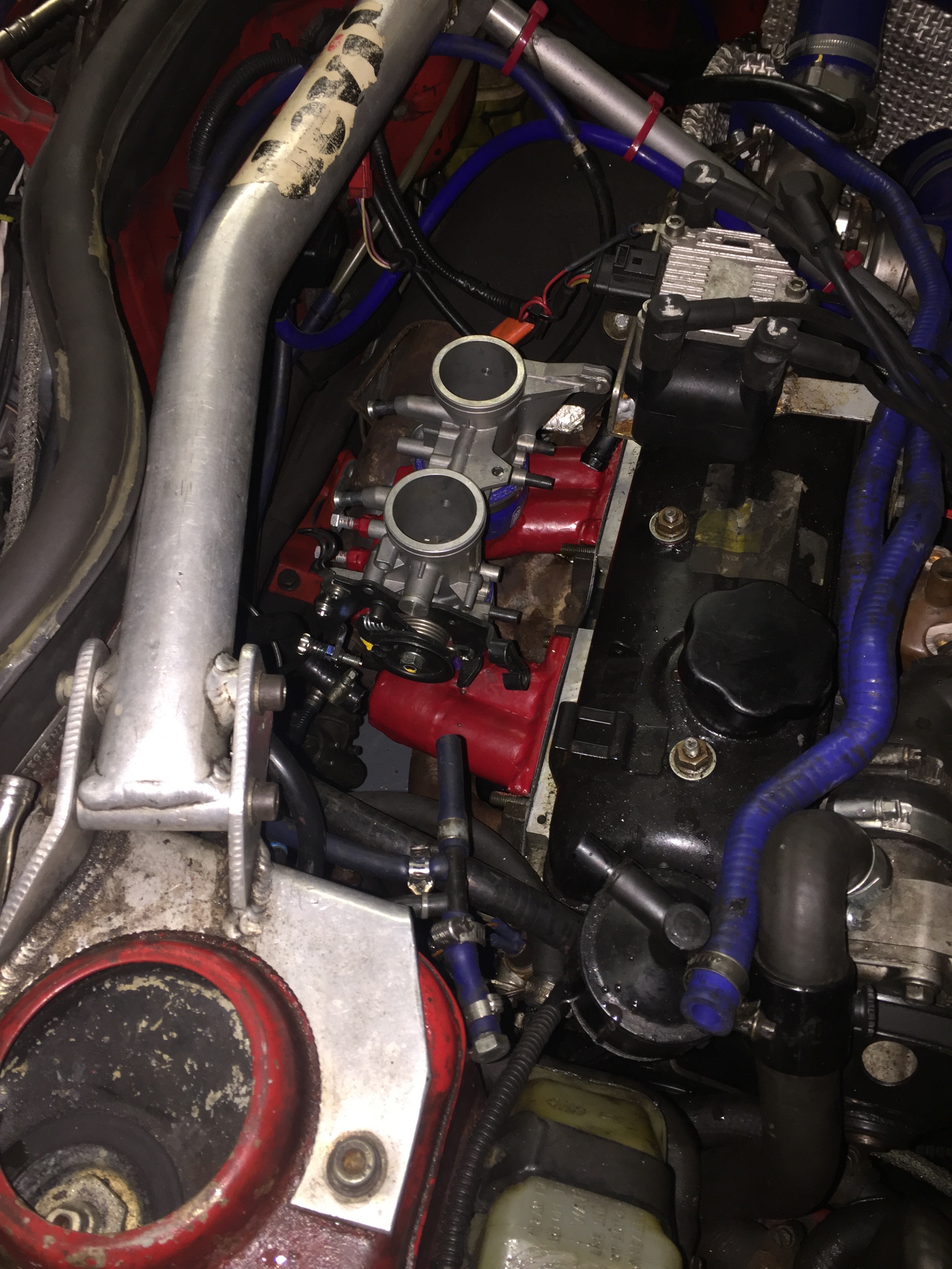

    Plenum trial mounted. Throttle cable sorted. Next task is to relocate the coil pack, it just needs to n=be moved to the nearside a tad.
    I will be contacting Scoff at EFI for info on the wiring of the air and water temp sensors and a base map to try and get her started.

    That looks good. Plenty of volume which is always good.

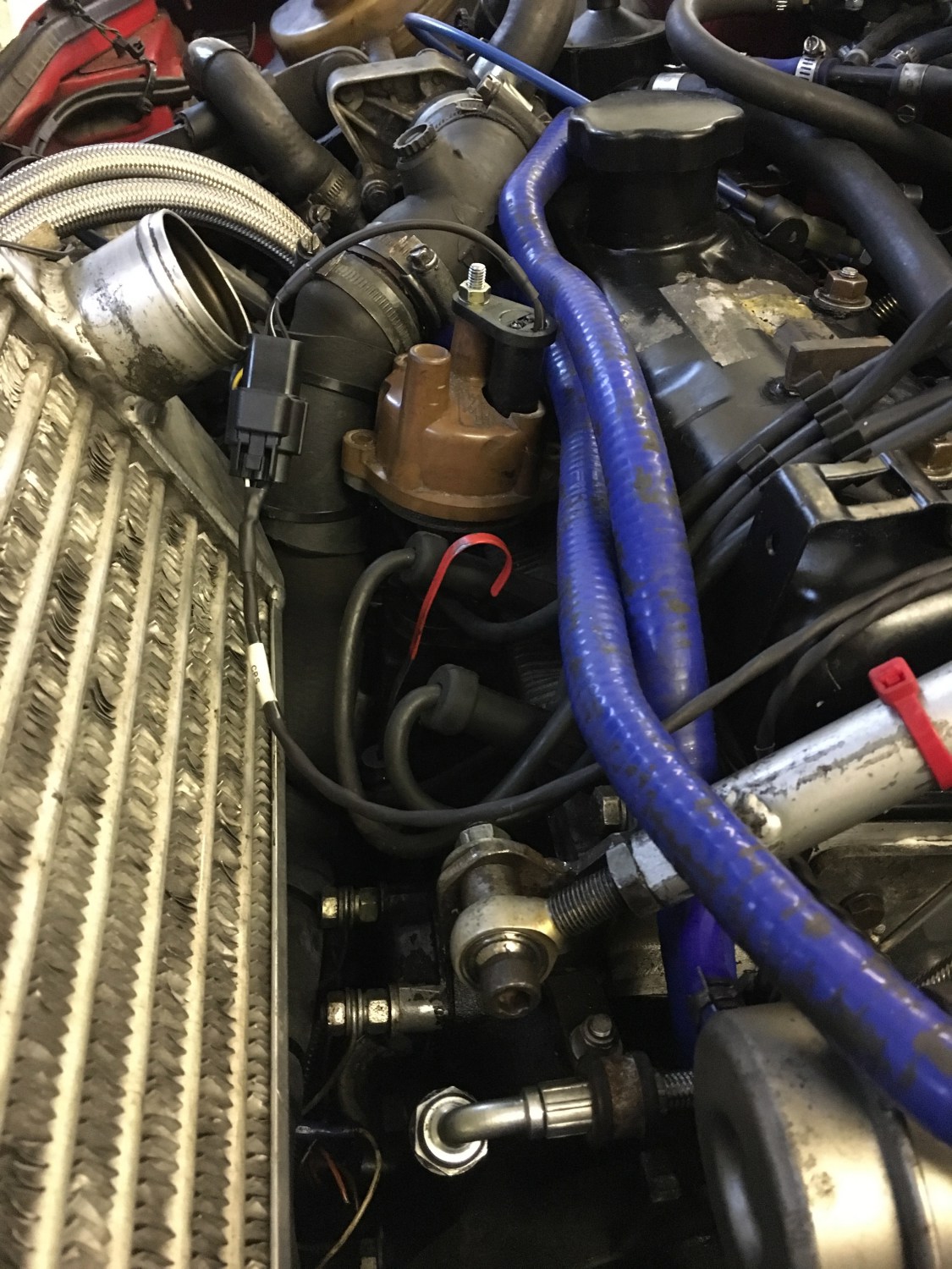

    Utilising the dizzy as a cam position sensor.
    The rivet on the arm is drilled out and the copper contact replaced with a small bolt. Its adjustable by turning the distributer on its shaft.
    https://www.rtoc.org/files/Technical%...%20trigger.jpg
    Start up is planned for Sunday The latest issue we have is that I couldn't get the ECU to talk to my laptop. In 2 days that has to work.

    If you are running a comms port to USB adapter, some just don't work with ECUs, may be worth trying another one if that is the case.
    Non-member RussellT's Avatar
    Blackpool
    786
    Re: EFI for Doris
    It has worked previously always been a bit temperamental but by chance I have another serial port addapter I can try
    Re: EFI for Doris
    If its them cheap Chinese ones forget them ever working correctly! I need a good quality one for my 420b. I just cant get it to work on a modern USB laptop!
    Blackpool
    786
    Re: EFI for Doris
    My mistake. In the dark, wed night fiddling in the glove box I connected the 6 and 8 pin plugs the wrong way around. Connects to laptop now I just hope I havnt goosed the ECU.

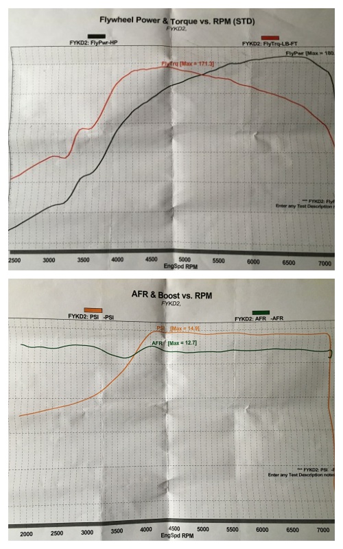

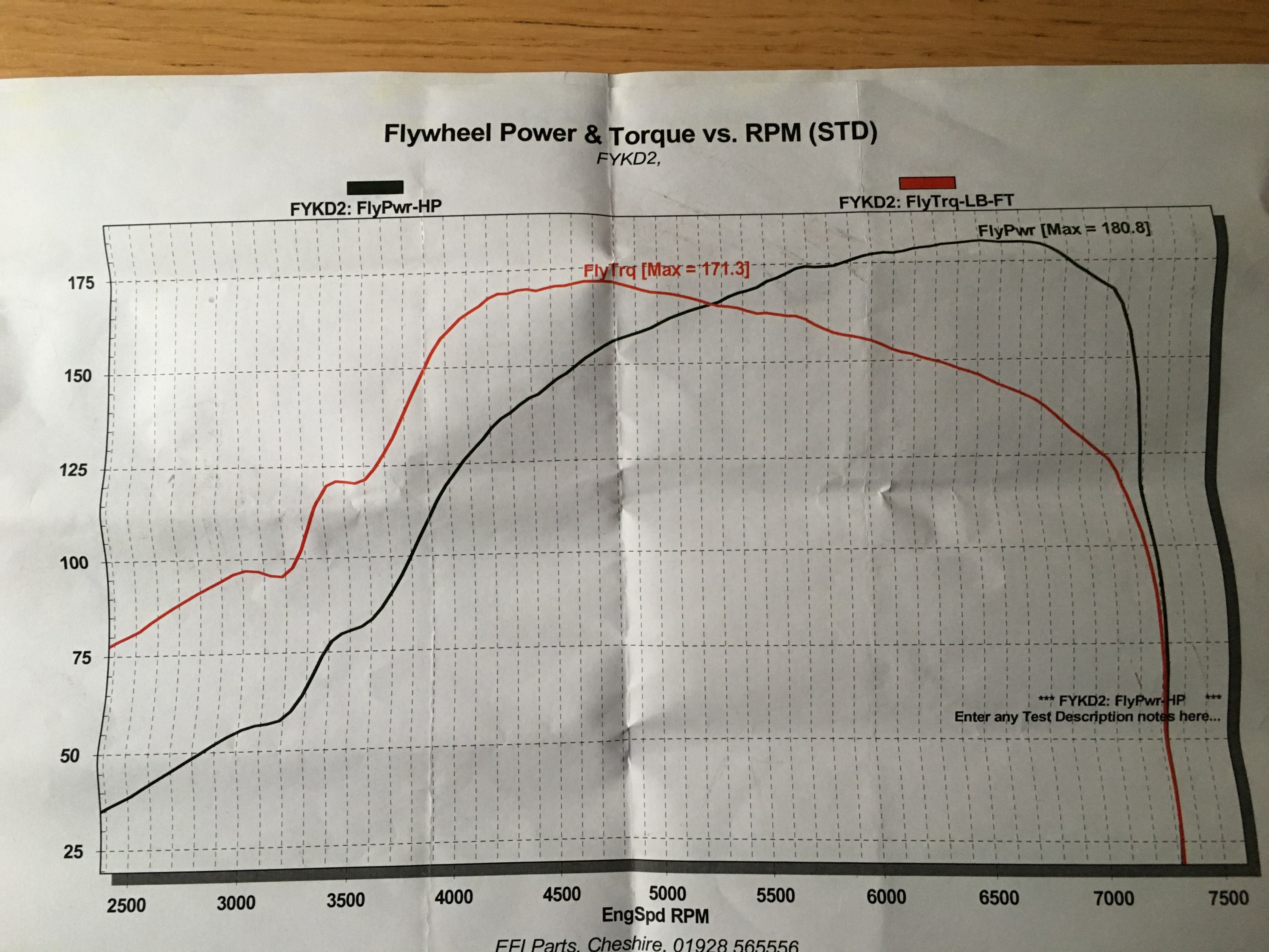

    Scoff spent today just getting her to work. Predictably some issues with the unusual set up. Fuel can pool in the inlet on idle causing coughs and splutters when you open the throttle. Also issues with enrichment on throttle opening. The first cylinder of the pair scoffs the lot leavin the second cylinder rich.
    However she runs sweet throttle response a tad inconsistent but far from bad.
    Anyway at 14 psi she produces 180 BHP and 171 lb/ft torque.

    That's good numbers for the boost. have you got it to a point of being a nice drive?
    Siamese inlet ports really don't lend themselves to EFI setups unfortunately.
    Injector angles can play a big part also, but you will always get more power with individual inlet runners.

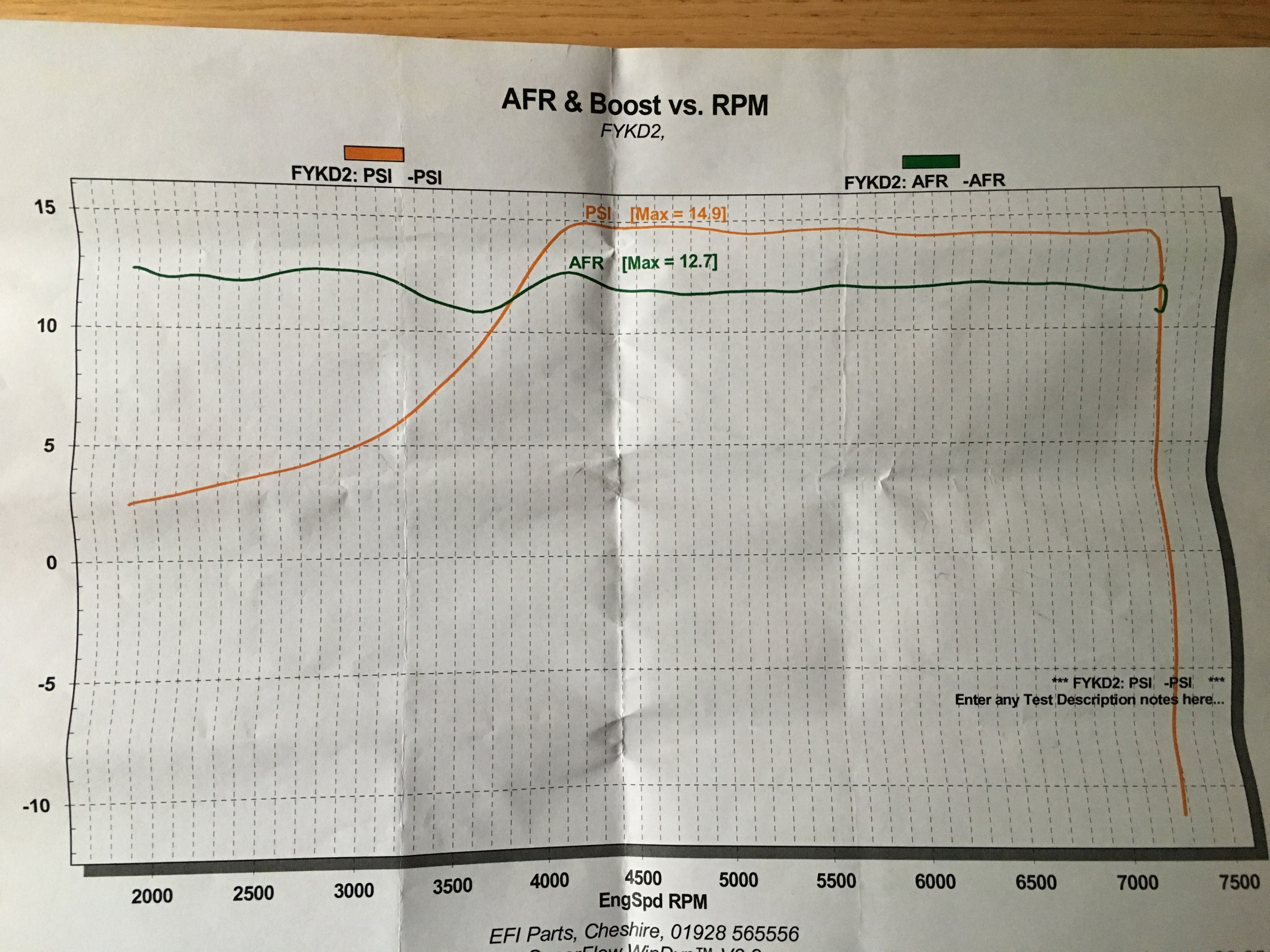

    ill post a low boost graph, that's all I have at the moment Scoff spent all day making her work.

    As promised
    Member michael tierney's Avatar
    Dublin/Ireland
    942
    Re: EFI for Doris
    too small Russell

    That's nice power and torque at that boost. I think with the right set-up (and increased boost), there'll no going back to carb.
    Where is that boost reading taken from? Turbo, manifold or somewhere in the middle?
    Blackpool
    786
    Re: EFI for Doris
    That's from the manifold
