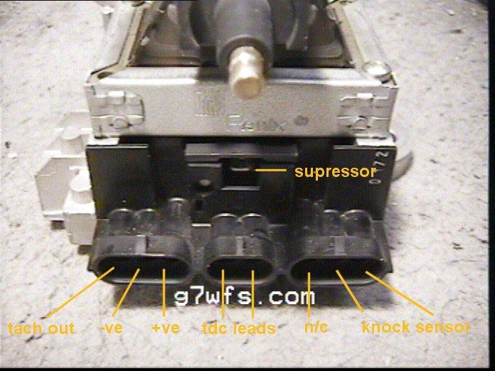

    213
    Couple of of weird connectors
    Maybe people who have R11 Turbo / R5 GTT might know what these are...????
    I arrowed all things that are not clear for me and I would like know too, what those wires in connectors are.
    Also...where I should connect that hose and copper pipe?

    The first pic looks like your oil return pipe from the turbo.
    Re: Couple of of weird connectors
    Starting at the first picture on the Left Hand Side:
    1) That pipe on the bottom left hand corner is the oil feed return to the sump. You should have a short 90 degree bend in a hose which you can connect onto this & then onto the sump. I'm pretty sure if you look north of your little red arrow you can see the end of the sump connector.
    I'm not sure about the pipe on the top right of the picture.
    2) Gearbox speedo sensor. Needs to go in the hole in your gearbox to give your dash something to read.
    3) Knock Sensor Connector that goes to the Distributor Side of the head.
    4) The three connectors to the AEI unit.

    Ok... Then more questions:
    1) Ok....that is clear now
    2) where I should connect or place it? Any idea?
    3)...again...where I should connect it?
    4) I would like to know wires...I have omex clubman rev.limiter (with launch switch), Greddy Profec B-Spec 2 boost controller and I need some of those wires in a picture to connect "extra devices" right way ?

    Quote Originally Posted by Theros View Post
    https://www.rtoc.org/files/Technical%.../Scoff/aei.jpg
