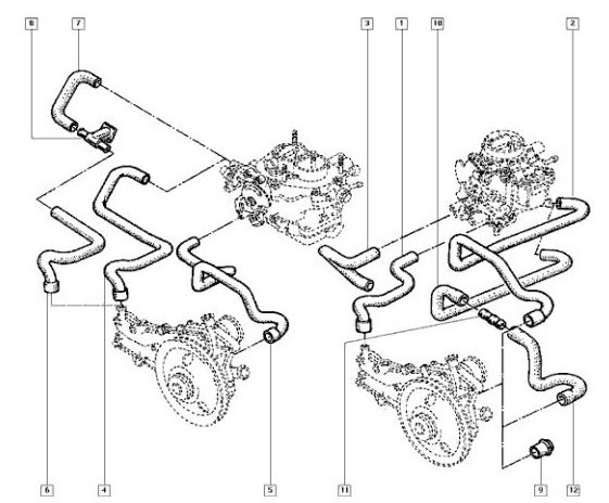

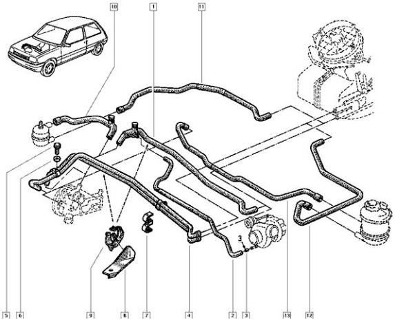

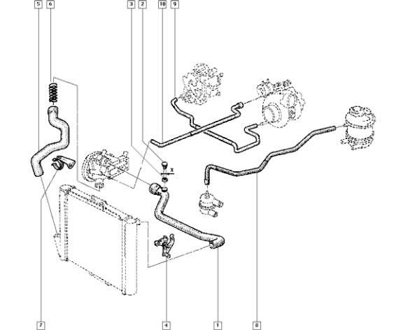

    Hoses & where they go
    Taken from the old site.

    R5 gtt Engine hoses Dialogys
    R5 GTT phase 2 Engine hoses
    ALL PRICES BEFORE VAT AT 09/09/2008
    LOWER RAD HOSE ----------------- 6001006590 £22.25
    UPPER RAD HOSE ------------------ 6001006589 £45.45
    EXP TANK TO TOP OF SWIRL -------6001021089 £30.70
    W/PUMP TO TOP OF TURBO -------- 6001021212 £52.62
    CARB TO BOTTOM OF TURBO ------ 6001008157 £**.**
    PUMP TO SWIRL POT ------------- -6001021088 £30.70
    SWIRL POT TO MATRIX ------------ 7700803837 £48.24
    EXP TO MATRIX ------------------- 60010090610 £**.**
    PUMP TO EXP ----------------------6001021090 £30.70
    PUMP TO CARB ---------------------6001007413 £14.60
