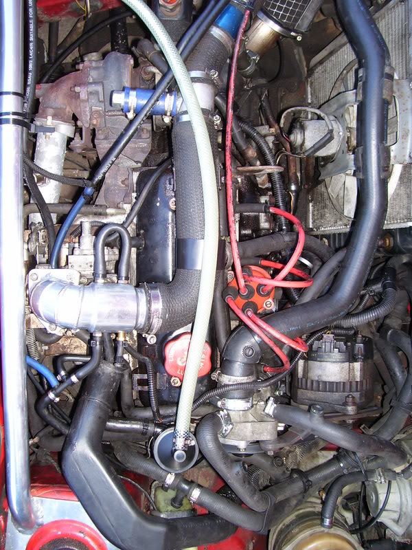

    Best I got attached Raj.
    Christ. Makes you want to pull ya plonker dont it.

    Re: relocate swirlpot
    where does the top header tank hose go to.?
    Looks like it joins the top rad hose.
    where does the bottom header tank hose go to.?
    Im guessing as per phase 2, the heater matrix
    where does the 2 water pump hoses go to.?
    One to heater matrix. The other to the back of the inlet manifold?
    Orange, just for you.

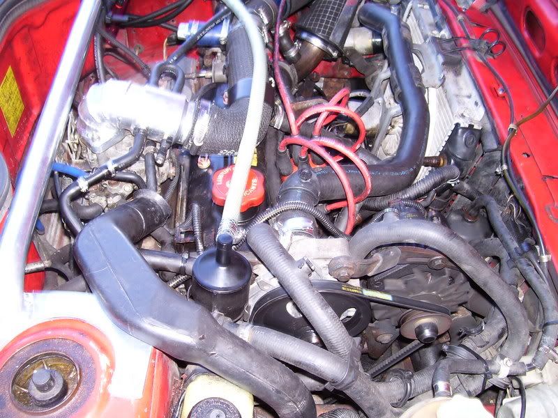

    Raj, here is my ph1 setup
    The top header tank hose goes to the turbo top outlet
    The lower header tank hose goes into the side of the waterpump, then onto the carb base front outlet
    Both the waterpump top outlets go directly to the heater matrix
    https://www.rtoc.org/boards/album.php...&pictureid=463

    ok finally i think im getting it but is there not another way to pipe the header tank to turbo hose? ive not seen header direct to turbo before!
    as my header tank is behind the scuttle it would look daft routing long pipe fro the opposire side of the engine bay.
    have i got this pic right ?
    Actually, that doesn't look far off mate.
    The Ph1 header tanks are still available, I bought one about 8 weeks ago. I wouldn't wait for long if I were you though. I might still have my old one which you could have, though it's tainted on the inside (hence its replacement)... I'd have to check.
    To get this right you really need the Ph1 hoses. I don't think they are available new anymore though
