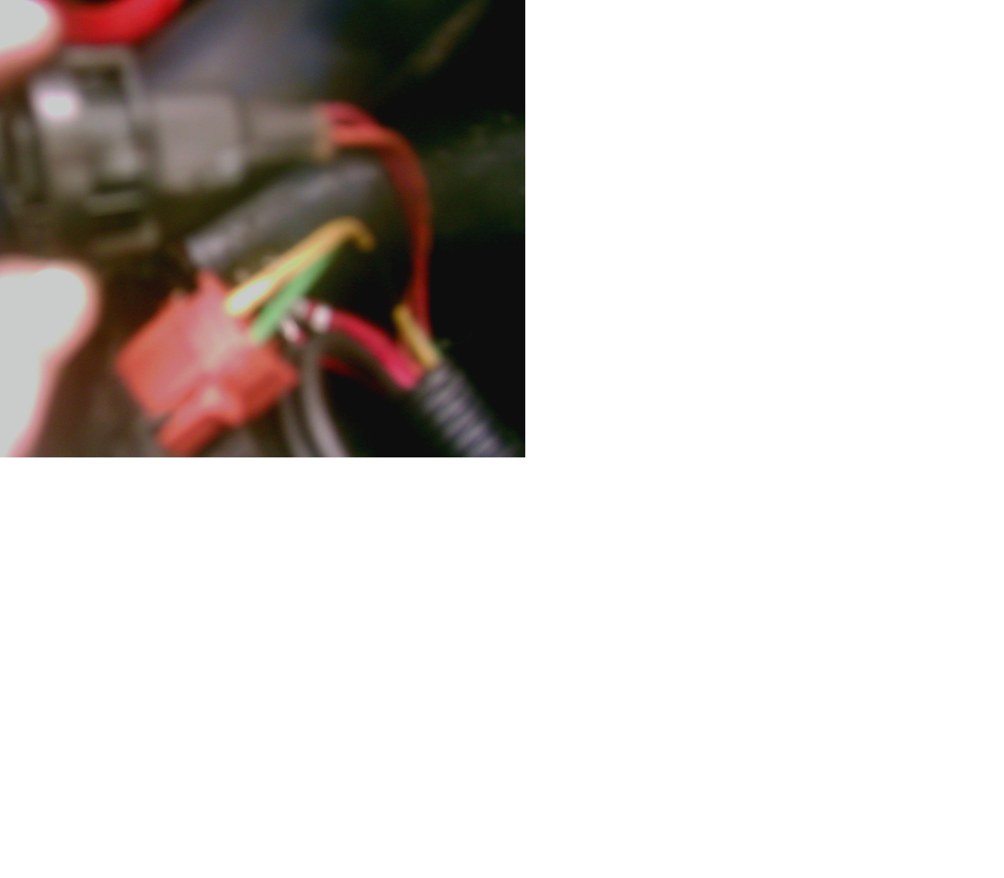

    4- Start with the starter motor. Best way to reach it is put your arm down and round the back of the turbo and under the manifolds and you will feel it. There are three connections. 2 big ones on the same nut and one small plastic connection. Pull the small one out and unbolt the other with a small 13 mm spanner. Once off pull the two wires back to the main connection next to water tank. Make sure you pick the right connection on the new loom (thick red wire with metal L shaped bracket at the end and small white wire with a standard connection) replace with your new ones making sure you attach the third connection back in which will just be dangling and is connected direct to battery. Don’t forget.
    5- Next up is the gearbox reverse light switch which is accessible by moving the header tank forward and feeling down at the wheel side of gear box. Once found push down on the top and bottom of the connection and pull it out, replace with the new one. The loom will have two of these connections that look like an oval with two holes and there is plastic brace around it. (The other is for the fan switch)

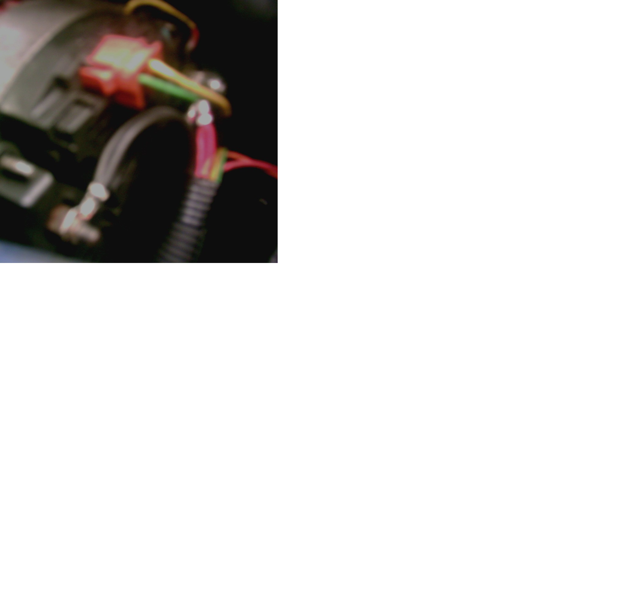

    6- After the gearbox is done then attach the new main connector block and start to run the loom along the oil return pipe then up to the alternator. (I used cable wires to hold it in place) Attach the alternator connections which are two black ring connections and one red one. You also have the alternator top clip which is a simple swap, leaving you with the fan switch connection, relay and main fan connections to connect.

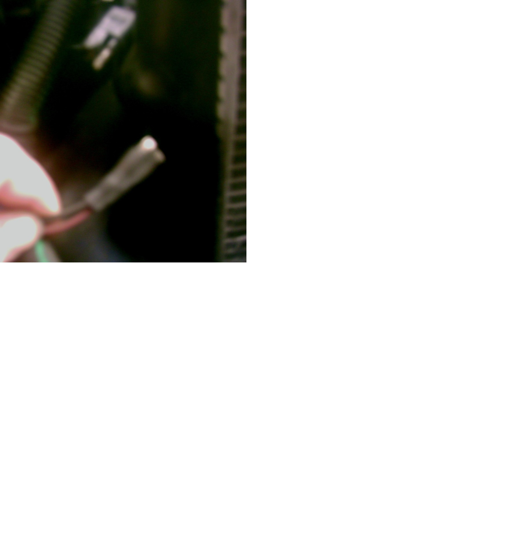

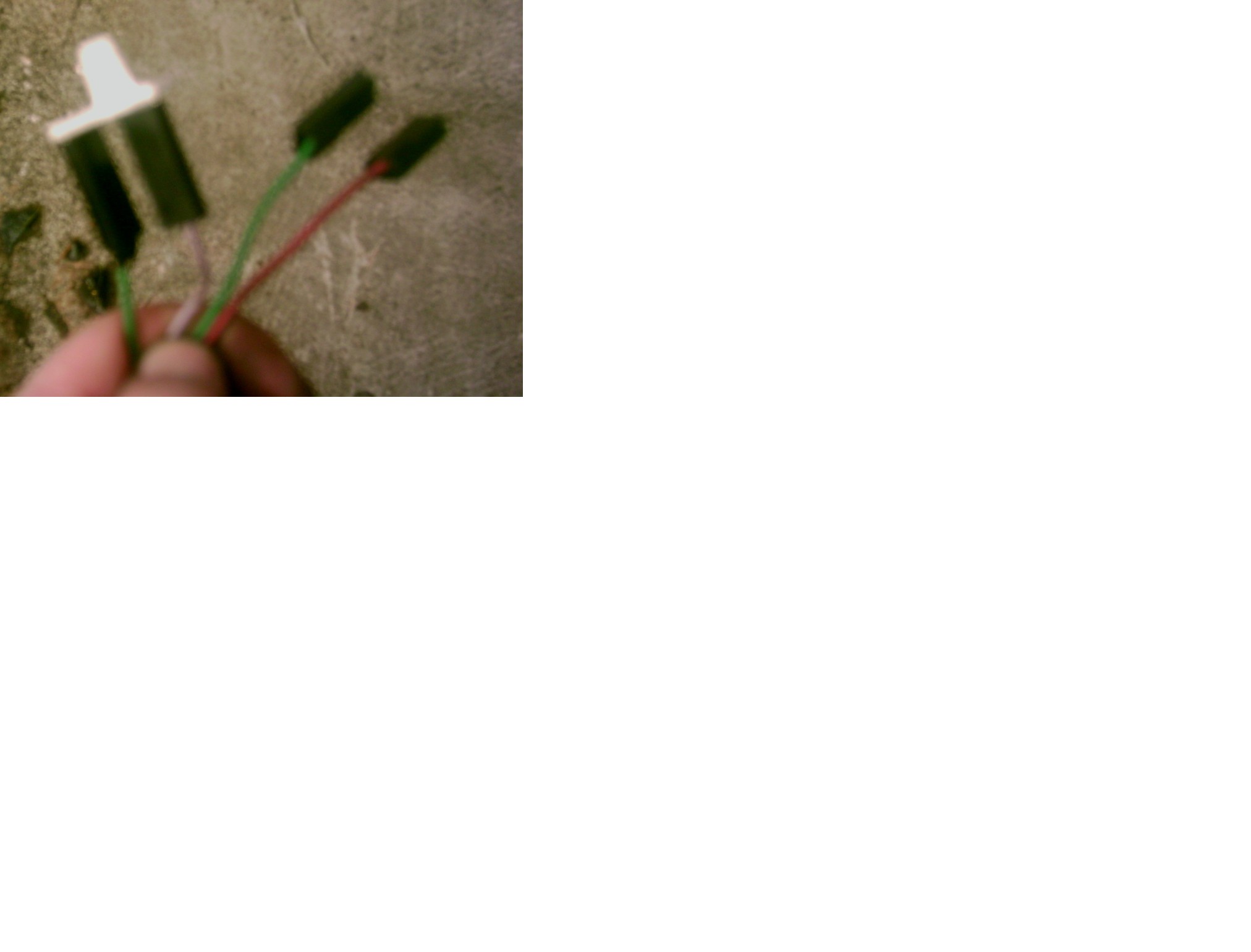

    7- For some reason Renault have decided that just to annoy people the fan switch connector comes with small pin holes instead of the larger pins that some peeps have on there sensor. Rather than cut your new loom you can get the smaller pin version from bb tuning (low temp) but its up to you. Otherwise cut the wires and crimp two larger female spade connections on) I will not even waste my time telling you how to change a relay but the main connections for the fan come with far to much rubber on them so need to be trimmed and even then it’s a tight squeeze to get them together.
    8- Once you have done all the fan and alternator wires its time to connect the oil level sensor, oil pressure sender and the earth wire. Simple stuff, best to get the oil level sensor from under the car as it on the bottom of the stump. If you get mixed up the oil pressure wires have separate connectors and the oil level wires is a block connection. The earth wire is a simple swap is should be on a bolt on the front of the block. Just swap it over making sure its clean and free from any paint or rust. If in doubt sand it down or if you can’t get the bolt off use another.

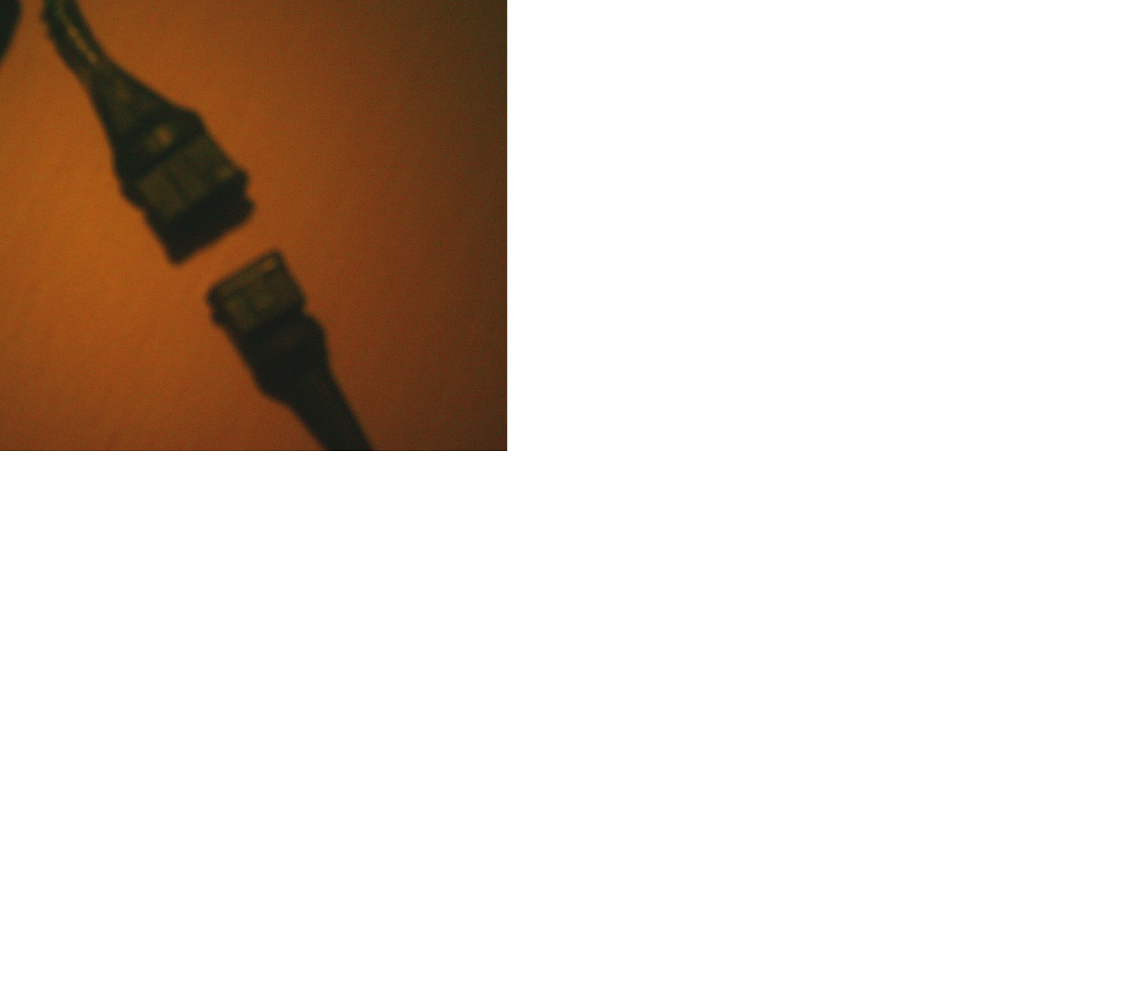

    9- If you have done the job correctly you should be left with the solenoid connector, the anti perc fan connector plus relay and a set of connections for the over boost sensor and heat shield sensor. The it’s easy to work out what goes were. The solenoid and the anti perc fan have similar connections, but the solenoid is bigger so plug that in. (for those who don’t know the solenoid is a oval metal contraption on the bulk head which has two hoses coming out of it) as for the other connections the one which is longer stretches to the smaller boost hose (turbo to intercooler) and the other goes into your heat shield. After that plug in your anti percolation fan switch and relay and it’s sorted.

    Alternator Connections
    Anti perc fan and solenoid connectors
    Fan connections
    Fan switch
    Overboost and heat sensors
