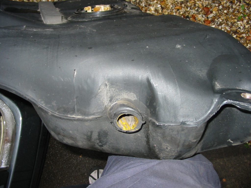

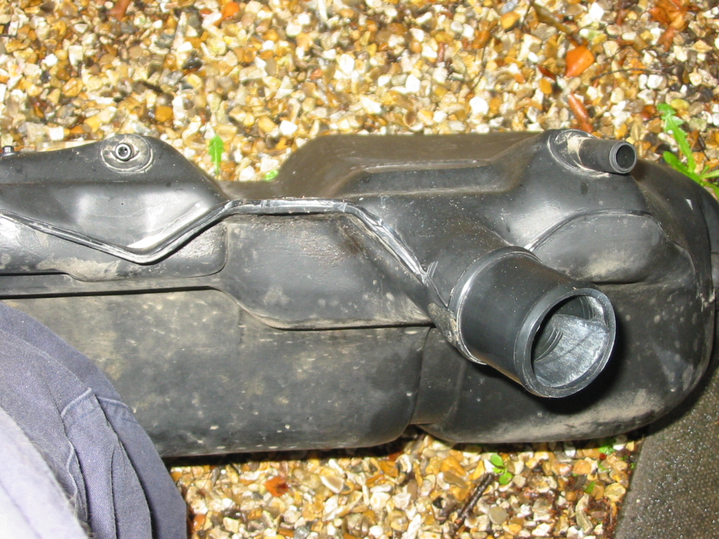

Is your car smelling of petrol? Has your fuel consumption got out of control? Either you need a lighter pair of boots or your petrol tank is leaking. If you have a look under the car at the drivers side rear wheel you can see the petrol tank and what would appear to be the tank seeping petrol from a yellow bung.

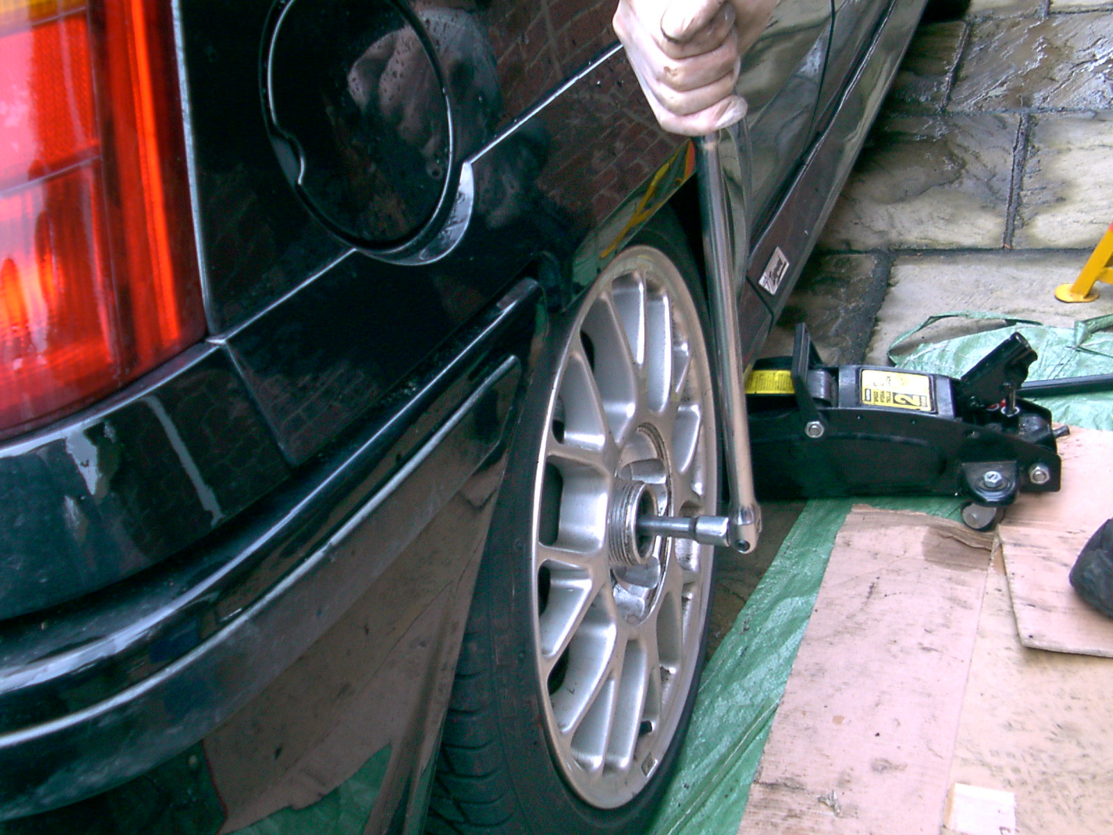

Before I started, I thought this job was going to be a lot harder than it actually was. As you are working under the car I would suggest that you jack your car up as far as you feel safe. There will not be a lot of room for you especially when it comes to getting the tank back on the car. I managed to get mine up about a foot (second hole on the axle stands) at the rear beam, which gave a decent amount of room to work.

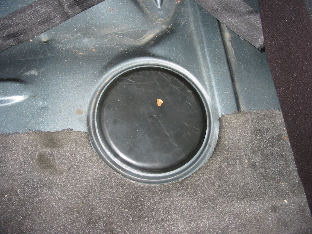

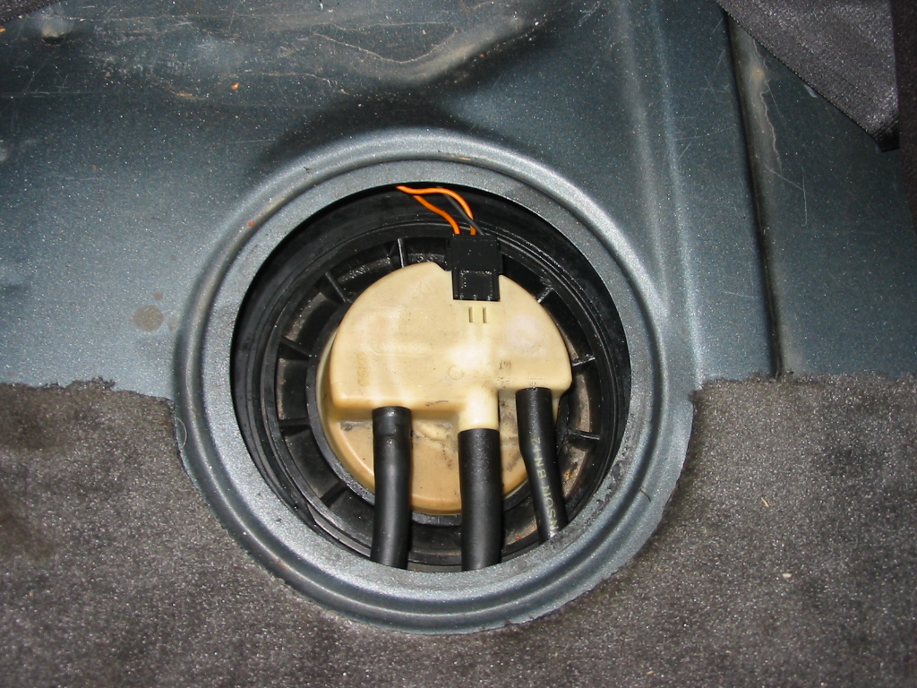

Go inside the car and flip up and remove the rear driver’s side lower seat. Underneath will be a black plastic cover over the fuel sender unit. There are three hoses on the front of the unit and an electrical block on the rear. Unclip the electrical block off the unit and either tape it or put something heavy on it so it does not disappear under the car. Also remove the three pipes off the unit. I cable tied them together in the order they came off in, with a screwdriver in the middle hose so they also did not escape under the car. For your information the middle hose goes down from the sender unit to the fuel pump.

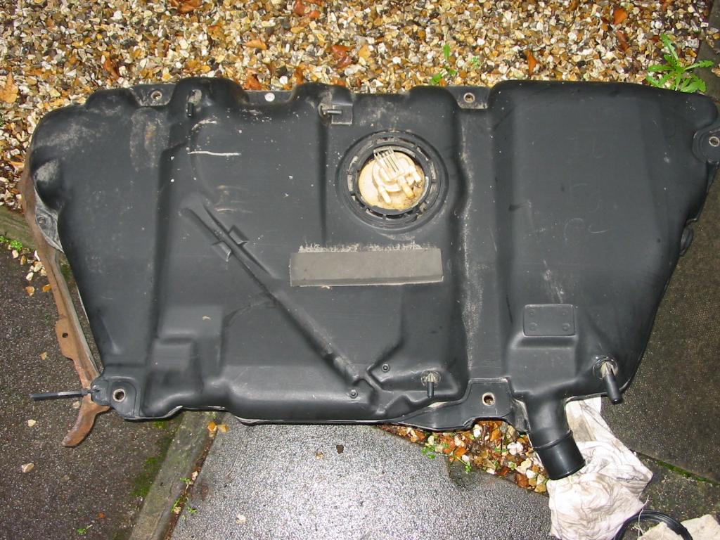

Now for the main part of the job, you will see the petrol tank is held on the car by five 13mm bolts. Two are under the rear beam, which can be quite awkward to get to. You can get a short socket or spanner on there but movement to undo these is limited by the brake lines on the driver’s side and the rear brake compensator on the passenger side. A good tip would be to get your trolley jack and a piece of wood under the tank to support it while you take the bolts out. When you lower the tank slide the connecting hose off the auxiliary fuel tank after removing the jubilee clip on the hose. Be aware that the strap that holds the auxiliary fuel tank in place may well be corroded and fall to pieces when you start trying to move the hose off of the main tank. I would recommend loosening the strap or taking it off to save it falling apart completely. The strap is held on by a 13mm nut, which is up inside the rear arch.

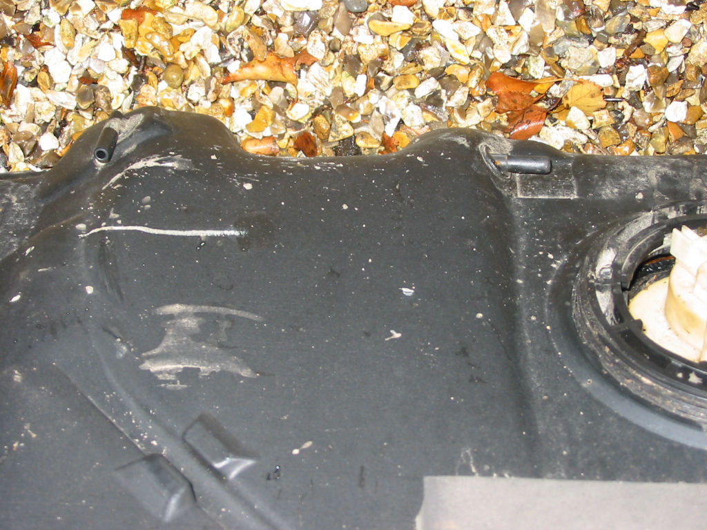

When you lower the tank, be aware that there are four vent pipes on the top (car) side of the fuel tank. Two are at the rear of the tank: one larger vent pipe which connects just above the connecting hose, and one small vent pipe which connects up on the middle of the tank. There are two more on the sender unit end of the tank. There is one long one, which runs the width of the tank from the aux tank. The other vent pipe runs from the sender unit to the passenger side of the sender unit. Most of the pipes are easy to remove as you lower the tank onto the floor the weight of the tank will pull them off.

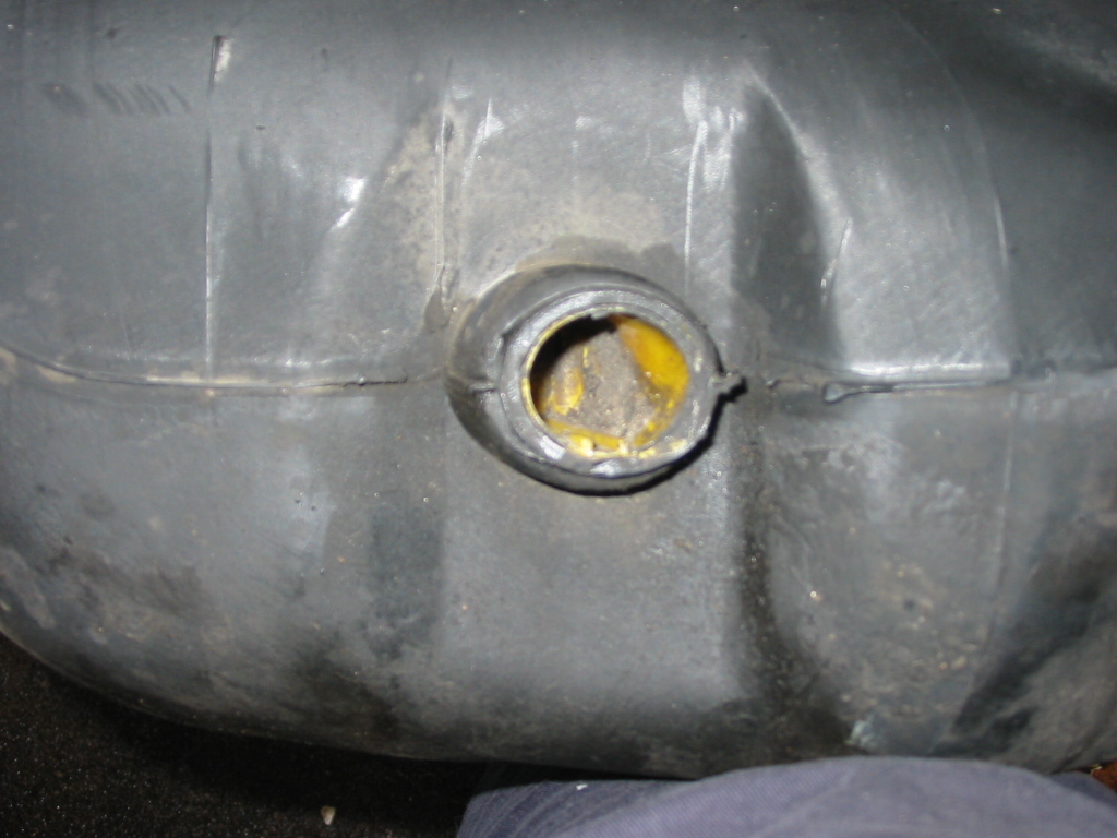

Now you have the tank off you can either get it ready to repair it or get your spare tank to fit on in place. If you are fixing your tank I was advised (thanks Duncs!) to solder the yellow bung around the edges so it seals in place, and then cover the area in Araldite. I cleaned the area as best I could then, using the 'Woolworths special' 30 Watt soldering iron with about 1-2mm small pointed tip, melted the edge of the bung and the edge of the tank together until they were smooth. I used a circular movement around the inside of the bung at an angle so to smooth the two edges together. The edge of the tank is fairly thick so you'd be unlikely to melt all the way through. After mixing the Araldite together it was easy to spread it over the area to form a seal.

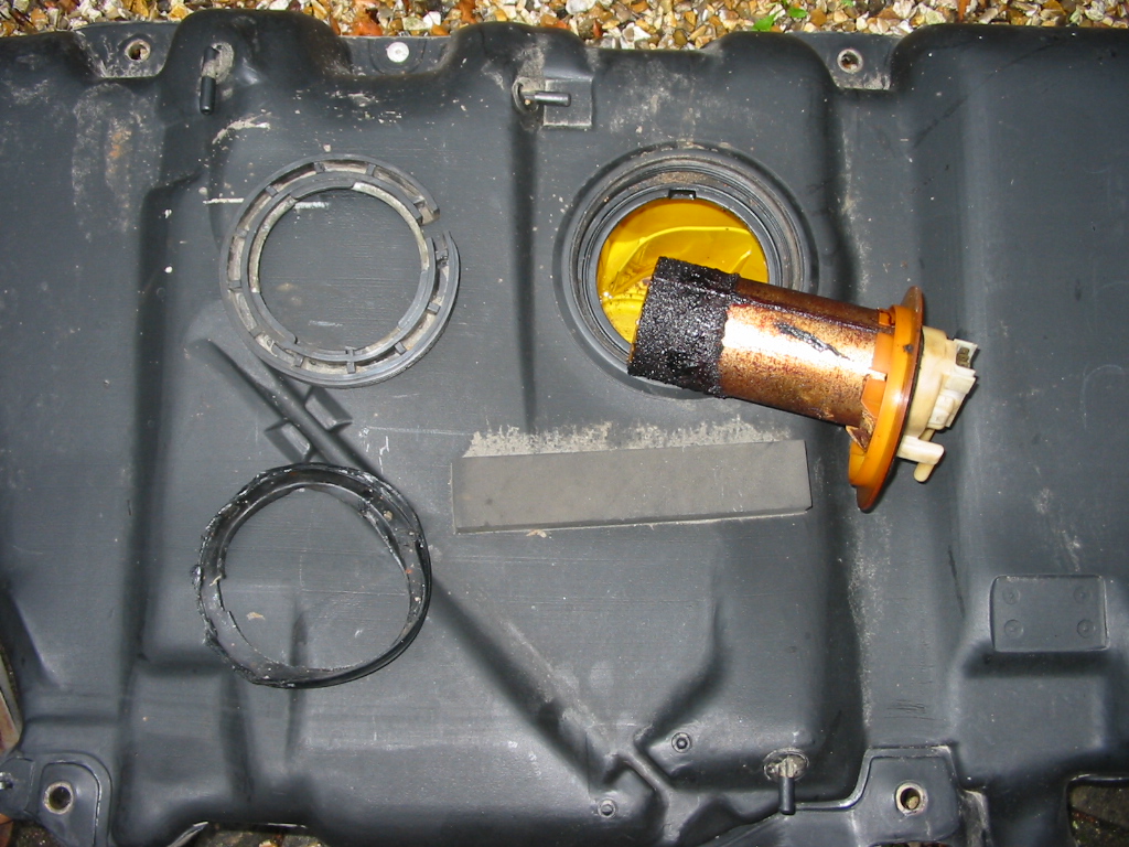

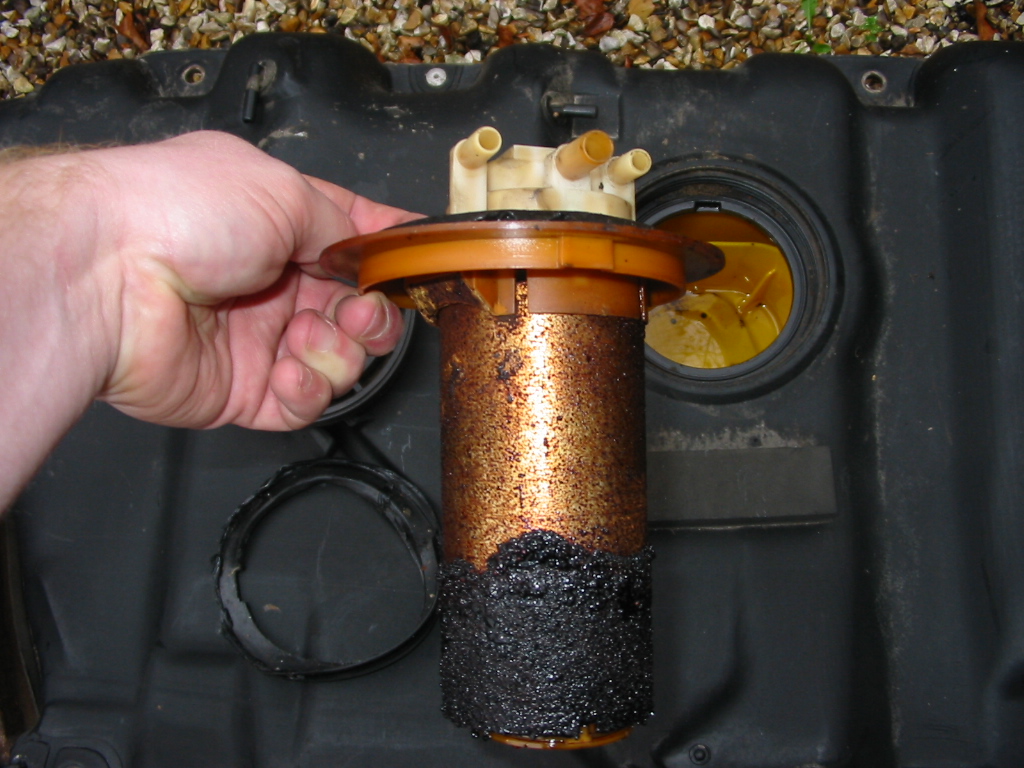

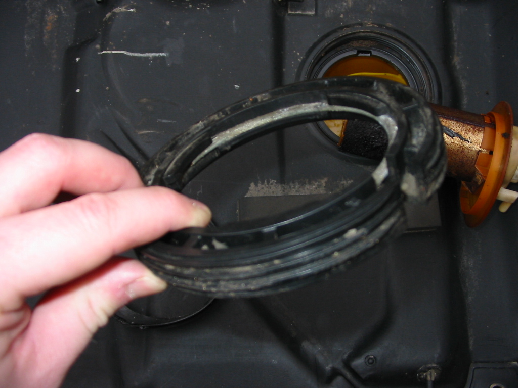

If you have a spare tank and unit, then swap the sender units over to see if it is the unit that is faulty or use a voltmeter to see if the unit is live. To swap the unit get a screwdriver and a hammer and you will see a large black nut, which you need to loosen by tapping gently on the end of the screwdriver in one of the sections of the nut. Take your time and not be too hasty, as you don’t want to ruin the nut. With the nut off raise the unit out of the tank bringing the seal with it. This maybe perished and need replacing (part numbers can be searched for on the site.) The seal has a notch in it, which corresponds to a lug on the sender unit. Put the seal on the unit before you put the unit in the tank – it makes locating the unit a lot easier. Replace or refit the unit and go for a drive to the local petrol station.

Do you have the leak out of the little yellow area of flashing on the offside of the tank? If so, before you get drastic, you might want to try this:
I went to Halfords and invested in some pikey instant metal/ rad fix/ fuel tank leak putty stuff (it's about £2). I then put the back of the car up on axle stands and undid the three accessible bolts on the leaking side of the tank. That gives you about 4 inches of play in the tank to work with. Then, knead your putty (all of it) together, and pull down on the tank a little. Simply jab all of your pikey putty in the little hole, and press it right in there.
Do up the three bolts.
Enjoy your leak free tank. Mine has lasted more than a year like this now.
And Alex of Chester
I'd try the putty to start with as its the cheapest option, if it doesnt work take the tank off and take it to have it repaired by a radiator/tank specialist. Thats what I did when mine leaked. They simply cut the outlet off (bit with the yellow bung in) and welded a plastic plate over it.

Rear of car jacked up
The bung
The bung
Sender unit cover under rear seat
Sender unit in place under the rear seat
Sender unit nut
Sender unit removed. It's supposed to be clean and shiny!! And note in this tank that it's a baffled one. The yellow piece down the hole the sender unit was in.
Yuk!! What is all that stuff on there!!
Petrol tank
Top vents
Rear vents
