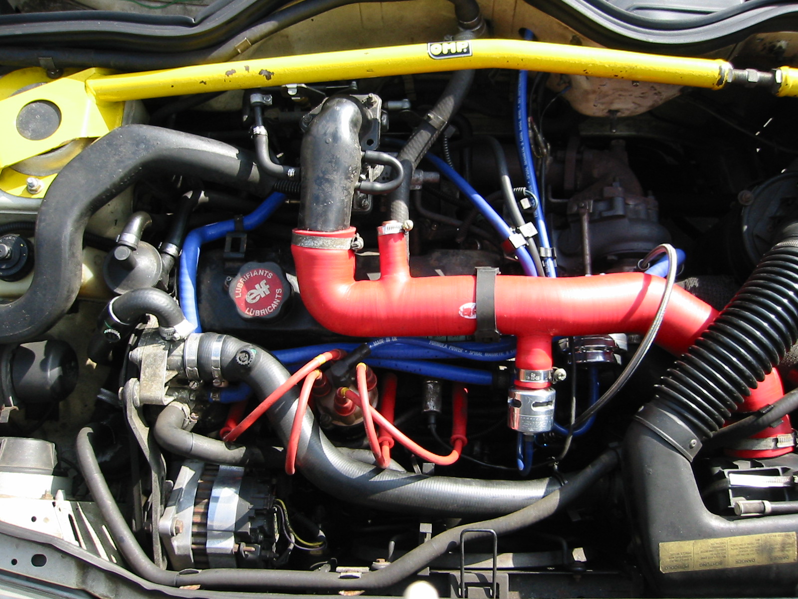

Strut brace. Even a cheap one helped to stabilise my car under hard cornering into tight 90° corners. Instead of skipping the car just lent over, sat and went around. Even under much lighter bends over bumps the steering and wheels and car felt more together.

Hybrid turbo and increased boost. Obviously a good mod. But which turbo. I had a T2 with a bigger T25 comp wheel and housing bored to take it. Was a good improvement at full 15psi(manifold). Less so off or at very low boost. But no downside. Did spin up a bit better / make boost a bit sooner than the original T2 on same PSI and car accelerated better at full throttle / boost / revs.
