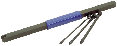

Here's a photo of the tool to remove some of the door pins.
DRAPER CAR DOOR PIN REMOVAL KIT Stock No: 54585
- For the removal of hollow hinge pins
- Contents: One square handle with chemically blacked finish and three pins manufactured from chrome vanadium steel with chemically blacked finish
- Pins are a consumable item, available separately, in sizes:
- 5.5mm O.D. x 3.5mm I.D.
- 6.5mm O.D. x 4.5mm I.D.
- 7.5mm O.D. x 5.5mm I.D.
The Draper Car Door Pin Removal Kit appears on page 65 of the current Draper Tools catalogue.

Apparently they are soft weak metal and bend to bits. There is an RTOC thread on this.
The original ones are 7mm but but in dialogys they list an 8mm one under bolts and stuff which they had in stock in Dec 2006.
