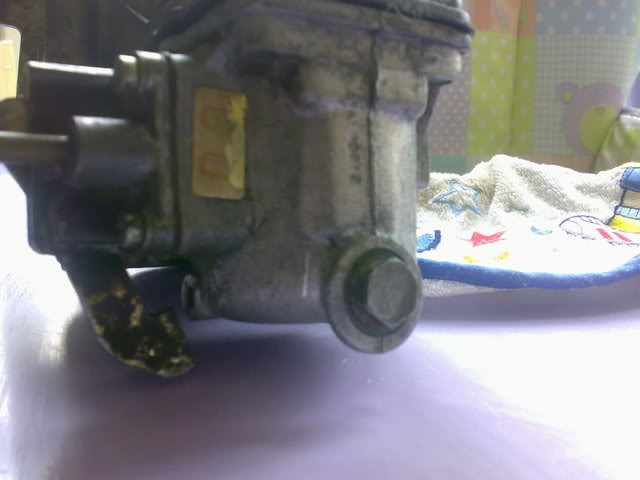

    This jet is located at the bottom of the carb & is accessable via a 12mm nut.
    **NOTE** When you undo the nut for the main jet have a bowl ready or do it outside as there will be a fair bit of fuel inside.
    Undo the nut & put it somewhere safe,don't loose the washer,replace the washer if possible as if its old it may leak when you tighten it back up,it's just a copper washer so any motor factors will have one.
    The main jet is accessable with a long handled screwdriver,if you look into the hole where the bolt was you will see the main jet.
    Unscrew it & Tip the carb on its side & give it a shake till the main jet comes out.The one in the picture has been sodered & re-drilled.

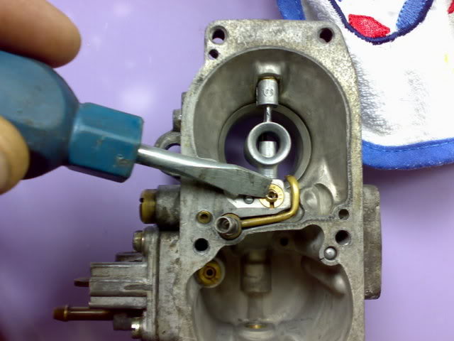

    On the top of the carb you will see 6 screws,undo these & remove the carb top,inside you will see a small brass bush with a slot in the top,this is the a/c jet & as standard is 1.25mm,you can either buy a new,smaller one or solder it up & re-drill it,this is a very fiddly process & you don't need alot of solder in it so don't over do it!!
    :!: To remove it carefully unscrew it,try not to mash the top if its a bit tight!!
    :!: Also don't drop it down into the carb if you still have it on the car!!
    Drill the jet to 0.9/1.0/1.1 etc. you get the idea,this is where a roling road or decent wideband controller would be very handy as you can check the fueling after every change to get the optimum out of the carb!!
    When you refit the a/c jet,don't drop it into the carb venturi if you still have the cab on the car :!:

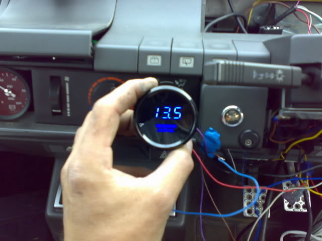

    Now for this part we need a wideband controller* really as we can use smaller main jets & the fuel must be check properly,no 2nd guessing here i'm afarid.You also deffo need a carb overhaul kit as we will be stripping most of the carb down to reach the jet/bush.**Also worth noting that this is a FIXED bush so once drilled it cannot be fixed with solder,you can drill it out & tap a thread small enough for the a/c size jet to fit but this is very fiddly & you will get alot more swarf in the carb.

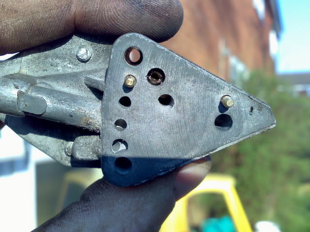

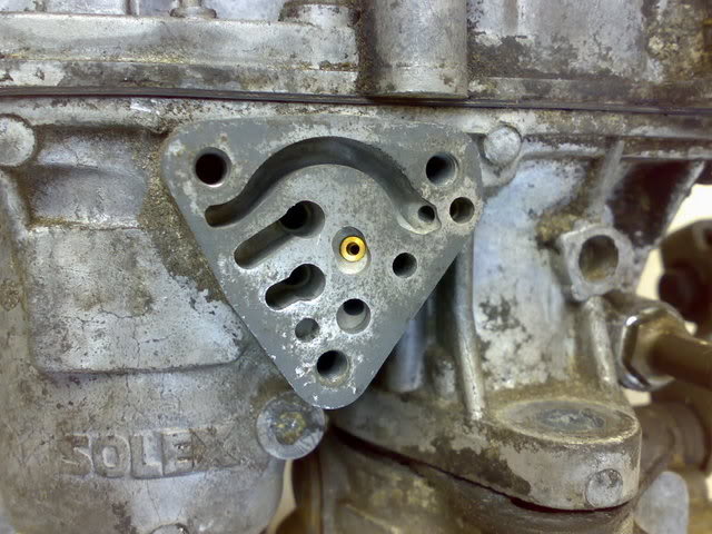

    The bush is located in the side of the carb with the triangle shaped part,undo the 3 screws holding this in place.

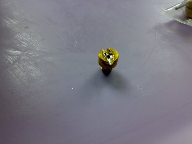

    Inside the part that comes away from the body is the 1st stage & is the same as the a/c jet except this is 1.0mm instead of 1.25,(some Group A carbs have the 2 jets swapped over, not ideal really.) Leave the 1st stage alone for now.
    Here you can just see the 1st stage jet.
    The 2nd stage is located in the carb body,its a small brass bush & is normally around 1.0mm,with the aid of the wideband controller you can enlarge this to suit your 'on boost' conditions without having such a large main jet,thus improving 'off boost' fueling/economy.
    Start with 1.1,drill this slowly & carefully,this way you won't get too much of the swarf going into the carb,give it a good blast with some carb cleaner after to get most of the smaller bits out,you may have to take the carb off a couple of times & clean it to get it all out,or if you're carefull enough the carb cleaner will do the job.
    2nd stage (fixed bush)

    Test it on the road with the wideband,idle you want high 14's (some cams may want to idle in the high 13's) , light throttle you want 13's really, same as boost starts to come on & as it rises the afr's should drop,at WOT in 4th/5th you want to see 11.9 to 12.5,certainly no higher & 12.1-12.4 are best on most engines for making power.
    Do the test in lower gears 1st (2/3rd)just to check the afr's as there's no point thrashing it on afr's of 14's on full boost,this will damage the engine.
    Then you need to test in 4th gear to the max RPMS you are going to rev to, my car was fine up untill 6k in 4th , then it would lean out, i revved it to 7k on the strip... I ended up with a 2mm needle to help fuel, but alas it still wasn't enough for 24 psi..Anyway...

    * A Wideband controller is a Wideband lambda sensor you have to fit in the exhaust,usually about 6 inches or so from the turbo at a 2 or 10 o'clock position,this then sends the data to my lc-1 controller then to a display so you can read it,can also be attached to a laptop. NOT to be confused with cheap NARROWBAND AFR gauges, they are NOT the same.
    My Wideband display
