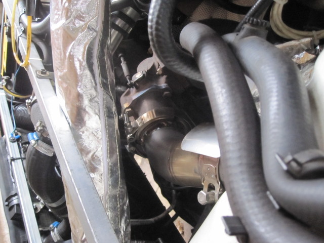

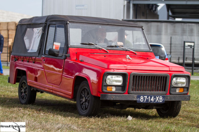

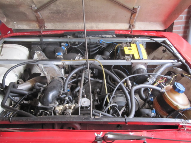

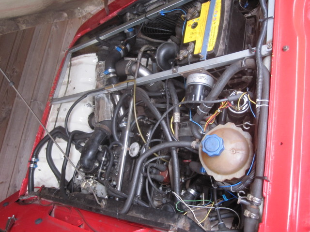

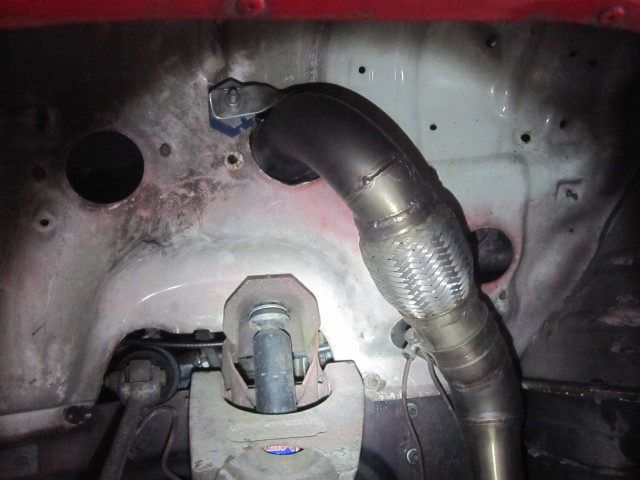

    Pics, at your service:
    Re: TDC adjustment angle
    Hahaha, what a super cool thing. C1J install looks "mad scientist", brilliant.
    I know nothing of the Rodeo. What was the engine that came out of it? And what impact on performance and character does the C1J have?

    The Renault Rodeo has the chassis of the Renault 4. The suspension is of the van version (fourgonette). The original engine was of the Renault 6 with 47 HP. Now I drive with 120 HP and 200 NM at 3000 Rpm.
