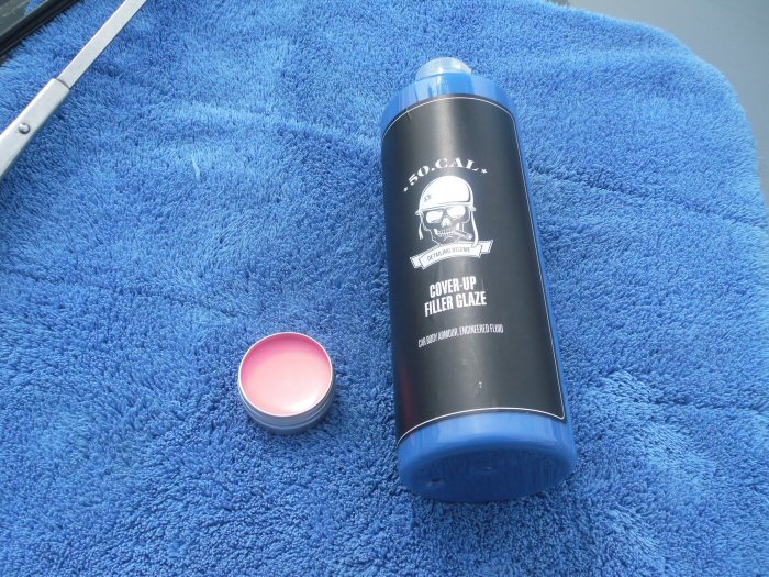

    What Is It?
    50 Cal Detailing Cover Up Filler Glaze
    What Does It Bring to the Table?
    A brand new easy to use Filler Glaze that allows amateurs to paint correct!
    What Do I Think Of It?
    When I first heard of this product and did my initial research I was at once
    pleased, but not a little skeptical. It's my belief that presently, after all the
    hype that surrounded another similar product that's no longer available, there
    is a bit of a gap in the market. The very short, but very complete, by-line to
    describe the product shown above does set the bar quite high. So, with that
    kind of initial build-up, does the product match its billing?
    In a word, yes! Though the initial start with this was not uneventful. Despite
    it seeming to need some effort to buff off, I was determined to give it a fair
    crack of the whip. I'm jolly glad I did, because the results can be very good
    indeed!

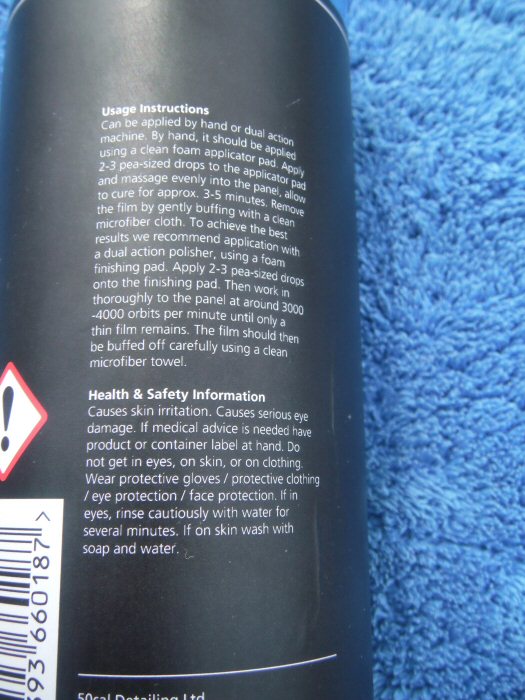

    However, before I get on to describing this glaze in use, I need to say a few
    words about what's printed on the side of the bottle. In print of very tiny
    proportions there are some pretty vital instructions, particularly with regard
    to protecting your hands. This is not a product to go fast and loose with and
    not take any notice of the precautions you should take beforehand. Just how
    many people will take the time to read that tiny font is open to question...
    Personal Safety Note
    Having now completed a car over several days, I do want to point out a
    safety issue. The words "causes skin irritation" on the label are clear and
    unequivocal. I would strongly suggest that you thoroughly wash your hands
    after removing your protective gloves. The irritation isn't serious, but it isn't
    comfortable either. The effect is that your skin feels exceptionally dry. As a
    guy with gammy hands anyway, I can only implore you to look after yours.

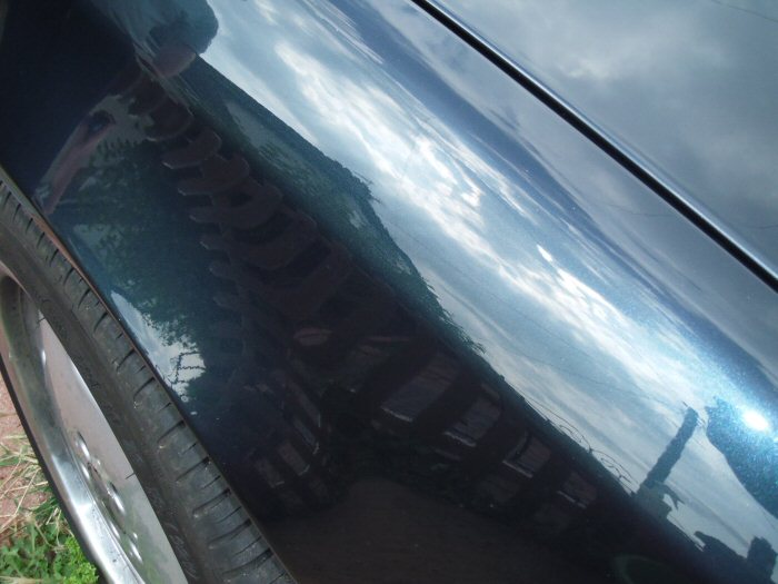

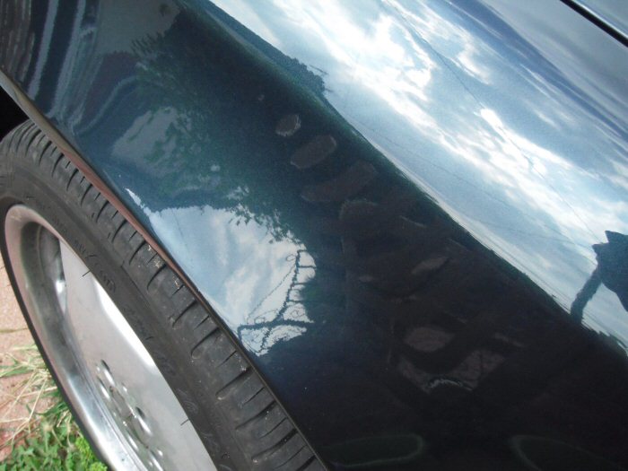

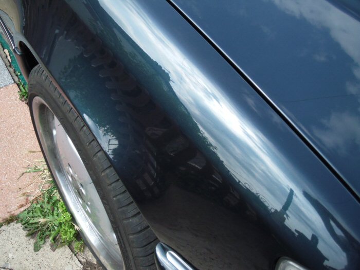

    The second car to get treated was a rather nice Merc coupé. The owner of
    this car usually has it dealt with professionally, but I think I may have made
    it look far too easy at shows we've taken our cars to. We were at a big show
    in Helmingham and I got a cry for help with water-spotting.
    This wasn't intended as a test mule today, but I couldn't resist asking if it
    was OK to have a go. There isn't much swirling on this car, but the green
    tinge to this paint made it far too tempting to ignore. In the event, just the
    front wing was treated. These first 3 pictures are befores...

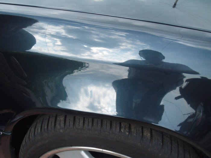

    Application of this glaze can be a little tricky if the surface is anything other
    than fairly cool. One way around that was to lightly prime a foam pad with
    some QD. Fairly predictably, I used some ONR Wash & Shine @ 32:1. About
    4 tiny drops of product were well massaged into the pad first.
    As for massaging into the paint, per the instructions, well, the working time
    didn't seem to be that long, even with the lubricant. Most modern products
    tend to work best when working on the less is more principle, so I resisted
    the urge to just keep topping-up the pad without nearly exhausting it first.

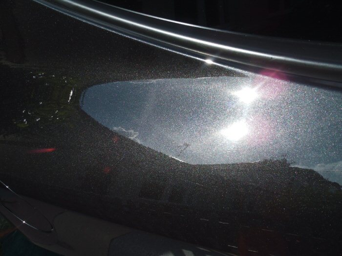

    Although the paint surface was by no means too warm, I was keeping a fairly
    good check on that, the product took no time at all to dry. So, I was able to
    do the buffing-off fairly soon after application. Unlike my first car with this,
    which still remains a mystery to me, there was very little effort needed. I'll
    let these next 4 pictures tell their own story...
    The white "marks" are actually flake-pop, not his water spotting

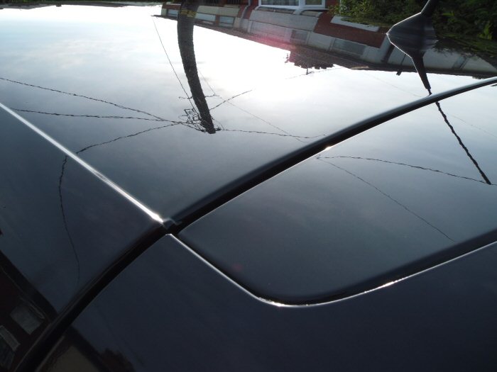

    The car that I really wanted to test this on is a neighbour's 2009 Mégane.
    The car has been left to the tender mercies of brillo pad wielding thugs. Well,
    that's what it looks like to any of us. The paint was as grubby and rough as
    they come, and detail preparation for this glaze and subsequent treatments
    will be the subject of a showroom posting in due course.
    Suffice to say the paint was washed and clay clothed. There was so much
    stuff still left on the paint that it was given a bit of a hand polish, then given
    a 2nd clay cloth treatment afterward. What I ensured with both of these cars
    is that application is on paint as clean as I can get it.
    These first two photographs are of this clean paint, with an attempt at
    picking up some of the swirling as the light would allow...
    Again, like with the Merc, I'll let the photos do the talking. When the Merc's
    owner came over to inspect progress, several favourable comments were to
    be heard. This from someone who's not too easily impressed and pretty clear
    about what, to him, is good, or not.
    While the finish wasn't entirely perfect, the effect was of a richer and maybe
    slightly darker paint than hitherto.

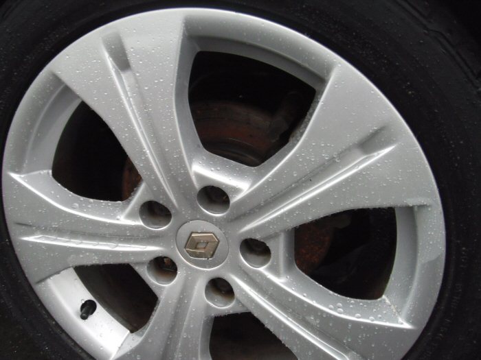

    • Pax side wheels: FK #1000p x2 on clean surface
    • Driver's side front wing & valance: FK #2685 Pink Wax
    • Driver's side door: Harly Wax
    • Driver's side rear wing: 50.cal Cover Up, untopped
    • Driver's side wheels: FK #1000p x2 over Cover Up

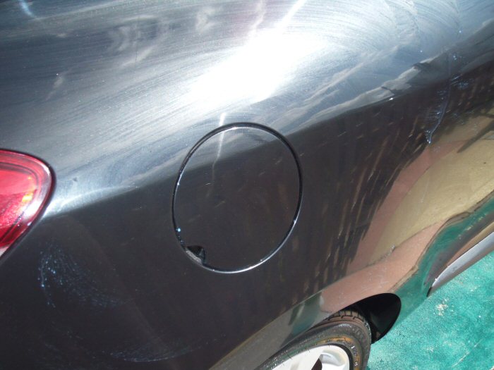

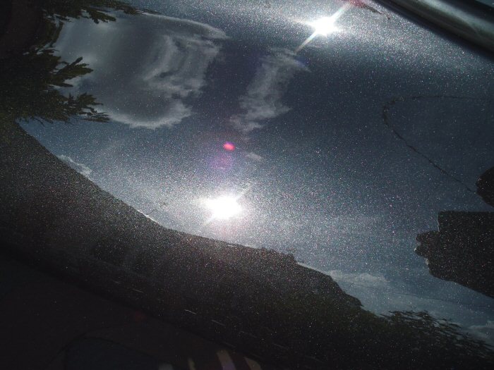

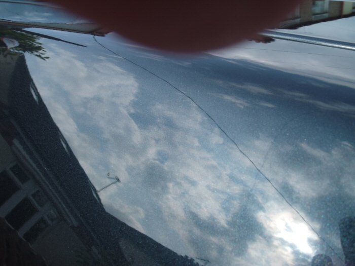

    Continuing with application of the Cover Up, I almost binned this next photo,
    in embarrassment!
    It wasn't until I looked at the next photo that I remember why I took it. I'm
    going to start with a question. How deep do you reckon those annoying swirls
    on your paint really are? To put it another way, can you picture their depth in
    your mind's eye?
    Take a good look at that picture. This was an attempt to try and keep my
    working area cool during the "Cover Up" application process. Almost a cheat
    if you like, but I was using some basic chemistry to my advantage. What I
    did was to spray the panel with some ONR at 32:1 and then very quickly work
    the glaze into the paint. The process of evaporation, delayed by the ONR,
    helped to keep the panel cooler than it should have been and allowed me to
    properly work the product in.

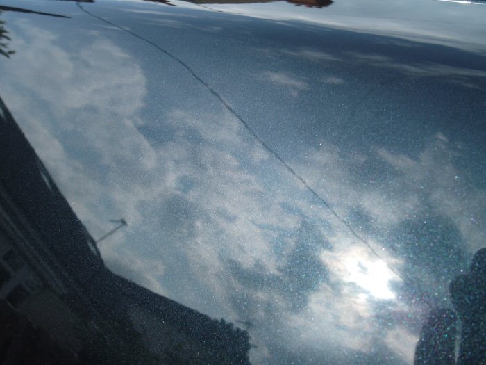

    If you've examined the photo, you'll see that only a very, very thin coat was

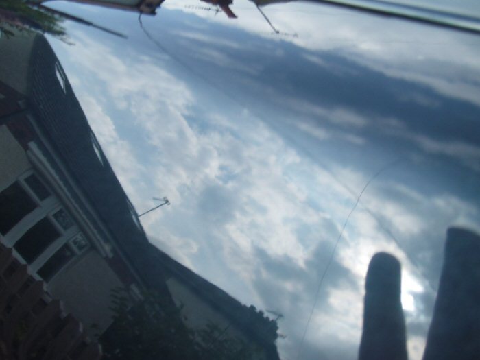

    actually applied. So, was it thick enough to work? Well, I'll let this next photo
    give you a clear answer...

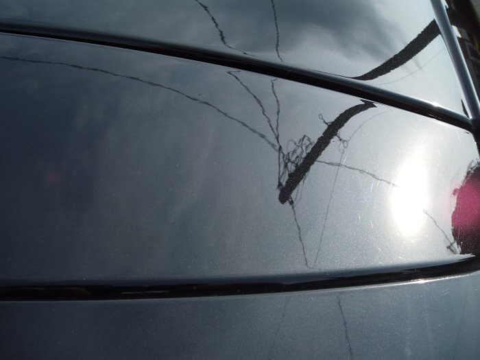

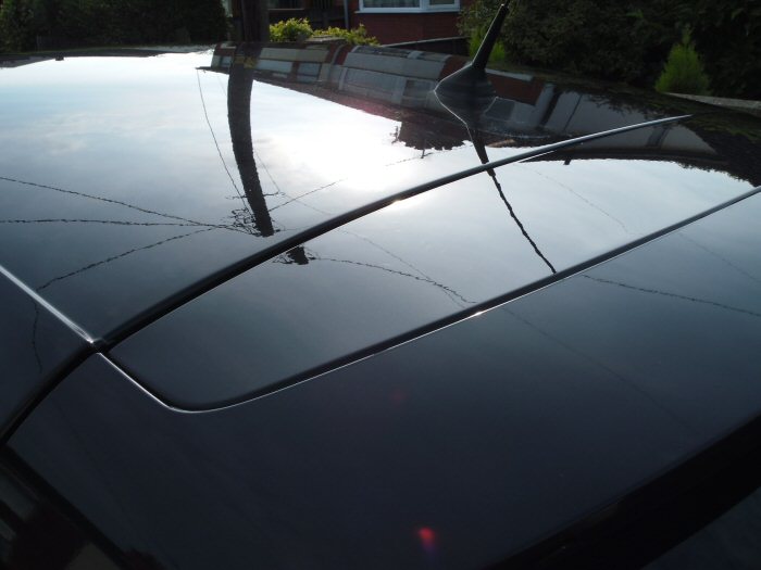

    So, that goes some way toward answering the questions I posed just now,
    doesn't it? I'm certainly happy with that result!
    ...as I am with this one.

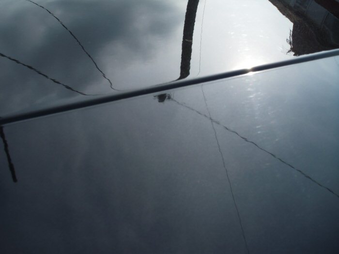

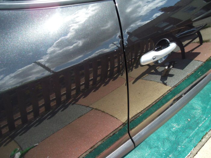

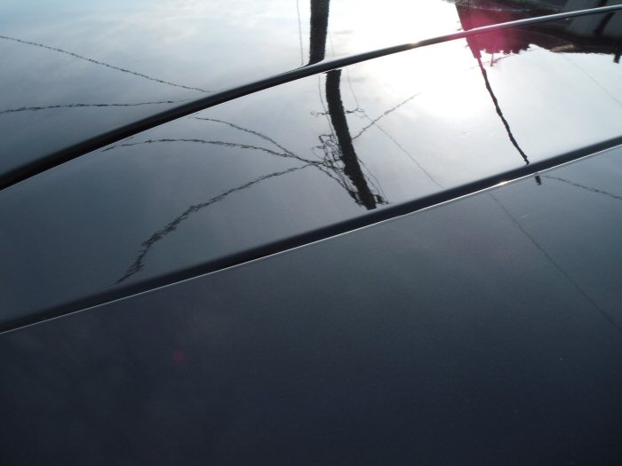

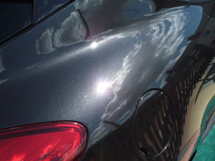

    Here's two final pictures where I've tried to convey just how good the finish
    can be. The glaze has now been topped with a wax...
    I should perhaps discuss the wax application on top of the glaze. Quite unlike
    other glazes that I've used, the 50.cal "Cover Up" finish was not at all slick to
    the finished touch. It certainly felt smooth, but I would describe it as being a
    product providing a good key to whatever is to follow. Certainly, there were
    no obvious bonding issues with the waxes that I applied.

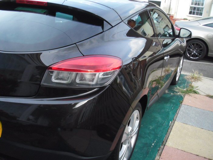

    At first glance, probably the finish that most impressed me was not any of
    my favourite waxes. It was the richness of the FK #1000p sealant on the
    bonnet! Considering that on its own that wax usually provides a bit of a
    sterile finish, that was indeed a surprise.
    One other thing that was quite evident with the glaze, which the FK #1000p
    probably brought out, was some darkening effect. Yeah, I know it's black
    paint, but the effect of giving the finish some depth and richness was there
    nevertheless. Anyway, on to some finished car pictures...

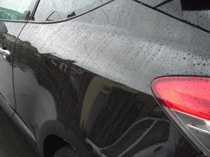

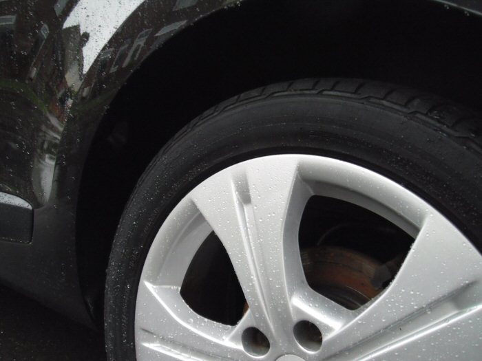

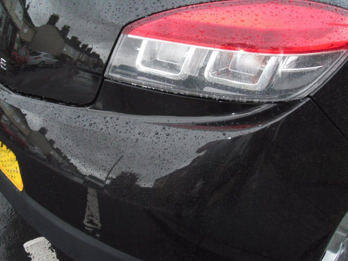

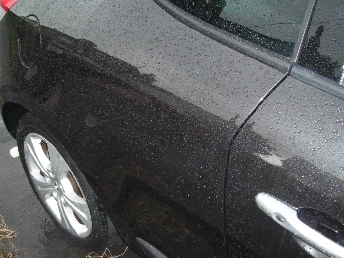

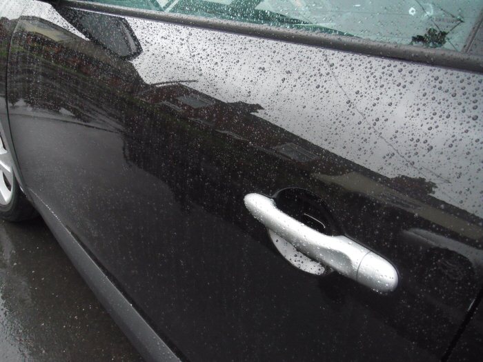

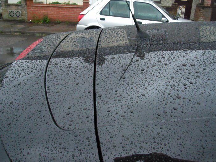

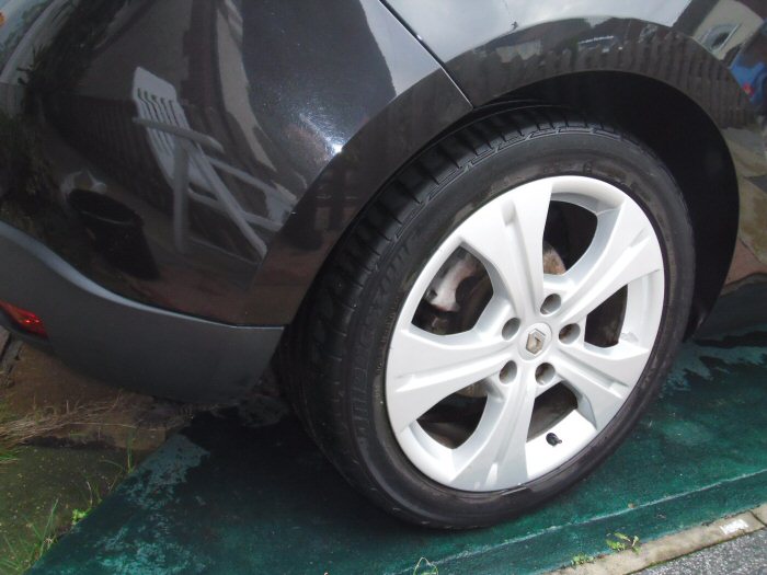

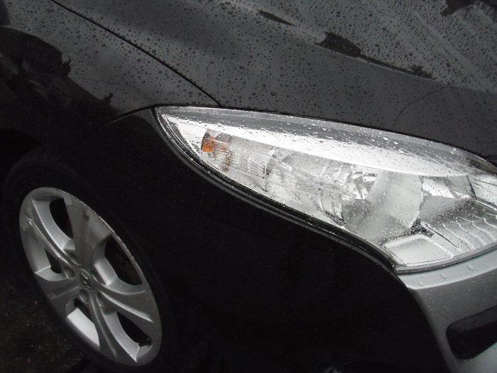

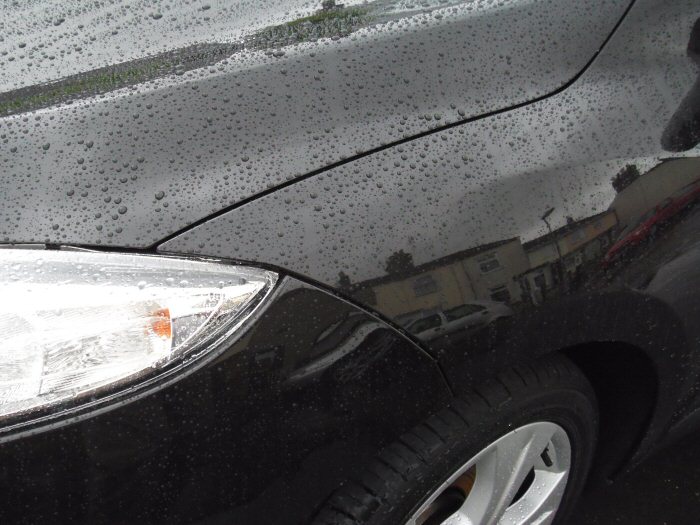

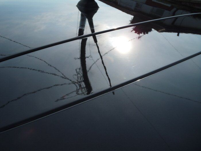

    The Following Day
    Well, once I've completed a detail, I don't really mind if the heavens open.
    I know the paint is protected and there might be some nice beads to look at
    instead. It seems that it rained for most of the night and a fair way into
    Sunday morning - so no big reveal :/
    Now, anyone familiar with my posts will know that I don't hold much store
    by beading, other than their pretty patterns. So, here's a quick walk around
    the car after a fairly wet night...

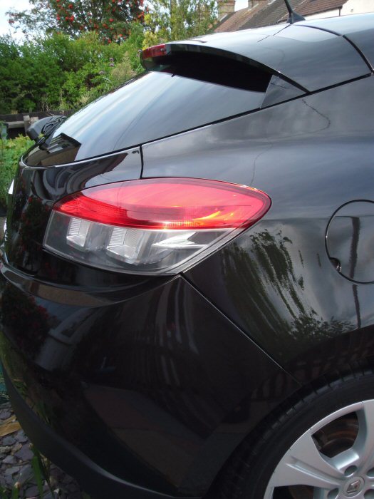

    Long-term Report
    Because Cover Up doesn't possess any protection qualities of its own, it
    does depend upon its wax or sealant cover as far as longevity is concerned.
    Quite obviously, 50.cal recommend their own wax for this task, but that still
    transfers the onus of longevity to the wax.

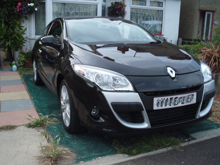

    So, 5 months on, here's a picture of that same car after a quick winter wash
    carried out today. There is a hint that it'll soon need treating once again...
    ...bearing in mind how badly swirled the car was initially, I cannot fail to be
    very impressed. I imagine that to some extent it also depends upon the
    protective coating placed over it, because in and of itself the "Cover Up" has
    none. In this case it's not .50Cal's wax because I'm carrying out a longevity
    test for another review product.

    stroke the Merc was almost "orgasmic"
    So far, I've used about a 5th of the bottle on doing two full cars along with
    playing on panels of two others. So, in the value for money stakes it does
    very well also. Despite my reservations over its effects on human skin, I can
    do nothing but recommend this product and it will be on my replenish list when
    the time comes
    Where Do I Buy It?
    The 500ml bottle of "Cover Up" filler glaze costs [strike]£17.99[/strike] excluding delivery.
    Since 02 February 2015, the cost is reduced to £13.99, excluding delivery
    and is available direct from the 50.cal Detailing Web Site
