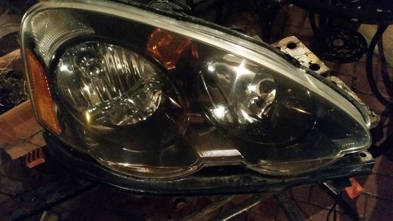

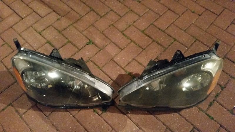

    I was asked if I could sort out these Integra headlights that had gone hazy.

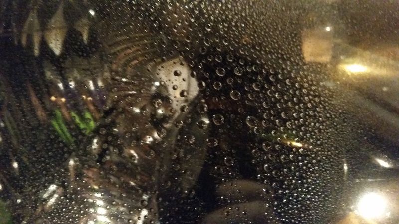

    When they go like this, the light projected becomes distorted and can restrict your vision at night. They also look tired and dull.
    The lights before...
    Not the worst I've seen but they can always be better.

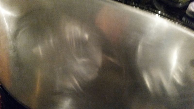

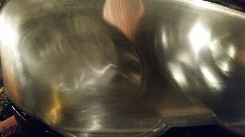

    These lights weren't so bad so I started on 1500 sand paper.
    Then 2000.

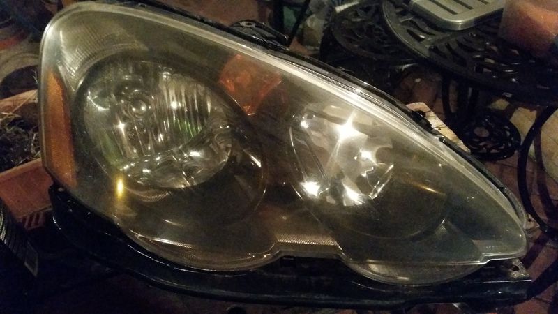

    I then gave them a 2 stage machine polish to remove the sanding marks and refine the finish.

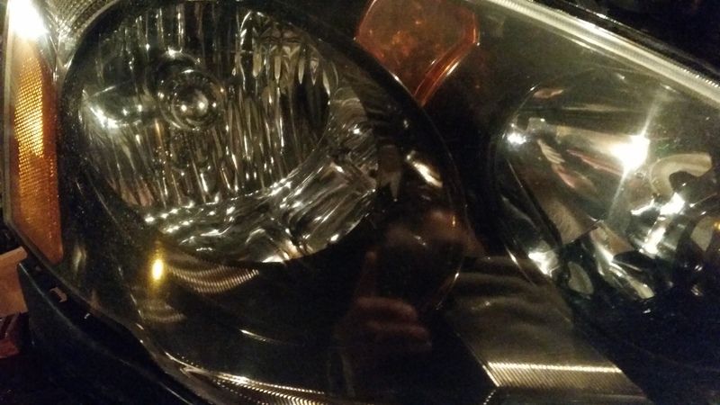

    Some added protection to help them stay clear.

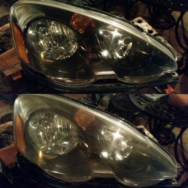

    The finished article on the left, untreated on the right.
    And a before and after.

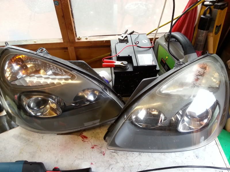

    I need to do my Bora again. The lights are pretty bad on it.
    It's been a while since I done a set of Clio lights.
    These were the last ones.
