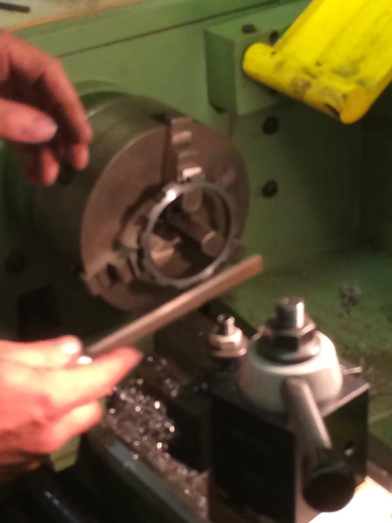

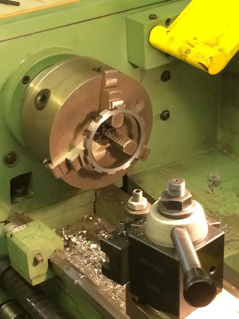

    Right then chaps, like a number of other peeps on here I'm using a non standard gearbox in my 5 but wanted to retain the standard speedo, so after some measuring and tweaks of the design I came up with this.
    The prototype I had laser cut but required some adjustment on the lathe, a bit of testing it works perfectly once I'd made a spacer to mount the standard sensor using a valver hub (although a different bracket could be fashioned for a GTT hub), the only thing you need is a valver outer CV joint.

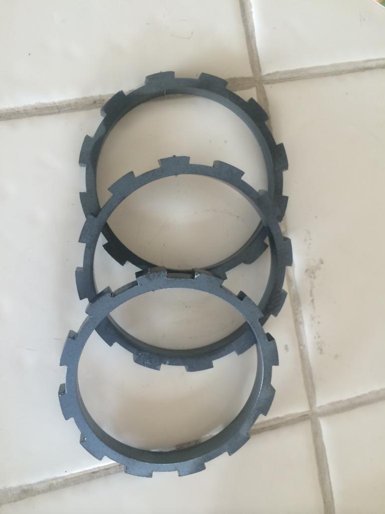

    Now it's all working I've had the CAD drawing adjusted and some rings made up for those that want them.

    The standard valver cv joint has an abs ring, just pop that off and pop this speedo ring in it's place, I put abit of glue on mine just to be doubly sure, but then I am a paranoid f**ker lol

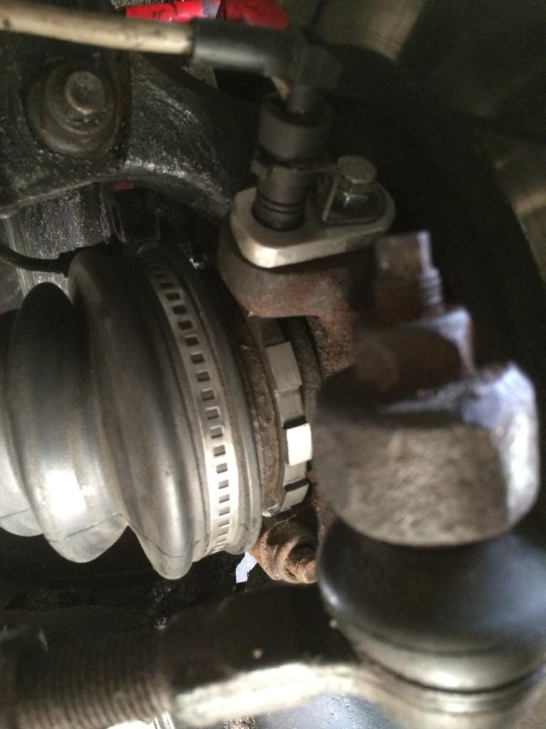

    Thought I would re-open this thread as I have just fitted one of these to my passenger shaft and am using a STD GTT hub so was really wanting to see what sort of bracket people have made and where have they mounted them from also clearance bag between the sensor and the ring required?
    Re: Non JB3 gearbox speedo solution
    I've welded mine to a std gtt driveshaft. Yet to make a bracket for the sensor
    OK I've kind of cheated and done it the easy way and gone and bought valver abs hub's and using a valver abs driveshaft's (fit with no issue's), just knocked the ABS sensor ring off and fitted this 12 point ring, just awaiting valver hubs to arrive then I think all I will need to do is make a spacer for the very long GTT Speedo sensor. Ill get some pic's up when I do it

    Anyway, for those that want more details, I used the valver abs hub and offside outer cv for mine ignition ally but after the driveshaft made a bid for freedom I had the replace it with a pattern shaft which the valver cv didn't fit so the outer cv was chucked on a lathe and only required a small amount removed to fit the speedo ring and 3 little spots of weld to stop it shifting.
