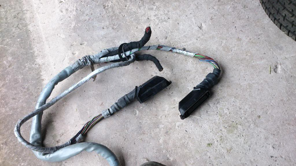

    Hi guys,
    I picked up a 440 turbo engine ,box,ecus (everything) at the weekend. Ive noticed a possible problem that the loom is cut where the 'red' connector, the fuel pump relay,ecu relay and 2 fuses fit. Im hoping I can wire these up as theres plenty of wire there, does anyone know if the relays are specific or can you use more readily available relays? I assume the fuses wont be a problem does anyone know the fuse rating? Long shot but If anyone has the relays they want to sell please let me know
    Any help appreciated

    They're common 4 pin relays, one that comes on with ign to turn on timing ecu, other with thick grey/red wire) turns fuel pump and ecu on during cranking. Both 10a fuses.

    Thanks Haz ill see what I can get hold of!
