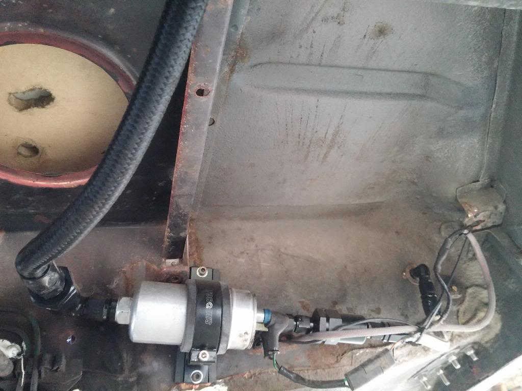

    I think i removed the original filter and pump and fitted a new bracket to hold the pump in the same place if you can wait till sunday i can get a picture

    JP did you manage to grab a photo mate? Just trying to work out how Everyone has mounted them and what they've done with the fuel filters

    Sorry for the poor picture but here you are
    Even used the original wiring to make it easier

    That's awesome thanks man.
    Where abouts have you located your fuel filter?

    He he i have 2 if you look really closely you will see both in shot
    One before the pump one after. You can see the one after easier its the black alloy bit after the pump they are only small but both use a brass cone shape guass which you can clean or replace. I take them out every year and drain the tank down and wash filters out

    God they're s****y were they expensive? Do you know the union size to go the standard fuel hosing
