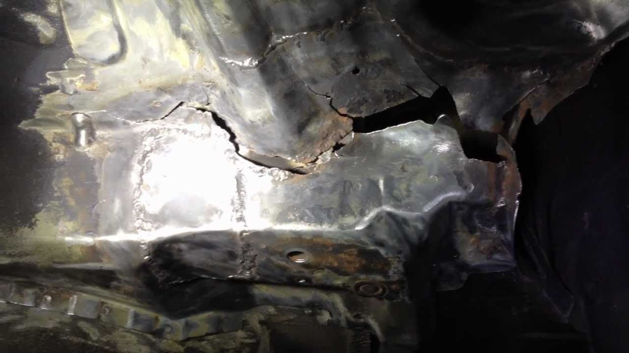

    I was imagining a crack or something minor. That looks real nasty is that becauseof too much power ?

    Just put it this way, they built a 340bhp rwd car with near enough same design as the bottom of the range spec.
    After a big long court case of failures, built qty was in a grey area you could say hence BMW did/are fixing them for free under certain conditions but only if they choose to.
    Re: Bmw M3
    I was just asking because an original floor that may or may not be about to knacker up and a replaced/strengthened floor, will probably have subtle differences that would be useful to spot when purchasing.
