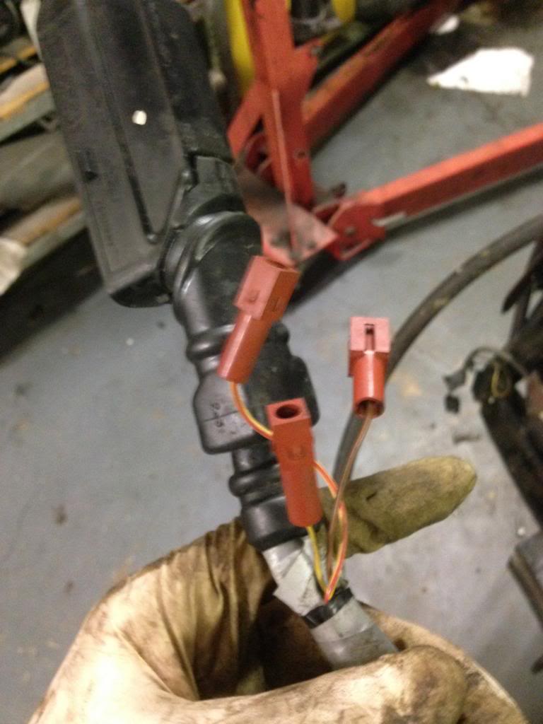

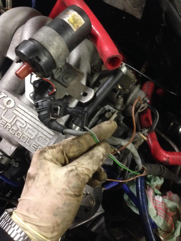

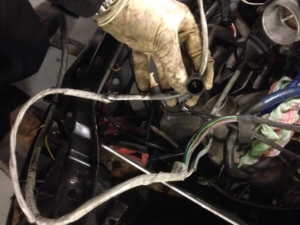

    If any of you B18fters' can work out what these unknown plugs do you can have 1000 man points!!!!
    Have looked around the engine for a good hour and cant find anywhere where the plug in????
    The one with the green and grey wire if its hard to make out

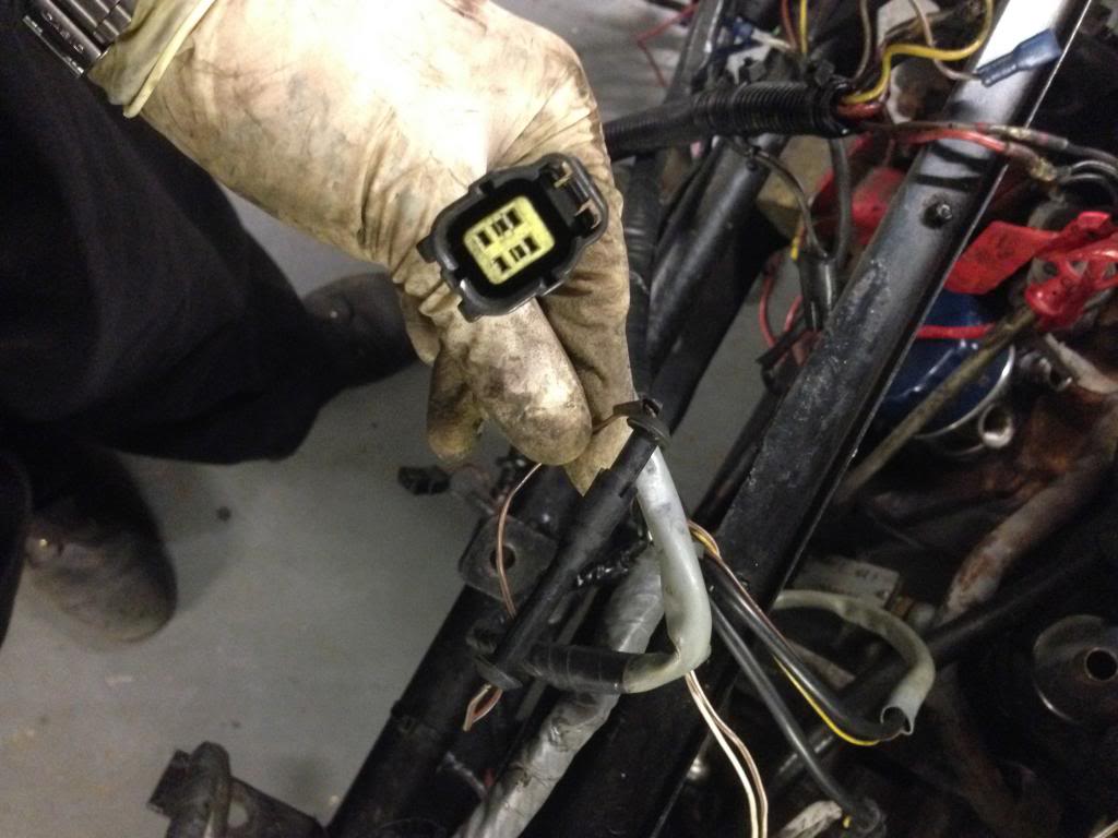

    & these three by the ECU plug??
    Thanks all

    yeah i will be, when you say bottom three, do you mean bottom three pictures, or the three connectors in picture 4

    Hi Benji, if you weren't all the way down there in Bath you could have a look at my 480...........anyway some guesses from me:
    plug for.....
    #1 - oil level/pressure or maybe idle control valve
    #2 - coolant temperature sensor
    #3 - knock sensor??
    #4 - see link below.....

    There's a wiring diagram in the b18ft boards but the second pic is the ecu temp sensor goes on the head. And the rest are test points.

    1, yellow -oil level and oil temp (Volvo gauges), black ones - test points.
    2, brown - coil earth, green/grey - electronic boost control.
    3, power to aux waterpump.
    4, ecu test points
    All are not required for conversion, but get it running before you chop them out if you plan too.
