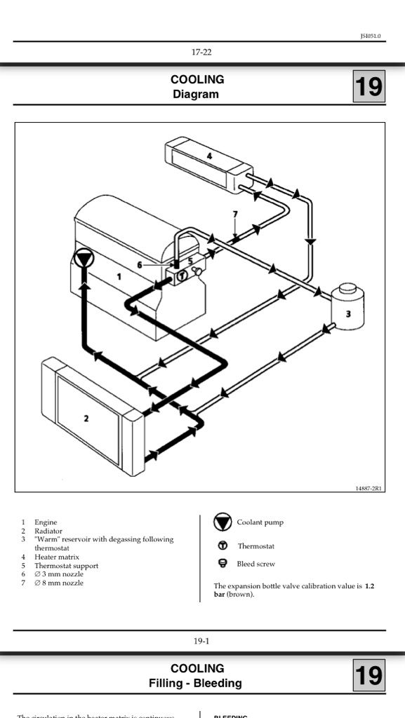

    coolant flow diagram
    does anyone have on or can explain with a photo

    F4R coolant flow diagram if anyone ever needs it.

    Re: coolant flow diagram
    can i run the radiator and just block off the thermostat hoses?
    Quote Originally Posted by beast View Post
    Aye, as long as you've got the rad piped up as shown you can block the other ports if you don't want tu use the heater matrix etc..

    thats good i will use them eventually just i am all ready to start the car tomorrow apart from the coolant system and i know i haven't got the pipe work to run the heater matrix etc i was gonna run from the bottle to the rad and run the rad pipes to the engine and block the rest till the shops open Monday. this would be ok and wont ruin my engine?
