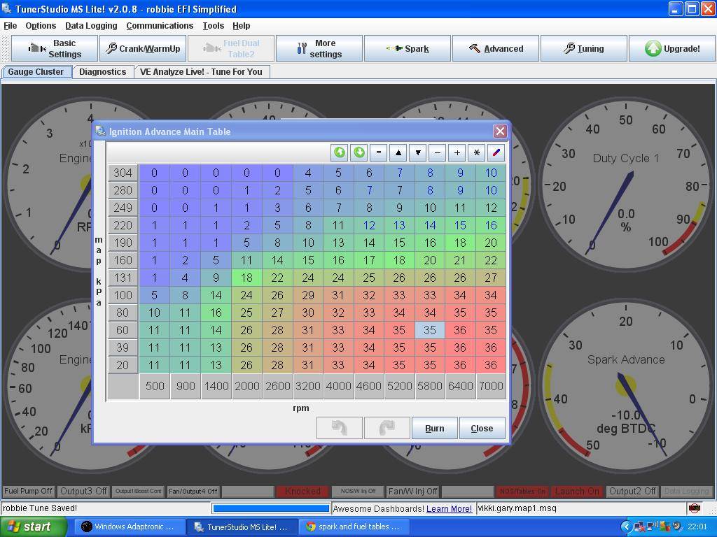

    Does anyone have the standard spark map for the b18ft want to check it against mine.
    Re: standard volvo spark map?
    Post up yours again mate, maybe we can help

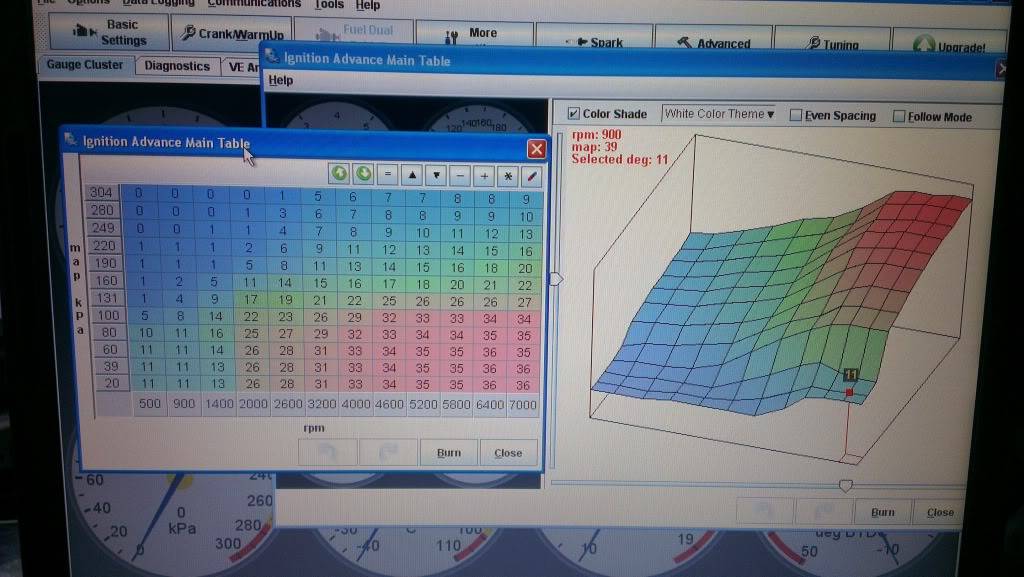

    Looking at it it has changed slightly il get a pix of the current one.
    This is how it is now
