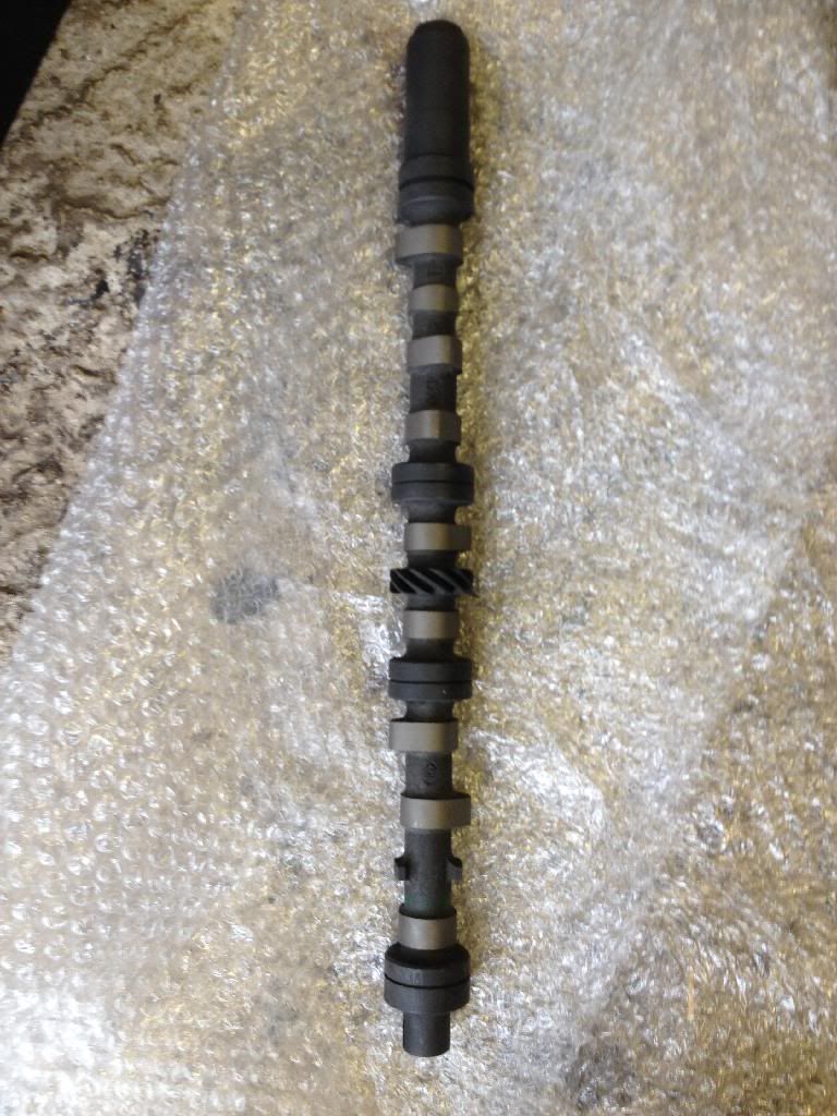

    also got a package from andrew cooke today
    some sort of camshaft type thing?
  12. #112
    Re: the le car 2 turbo
    Whoa, nice, uprated dipstick. Only fitted from the factory in France.
