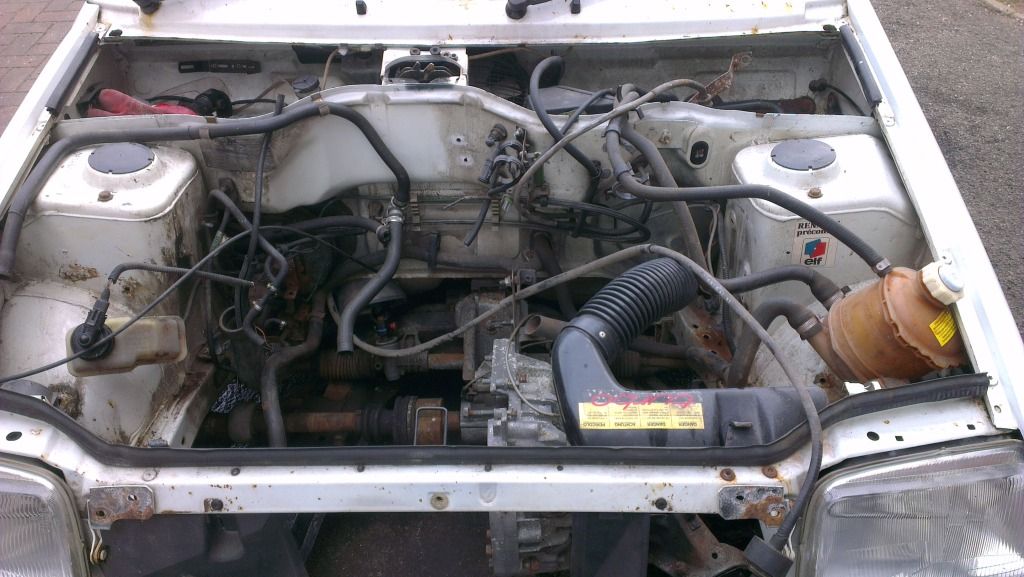

    Dare say a few gt turbos have looked like this pic before lol.
    Worse Phil it was 5 years and one month old when I got it from a car dealer and Renault owned it before him. Has 4 previous owners on log book
    To be fair on the old girl she got hammered by me. So guess I owe it to her. I couldn't get rid so stored her.
    What seems a lifetime later I now have the know how to do things and with my engineering backround thy shall be done.

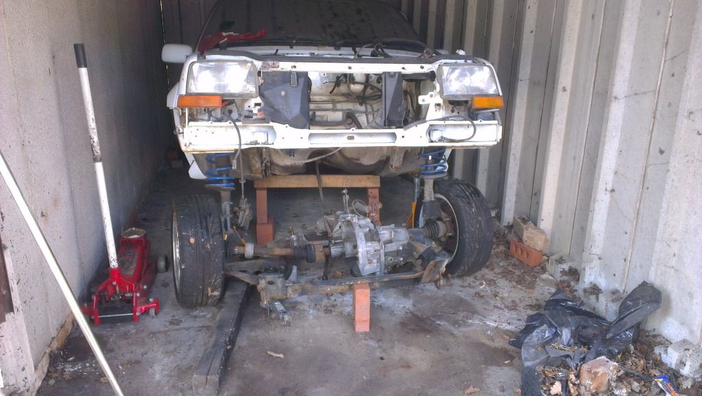

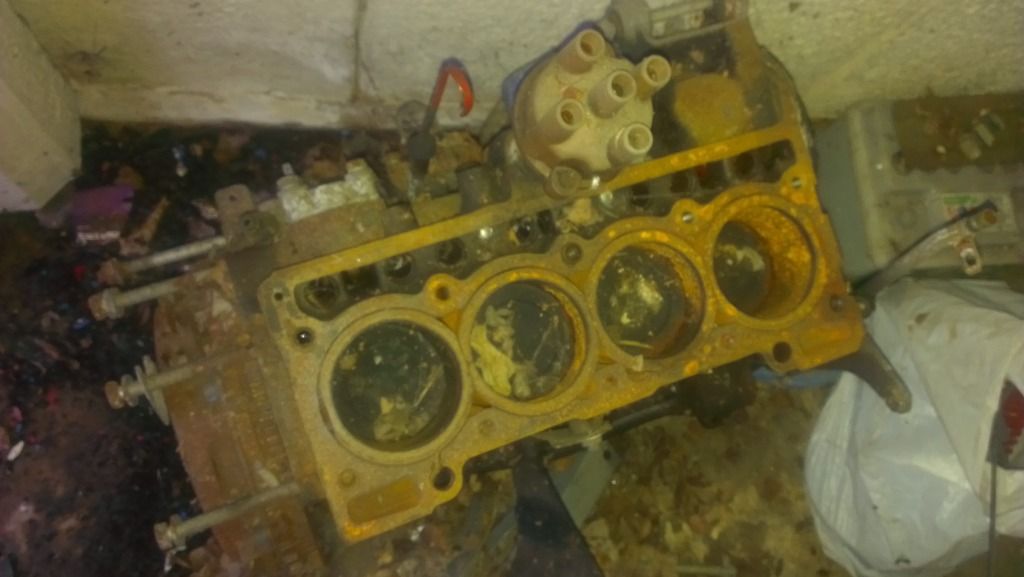

    I currently run a forum for jap import people carriers www.nissanlargofriends.com (got a few kids lol )
    So I know people like pics. Here goes
    How she sat for last 7 years

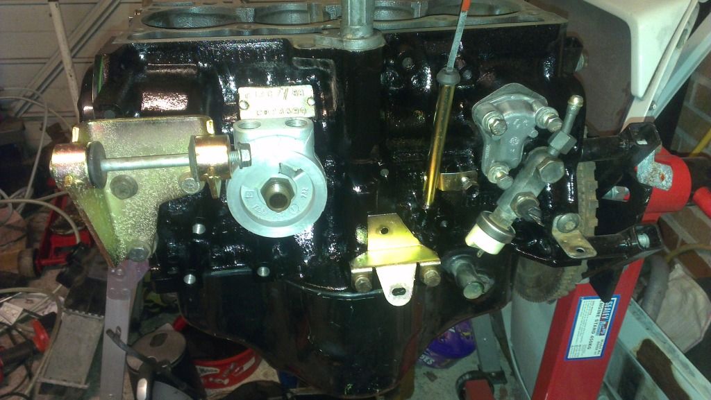

    Problem found so rebuild in order .
    One side cleaned and painted so far
    Still cleaning other side for paint .

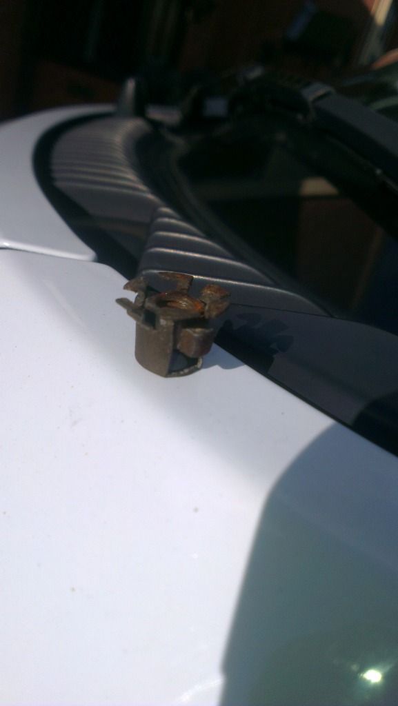

    Ok so tried to get waterpump off head today.
    Damn thing was almost welded on. 2 bolts broke in the head grrrr . Managed to get one out but the other one is going to need work.
    Also does anyone have any of these spare
    Its the retaining bolts that go into chassis for intercooler bottom bracket.
    Re: Project revive the 5
    Welcome to the club, getting stuck in good lad!
    1,214
    I may have that bolt I'll have a look later for you in my 3 biscuit tins full of nuts and bolts that never found there way back on the car

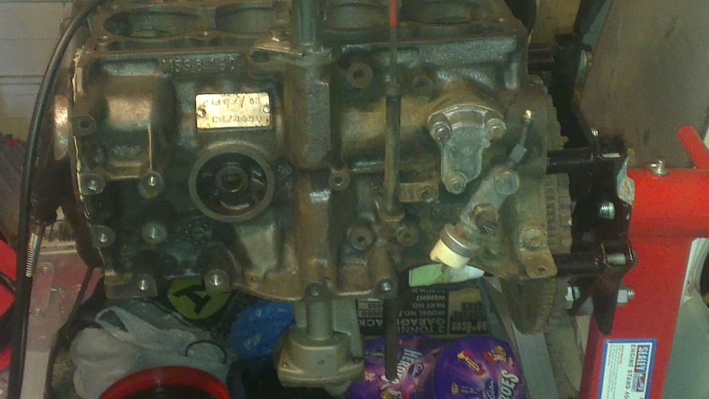

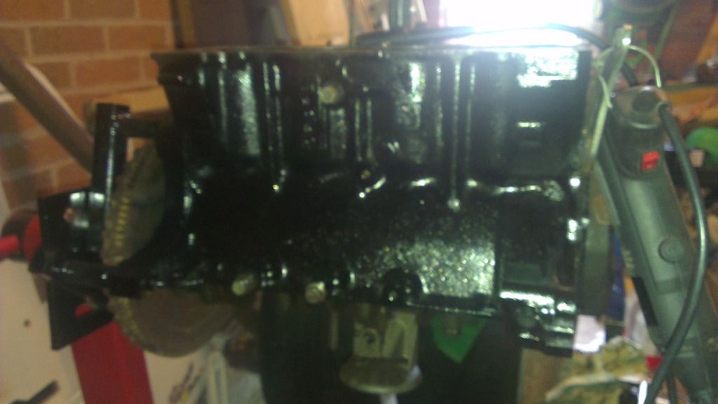

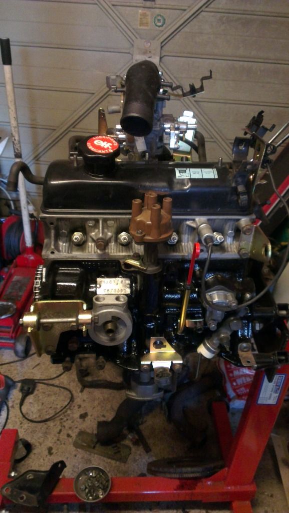

    Small update of a busy weekend cleaning.
    This is before
    This is how the block sits right now.
    Always wanted my engine that clean. Looks like I need to make a list of bolts and visit my local fasteners place.

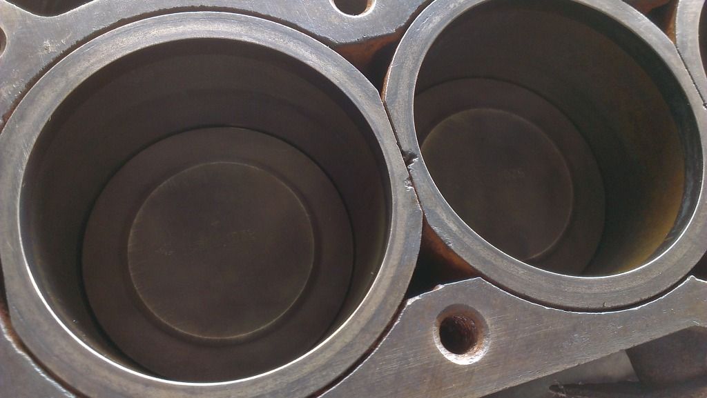

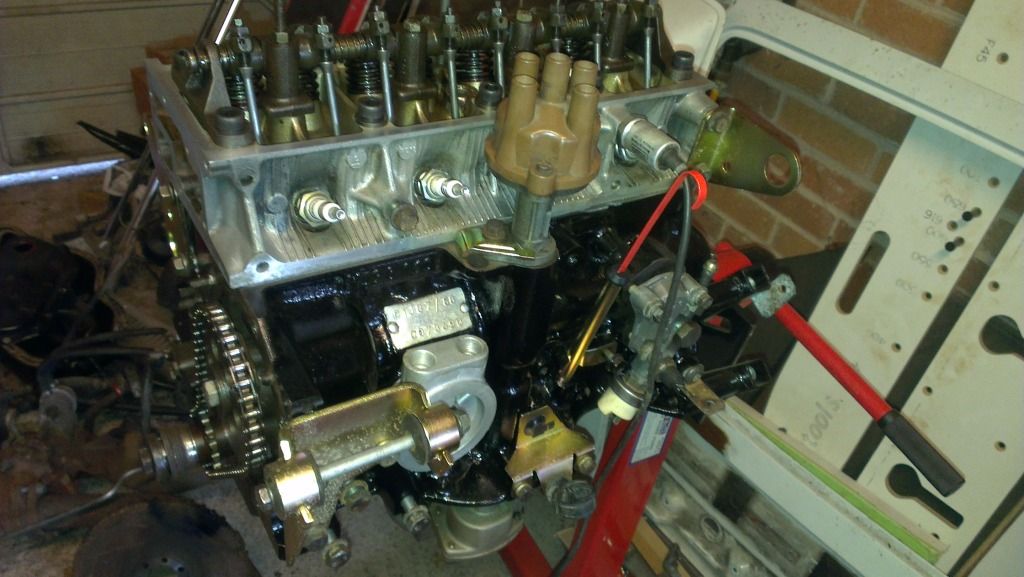

    Finally managed to spend some time on the engine build. Lots of cleaning and cleaning again .
    Fitted liners ,piston rings , crank seal/bottom end seal set. Cleaned all head faces , pushrods and followers. Fitted new blue seal head gasket with 12.9 headbolts. Cleaned all threads out with taps . Set head bolts to 45 ftlb and set tappets. Checked tappets 3 times lol to be sure.
    Sure hope I got this all right as its a first rebuild. Please feel free to say if I've done anything wrong.

    Looking absolutely fantastic, keep the C1J fresh, great feeling when it starts going back together.
    Quote Originally Posted by NRG View Post
    Are ngk B8evx plugs ok ?
    Plugs will be fine mate looks good

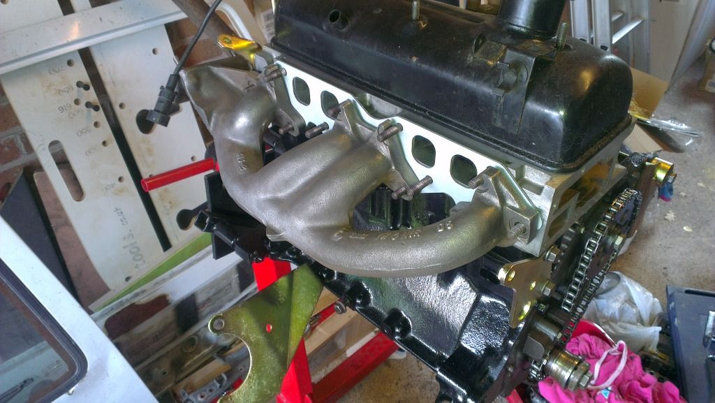

    Cleaned exhaust manifold today
    Very impressed with the result. Looks almost new.
    Slow progress but getting there.

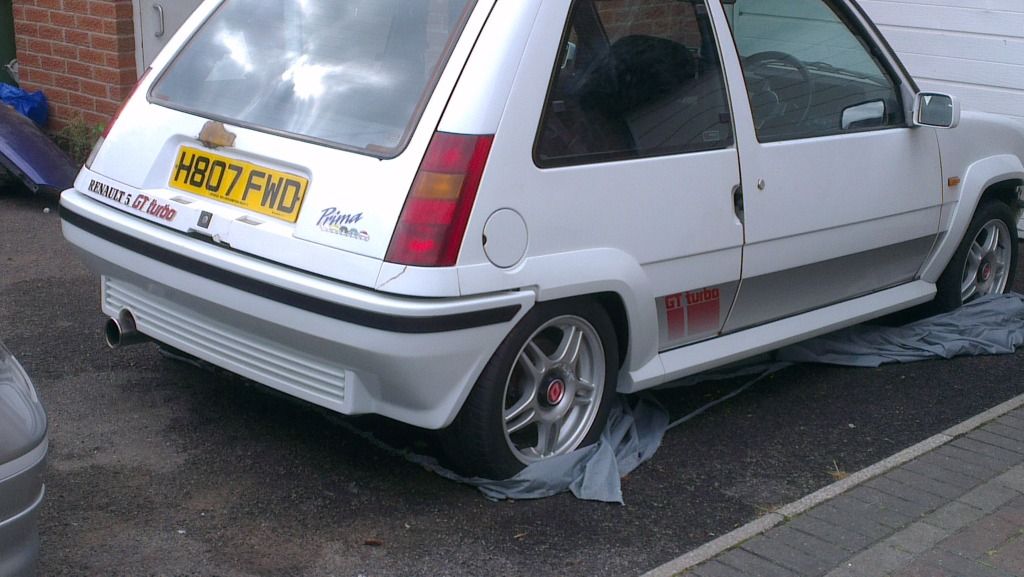

    Scored a fairly good rear bumper and fitted today. Looks 100% better imo
