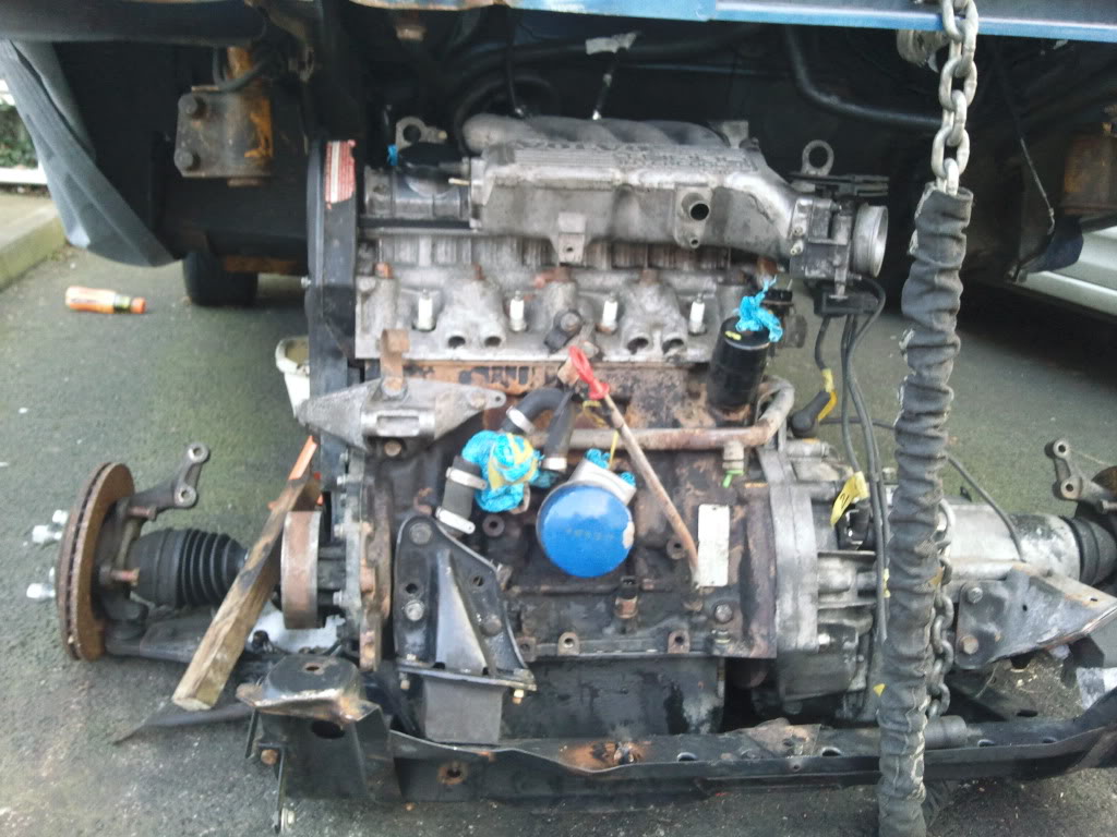

    Can you re drill a GT front engine mount to fit on the B18ft, Has anybody actually done it? had a quick look earlier at mine an its looks a bit of a dodge if done??
    Re: GTX mount using a GT mount?
    I did it been fine for nearly 3 years now. Top hole stays the same the lower two change and you may need a thick washer to avoid the bolt catching the mouth lip if you get what I mean. Il have a look for a pix.
    Should be able to see in this pix

    ok, that answers my other question regarding which holes do you use, thank you
