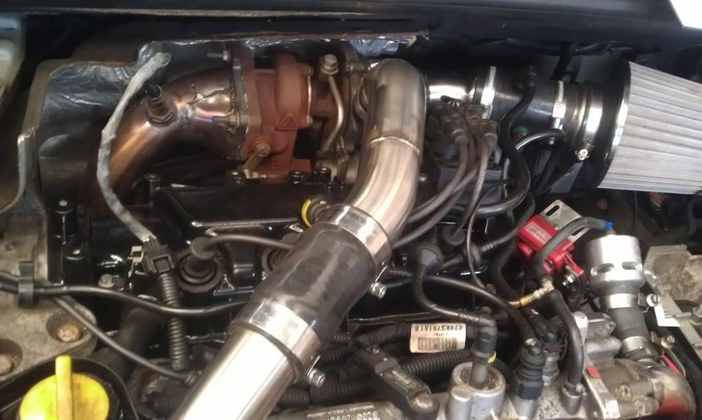

    Re: Help with tce project needed
    I've had manifold custom made to fit this turbo and it's the triangle flange k03 type.
    The manifold is 4 into the turbo, top mount turbo. Down pipe should be easy to change size as is easily accessible out side of turbo :-)
    Does the k04-015 have the same fang as ko3? is it a triangle flange if so this could be an option... Turbo technics did say there was no upgrade though strange.... If there is one.....

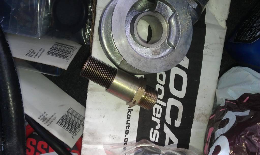

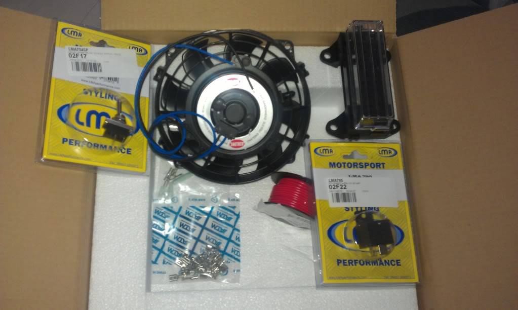

    Ok guys gals, pistons and turbo aside for one moment,
    I'm going to finish off the 13 row mocal oil cooler next weekend it's mounted next to intercooler and ready to plumb in now I have the right oil feed pipe. I'll be removing the o/e water fed oil cooler)
    so i need a bracket and fan for the mocal oil cooler..... Why... Because I sit in a lot of traffic and want to keep her cooler than a penguins bum....
    Any ideas of who can supply this!?
    Do you know the optimum temp your oil needs to be to do it's job properly?
    Might be worth finding out first, as you don't want to over cool your oil as that will cause your engine to wear very quickly as the oil won't lubricate properly if it's to cold.
    Unless or course you have already done this and the fan will be controled by a thermostat to regulate the oil temp as oppose to over cool it. Colder than a penguins arse will definatly be no good for the engine bearings not mention the turbo

    Call to deamon tweeks and 5 minutes later ive Ordered 7" fan, wire, switch, and seperate relay to wire in properly delivered Tuesday
    roll on next weekend, oil cooler with mrs fan... disks and pads... Tax was done this week too

    So the fan, relay box, wire, swtich etc arrived today picked up oil and filter just now... another busy weekend on the car
    Plumb in mocal sandwich plate now i have what we think is the right oil feed scew pipe,
    Brackets made for the fan, fit fan, and wire it all in,
    Disks and pads,
    See where catch tank can fit andplan for this....
    Oh and fit a side light bulb. Lol

    So a disappointing weekend... We know know that the sandwich plate does not fir this model.... It fouls on the oil pump bolt by about 2-4mm. No space at all for fan
    We tried to modify the sandwich plate, grind the wall down but it wasnt enough, we couldn't do anymore ad the seal would be out of the cast otherwise and leak,
    No spacer plates available for mocal so only a remote oil filter set up is the option....
    Found the oil feed pipe to turbo leaking slightly so a braided line is a must ASAP
    2 clamps on the pipe to keep this at bay for the moment
    Boost clamps were all loose to tightened these all up....
    Bulbs fitted no probes. N
    Steering wheel eletrics are dead.... As I had cruise control, speed limiter, etc etc all the wires needed to run it fouled on the boss, so to resolved out came the cutters.... Still steers right and left... Job done, just need to wire in horn
    Disks and pads on easy enough... Lol.... So now have measurements for someone to help make up brackets for wilwood 4 pots.
    Last note... Will a tcv from a Megan fit mine??? We think it may resolve it not liking boost over 1 bar. It holds 1.2 just.... But doesn't like it boosting quick in low revs.... Wonder if this could be solution. ??
