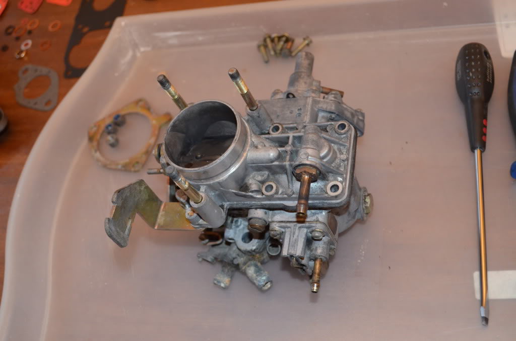

    1. Remove the carburettor from the car. (disconnect the carb inlet elbow, accelerator and choke cables, fuel pipe, vacuum pipe from accelerator pump, vacuum pipe leading to boost compensation circuit, two coolant pipes, pipe from enrichment device)

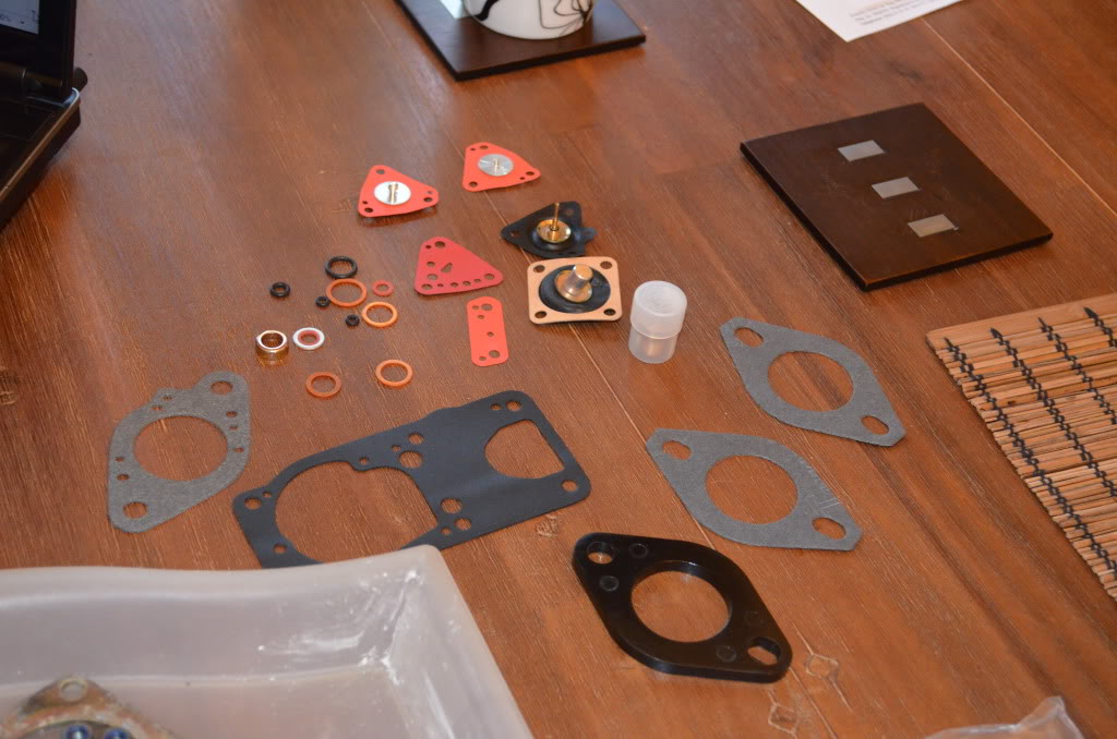

    3. Set out the parts from the service kit, you won't need all of them, so there will be some left over at the end. It makes it easier to match which parts you can replace if you can see them all.

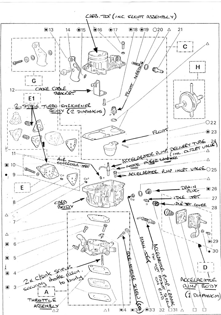

    The diagram below shows all the parts you need. A good idea to familiarise yourself with it before you start.

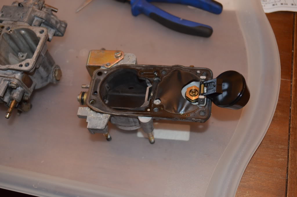

    5. Undo the six screws on the top cover and carefully remove it - lift it straight up so you don't damage the float. Be careful, as the float chamber will probably be full of petrol. Tip this into a jar, and you can use it to help cleaning.
    6. Undo the screw holding the choke cam on, and remove the cam. Give it a good clean.

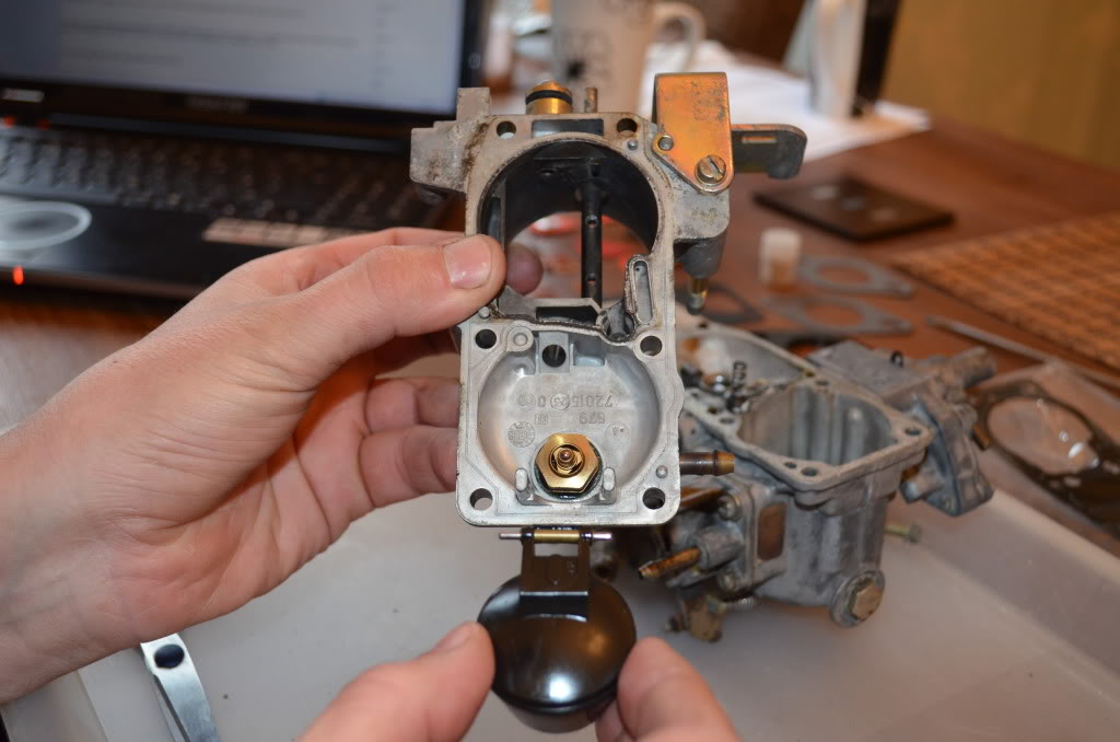

    7. Slide out the pin holding the float in place, and remove the float carefully. You can also remove the gasket.
    8. Unscrew the fuel inlet pipe and pull out the small filter from inside the housing. Give them a clean.

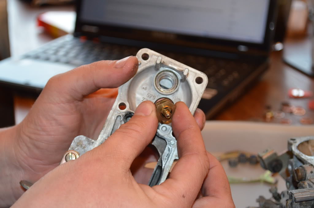

    9. Unscrew the float valve, and remove along with it's copper washer.

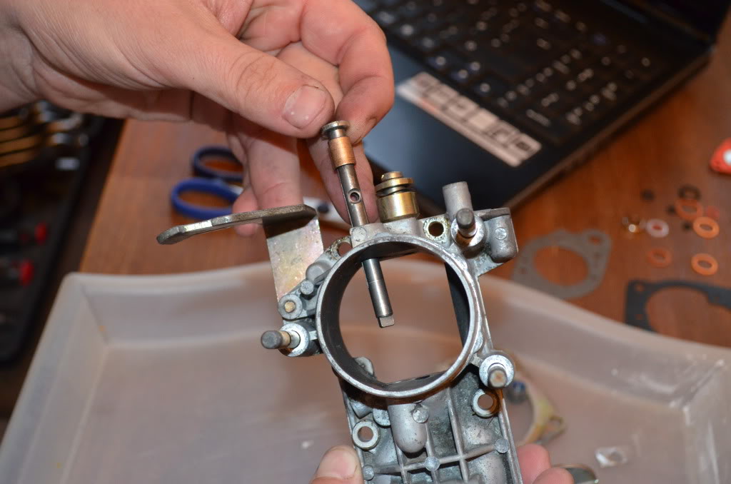

    10. Undo the two screws securing the choke flap to it's spindle. These may be stiff, so be careful not to shred the heads. If you do - you can drill them out, clean up the threads with an M4 tap, and use new short M4 screws. Slide the choke flap out and clean it up.
    11. Remove the spindle, and clean it up. Also remove the metal bracket that the choke cable fixes to.

    13. Fit the new float valve and washer from the kit.

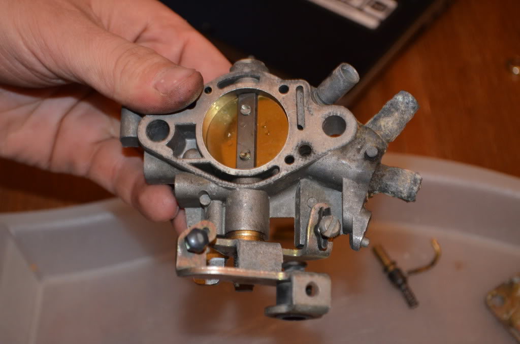

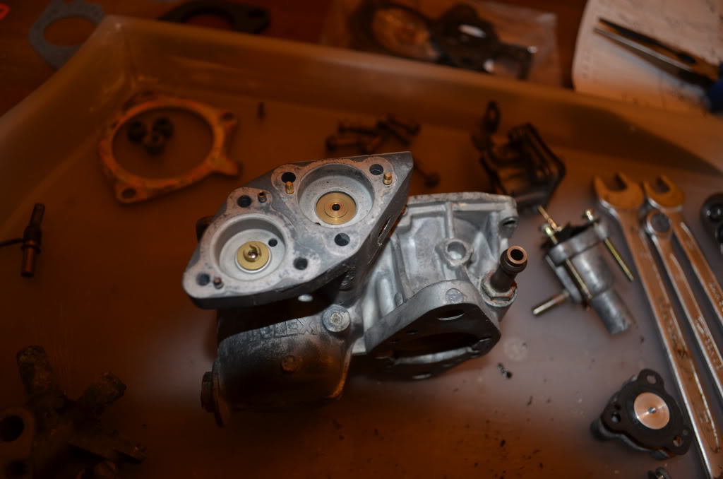

    18. Undo the two screws on the throttle assembly, and remove it from the main body of the carb. Remove any gasket stuck to the top. You might need to carefully scrape it off with a knife - be careful not to scratch the metal.

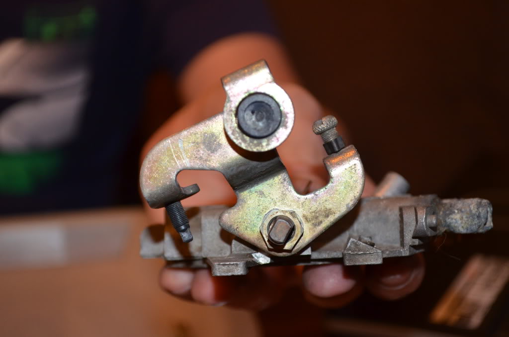

    19. Remove the throttle cam from the spindle. Note which way up it goes.
    20. Undo the screws securing the throttle butterfly to it's spindle and remove it. Like the choke flap, the screws are easily damaged, but can be replaced.
    21. Remove the spindle and clean it. Be careful not to damage the seals, although new ones are available from Webcon if they look worn. Check the plastic bush inside the body, these can wear or split.

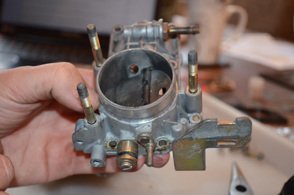

    22. Give the throttle assembly body a good clean up. This tends to suffer from corrosion on the coolant connections, and a lot of oil spray from the rocker cover and breather pipe. If the engine has been suffering from hesitation, or has overheated in the past, it's worth checking the base for flatness.
    23. Put the throttle assembly back together and set aside. Take the main body of the carb, and give it a really good clean up with carb cleaner or petrol, wire brush and cloth. Use threadlock on the throttle butterfly screws, as you don't want them falling out!

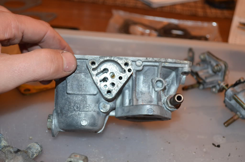

    30. Undo the large bolt in the bottom of the float chamber.
    31. Remove the accelerator pump jet, and clean out any dirt (use the carb cleaner aerosol to blast it), then refit.
    32. Remove the main jet and clean out any dirt, and refit.
    33. Undo the large screw on the side of the carb.
    34. And remove the idle jet. Clean out any dirt and refit, ensuring that the flat rubber seal is in good condition. This seal can be replaced with an equivalent size O-ring which should be petrol resistant, ie, made of Nitrile Rubber. If this seal is in poor condition (dry/perished etc) it may cause poor idle problems.

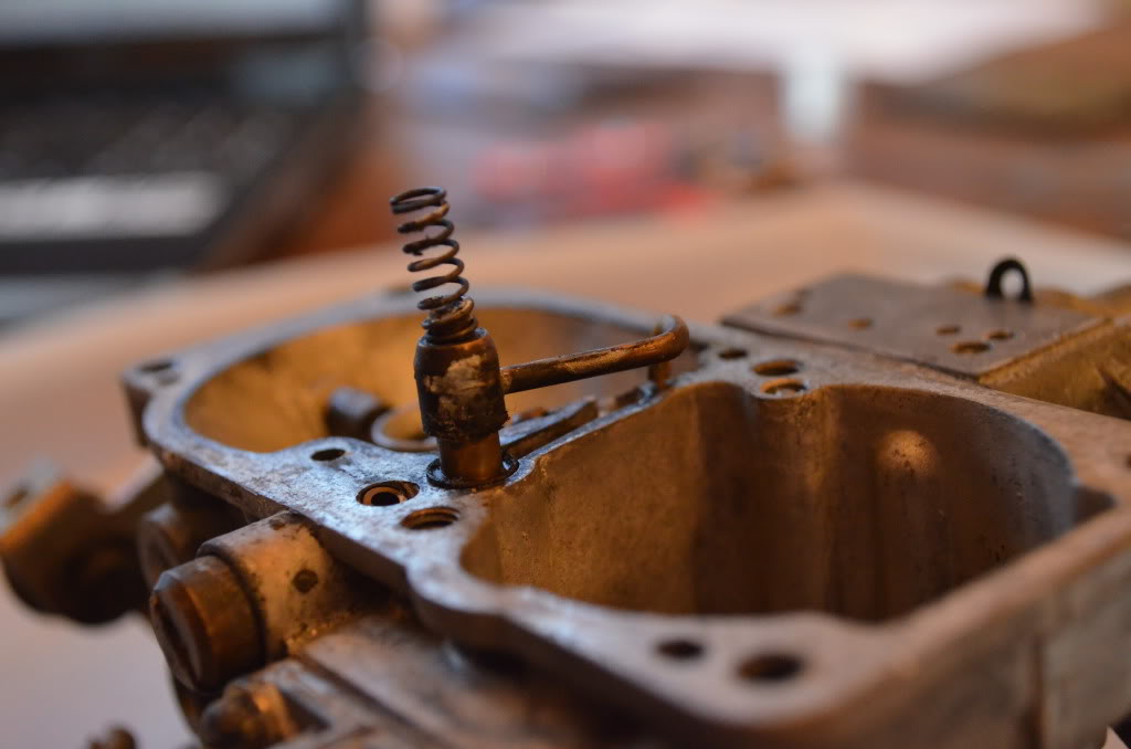

    35. Remove the air corrector jet and clean - also squirt carb cleaner down the emulsion tube beneath to clean that out. You can pull the emulsion tube out by screwing a bolt into where the jet was and pulling hard. Refit the jet.

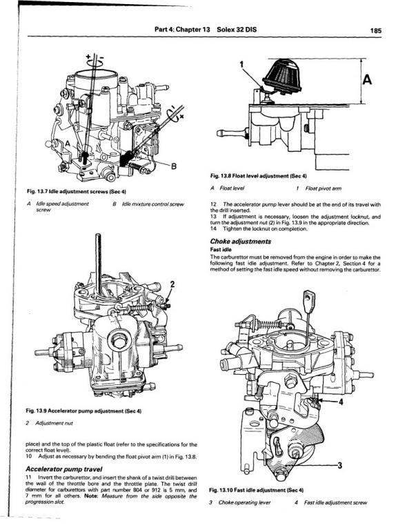

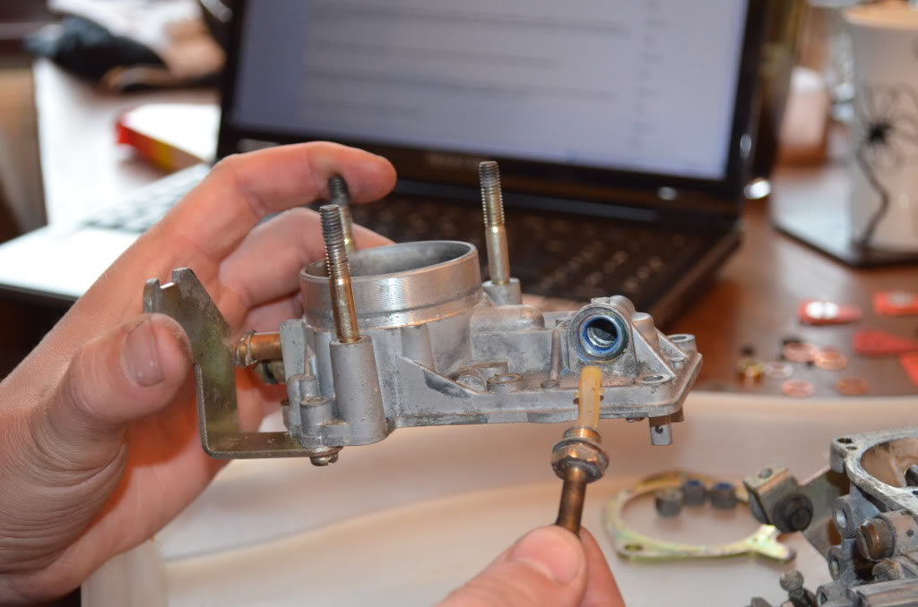

    41. Take throttle assembly and put the accelerator pump rod through the lever first, then use the new gasket and refit the assembly to the carb base with the two screws. Using a 5mm drill bit between the throttle butterfly and body, ensure that the accelerator pump is just fully compressed, then check the throttle moves smoothly and operates the accelerator pump when you move the cam.

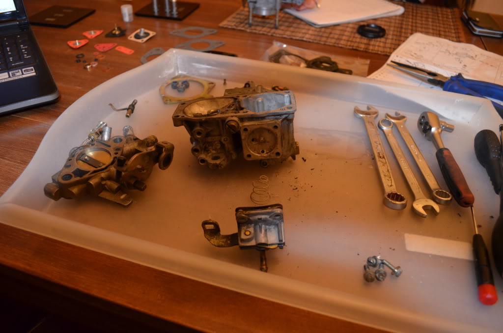

    44. Admire your shiny, clean carburettor. Then refit it to the car. Remember the float chamber is empty of fuel now, so it'll take a little longer on the starter the first time whilst it refills. Check the idle speed and mixture are still right - as you may need to adjust them as things have moved.

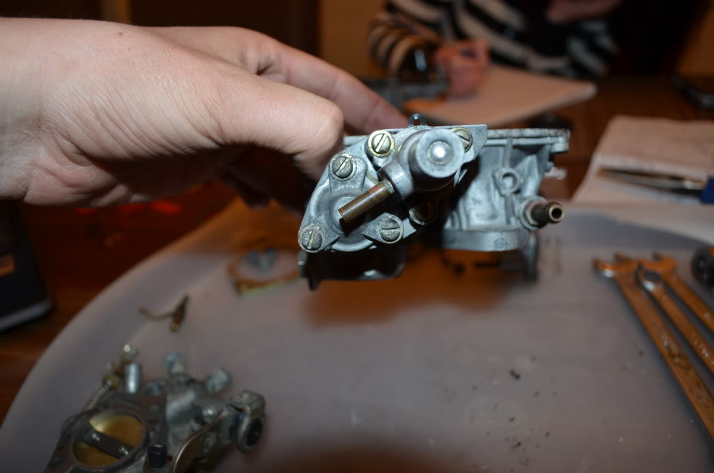

    Before anyone comments, I have rehashed the old rebuild article, changed the odd word and added my own pics from my carb rebuild.
    I no way say I am an expert but I believe all the pics are correct.

    Mods Attention
    Can you add this pic to the carb rebuild guide in the articles section please? Its pretty handy as it has more detail on the 5mm drill bit adjustment
    I stole it from Wallace's thread - sorry
