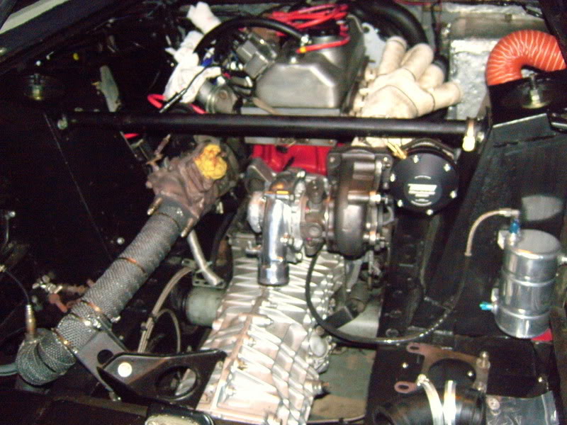

    Ime starting to think its stick with the T3 Genuine TDC manifold with the T3 flange, recent custom exhaust,

    Just out of interest a old pic with the manifold trial fitted (before anyone says out i know theres 2 turbos)

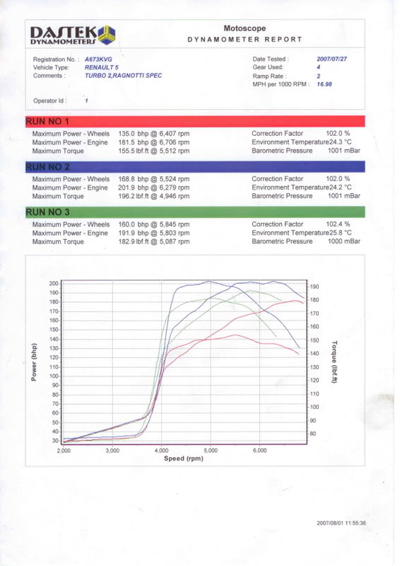

    This is a print out from a rolling road session at Motorscope last year with the standard(ish) engine, the three different readouts are because they were playing around with the MF2 controller/Water injection & boost, It was really crap to drive. really on/off, It had the smaller exhaust housing fitted

    I wouldn't worry too much about previous results, what was that, about 1.3 bar? Pretty pisspoor result, but then, motorscope... You can see the turbo choking the engine from the shape of the curves.

    Andy, The boost was 1 bar not 1.3 as i said on the in a prev post Still a little tempted with the GT28RS, ill see how things go into the new year. skint at the mo

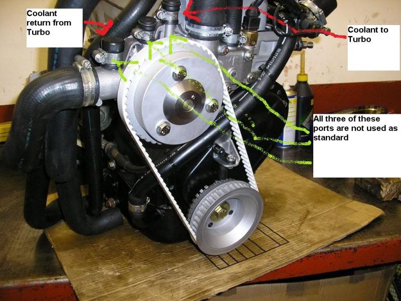

    the turbo 2 water pump has 3 ports blocked off. surely you can use those to get water to a turbo?

    Just a thought for maybe next year now the cars back, water cooling the turbo would it work similar to a GTT, Looking at young Steve's water pump coolant to turbo it looks similar?pic of T2 water pump

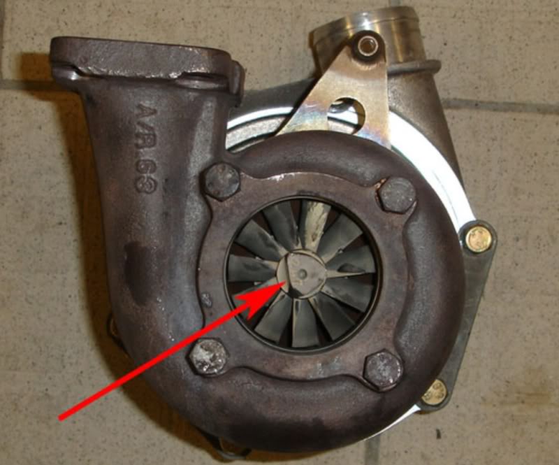

    Just thought i would post this pic of a T2 maxi exhaust housing, it a big n
