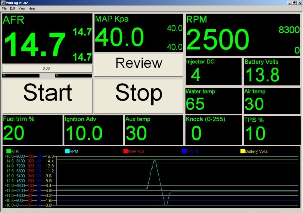

    Hi Guys
    I had a customer ask me if it would be possible to use the very handy, free version of WinLog with his Adaptronic e420c.
    No one had written a device driver for it and since it would also be usefull to me I decided to write one.
    I've included it here for download.
    Its tested with some E420c's and an emulator. It should work fine with 440's too. It will not work with E420b !
    Connect the laptop / PC running WinLog to the ECU in the same way you would when using WARI (for 440's it will be neccessary to connect a COM port to the Serial out jack).
    What is WinLog ?
    Go to http://www.devtechnics.com/winlog.htm to read about it, download it and so on.
    Then download my driver bundle (for COM1, 2, 3, 4, 5 or 6) here: http://www.efi-parts.co.uk/downloads/Adaptronic_WinLog.zip
    Read the included README.TXT. In short, you install WinLog, un-zip and copy the driver files (link above) in to a new directory (not the WinLog directory). Run WinLog, go to "File, Open Dashboard", navigate to the drivers directory and select "Adaptronic.dsh". Finally, go to "View, Device configuration" , "Add" , "Have disk" then navigate to the drivers directory and select the apropriate driver.
    The dashboard is configured for the COM1 driver as default. You can right-click, then go to "Edit, Properties" on each of the gauges to set them to a different COM port driver if you wish.
    You can fiddle with the dashboard (screen) layout all you like, I just included a basic one to get you going.
    What can I log with this driver ?
    RPM
    AFR
    MAP kpa
    TPS %
    Water temp
    Air temp
    Aux temp
    Injector duty cycle (%) (a calculated average of the 4 injector outputs)
    Ignition Advance
    Fuel trim %
    Knock (0-255)
    Battery volts
    Screenshot:
    Feedback welcome,
    Chris
    www.efi-parts.co.uk

    A few years ago they were selling a "vidigauge" kit but they seem to have not been pushing it of late. I don't know if it's still available ?
    You could use WinLog on a tablet, or anything that runs Windows. WinLog itself is really nifty in that you can customise the screen (dashboard) to use digital meters, analogue dials and whatever size you want them.
    The software comes with a view tool aswell to review the logs, a little like Innovate's software.

    Just been out for a play and it works for me with my usb adaptor and laptop.
    Thanks for the new tools looks very clear and easy to read. just need the car running again to test it all out properly.
    Re: For users of Adaptronic engine management
    Quote Originally Posted by Logg View Post
    Thanks, thats good to know, I didn't try it yet with a USB adaptor
    I just updated the download zip with a slight tweek to the driver code with better comms error checking. I included Fuel trm and Ignition advance values too. If yours reports version 1.0 then re-download, current is 1.1

    Another slight update with further improved error detection to help avoid spikes in traces.
    I've added another channel - AFR Wideband - which echos the result from a wideband controller connected to the 2nd serial port (EG Innovate, tech edge, AEM UEGO, etc.)
    Non-member TNT ANDY's Avatar
    2,614
    You can point at stuff and say - 'that one there' when I see you. It makes more sense to me that way haha.
    Quote Originally Posted by TNT ANDY View Post
    Sorry andy, I read back what I just wrote and it didn't make as much sence as it could have !
    In other words, if you have a wideband controller in your car which has a serial out (like an LC1 or AEM kit) then you can connect that to the 2nd port on the ECU. Then, the ECU can keep track of AFR so you can enable closed loop below 100kpa say, for improved ecconomy and emmisions. But aside from that you can now log that AFR reading along with all the other important paramaters in Winlog.
    Before you could only record the value from the narrow band sensor, if installed. It wouldn't report the result from a wideband kit connected to the ECU.
