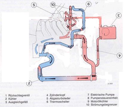

    Using a std gtt radiator does anyone one have any helpful tips for the water pipe run? or is there a better rad to use that is easier to pipe up?

    the gtt rad works well for std-15psi and is the simplest, more and the oil starts gettin warm takin the water temp up too. pipe run is simple, use the volvo metal pipe that runs round the block normally for the oil cooler. back of head there's 3 ports, maddle sized 1 to turbo, out and into that volvo pipe, biggest into matrix, then header tank then t into thermostat to top rad pipe. smallest as a self bleed to top of header tank. header tank works ok in std position but could do with being higher.

    Re: B18FT Conversion Parts and avice required
    volvo water system here:
    https://www.rtoc.org/files/Technical%...%20cooling.jpg
    i just swap the turbo outlet and matrix outlet round due to size, but similar setup to that
