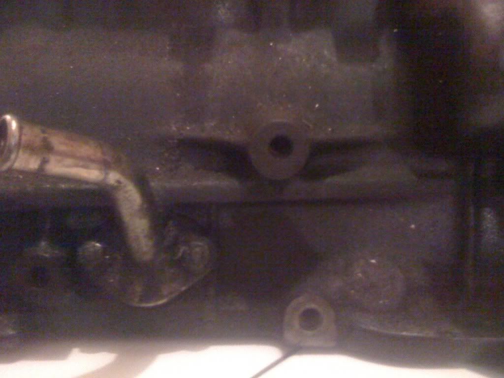

    Re: F7P oil feed & drain, water hoses etc
    Found this on the internet on the F7p lump for oil return
    Quote Originally Posted by James5 View Post
    Cool, I think that will be easy to sort out.

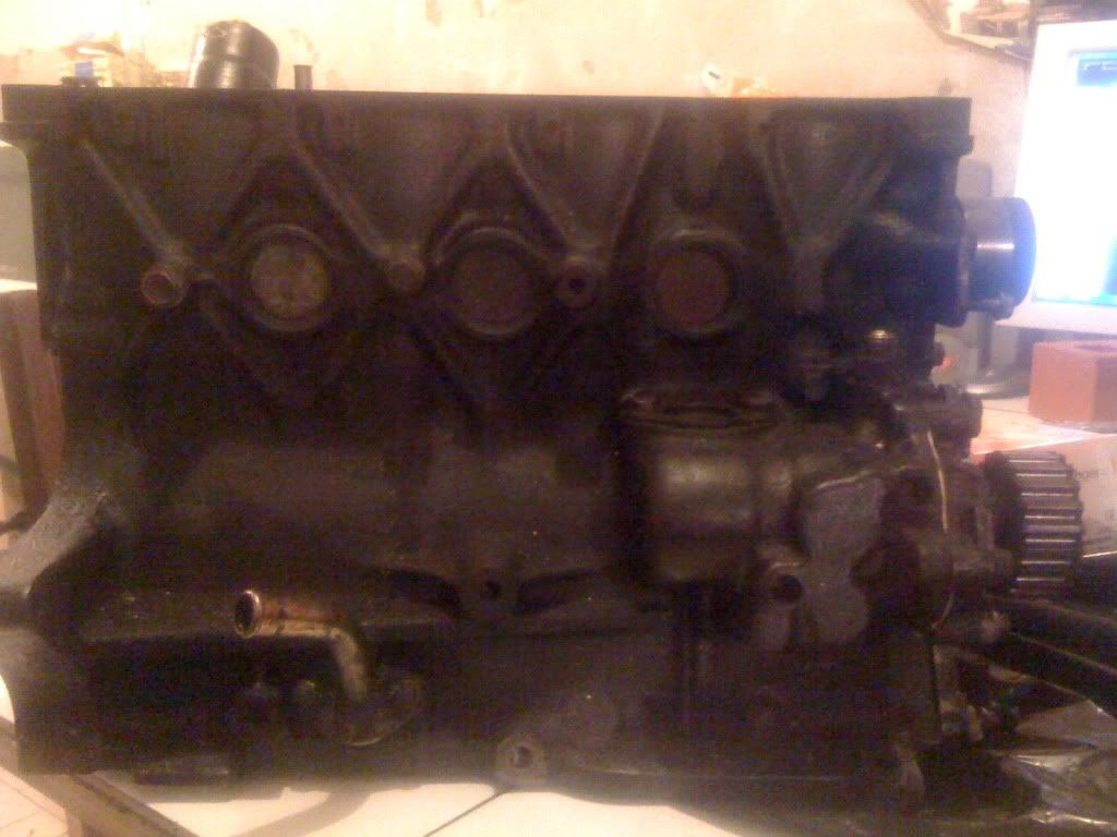

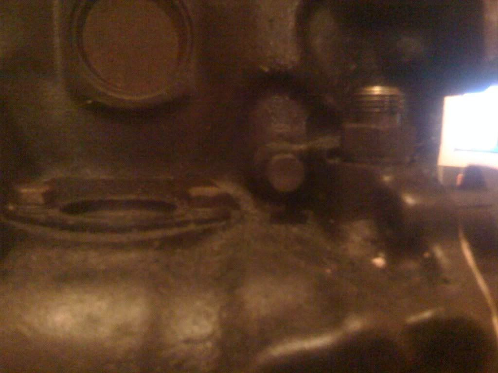

    Just some pics of the b18ft setup so you can relate
    About 2 inches to the right of the b18ft oil drain location
    OIl feed location
    sorry about the quality steve, phone camera is poo
    Cheers for that, looks like it prob won't have the hole where the volvo does so maybe it's easier to put it where it is in the piccy James put up
