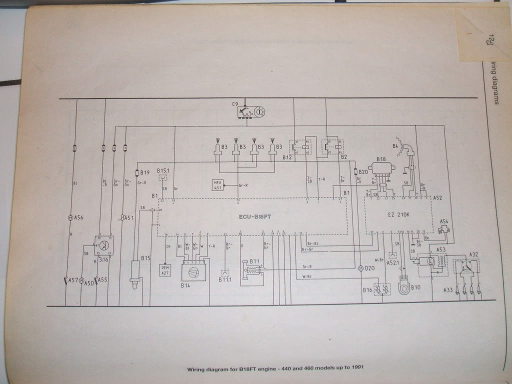

    This might help too.
    Non-member TrixNFlix's Avatar
    Preston
    2,028
    Re: Comprehensive B18FT into R5 Conversion Guide??
    B3= INJECTORS
    B12=FUEL PUMP RELAY
    B2=FUEL INJECTION RELAY
    B18=THROTTLE POSITION SENSOR
    B10=KNOCK SENSOR
    A54=BOOST PRESSURE REGULATING VALVE
    A32=DISTRIBUTOR
    A53=IGNITION COIL
    B11=IDLE SPEED REGULATING VALVE
    B19=O2 SENSOR FUSE
    B20=FUEL PUMP FUSE
    B15=O2 SENSOR
    D20=FUEL PUMP
    B4=CRANK SENSOR
    B14=AFM
    B16=ECU COOLANT TEMP
    Now get cracking!!!!!!!
