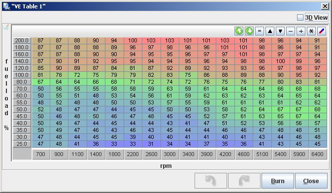

    Re: Injection map
    In megasquirt I have such a default fuel map:
    Is this fuelload% is identical to your TPS%?
    But why is is scalled to 200?
