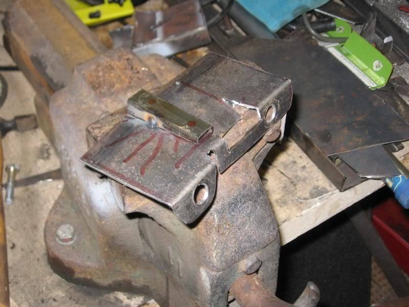

    here's a few of mine, this first one you can see clearly the bit I cut from the mr2 welded to the original fork, I didn't want to use any metal as it might not wear very well
    Here's a picture of the bracket, I will try and take of photo of everything together tonight as oddly I don't seem to have a picture of that.
