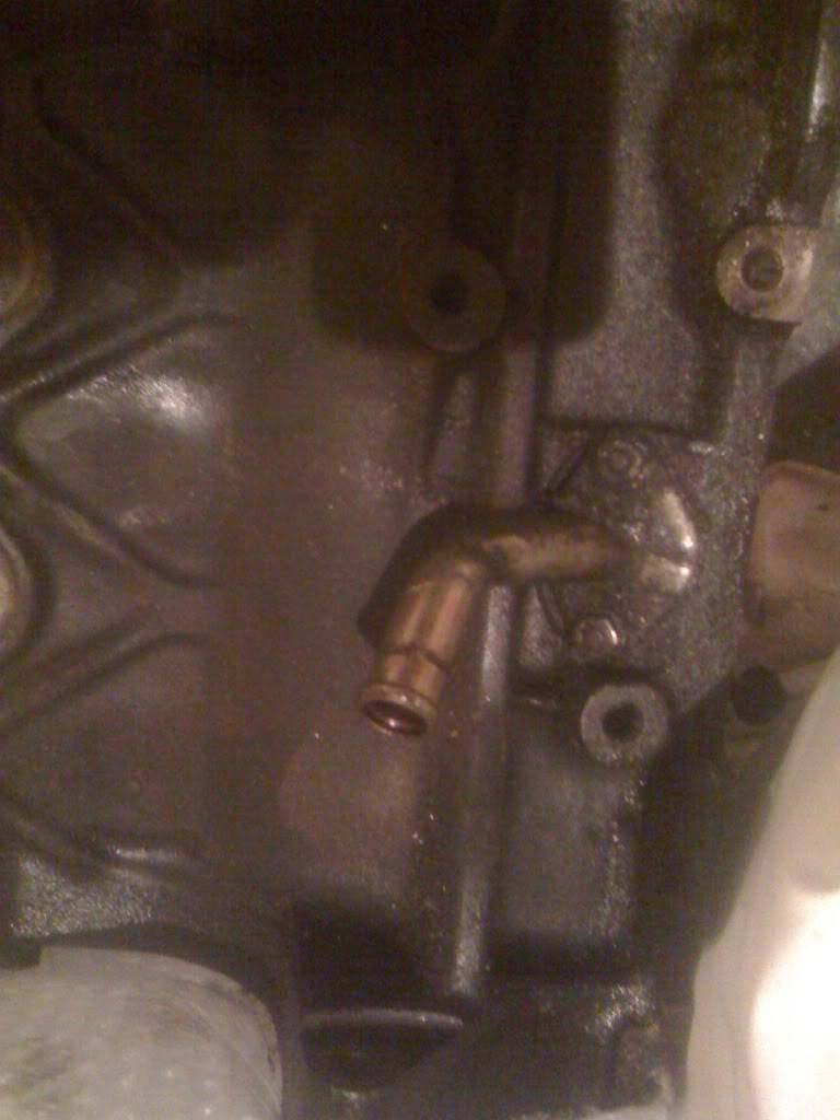

    does anyone know the diameter from the pipe of the oil drain? (going in to the sump)

    This is the Oil drain on my spare block sieger, sorry iphone camera

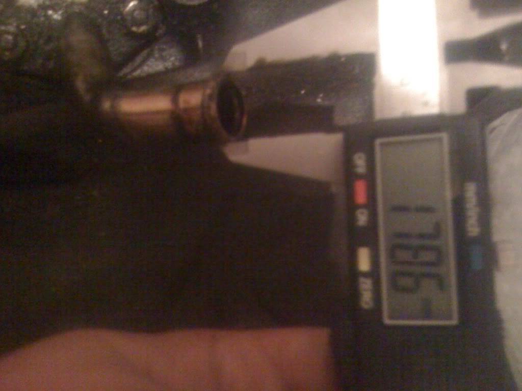

    The lip on the oil drain pipe is about 17.86 mm
    After the lip it reads about 15.72 mm. Hope this helps

    super! now i can order the silicone hose
