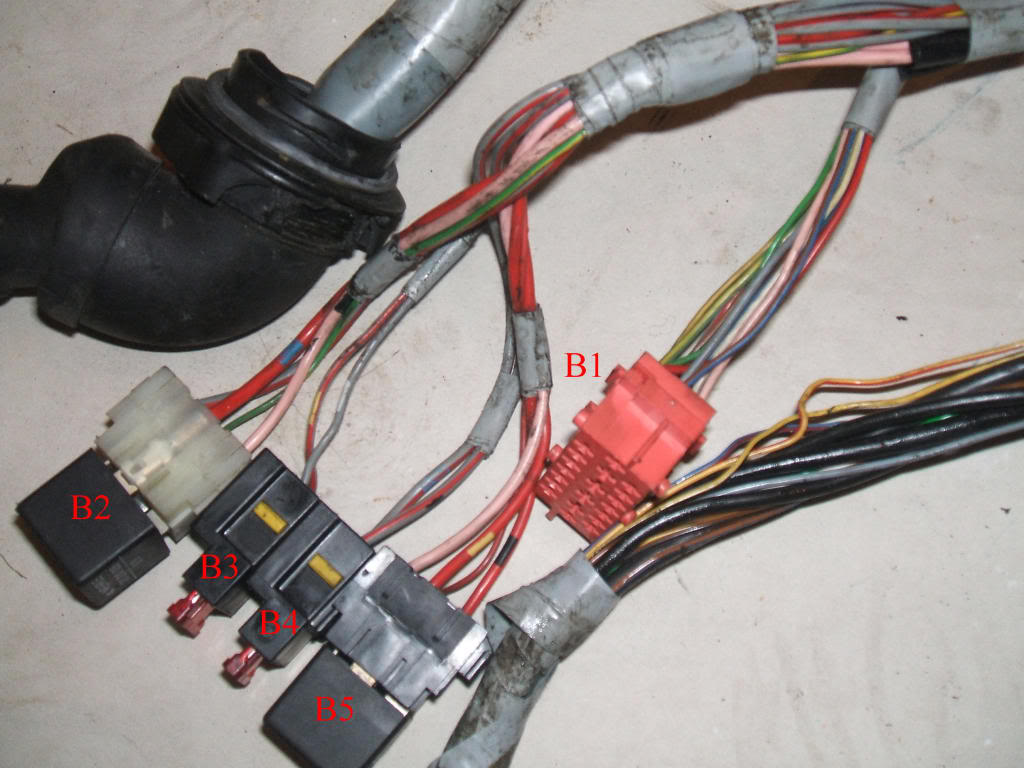

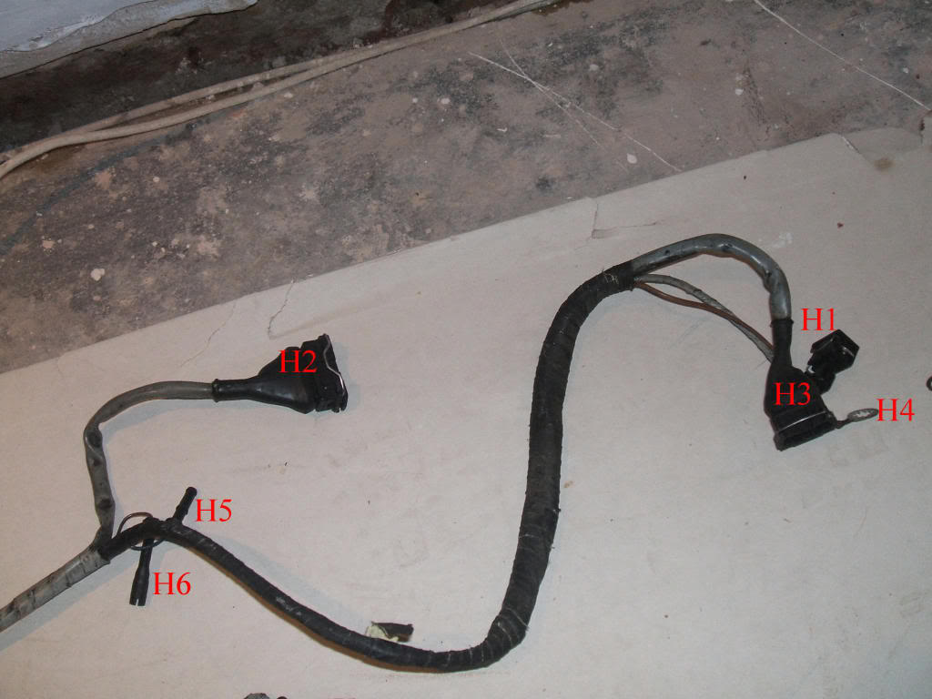

    Hi,
    Does any one have a wiring guide for what wires I have to connect from my Volvo engine loom to my 5 loom. I think I read some where that I have got to use 3 or is 6 wires from the red connector block but can't remember what wire is too. Any help would be appreciated as I really need to sort the wiring tonight.
    My red connector block has about 10 wires as I have read there's 2 different ones some have about 5 some have about 10.
    Thanks Andy.

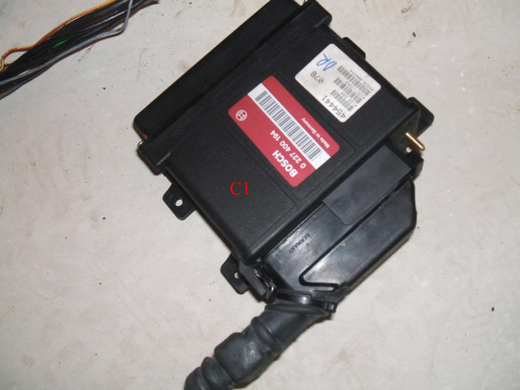

    Hi everyone,
    My fuel ecu is
    Green label
    0 280 000 959
    464492 (965)
    On white label
    464492
    462 23 (965)
    28rt0000
    5013 00018
    Ignition ecu is
    Blue label
    0 227 400 216
    464493 (965)
    On white label
    265 18
    22rt0000
    5325 00089
    Is there a way to check these are a match?
    I have started the car with the maf disconnected and it just stayed reving at about 3k and didn't try to stall and the screw is visible.
    Also checked resistance on the temperature sensor by plug 1 and on 1 pin it was 5.59 kohm and other 6.11 kohm.
    Any suggestions or advice.
    I have brought new dizzy, rotor and plugs to try and see if it cures the misfire.
    I have the engine setup as standard ie. Maf, tps, temp sensor, idle valve, knock sensor, crank sensor, injectors and coil all connected,I left the boost solenoid off and just put a piece of pipe from compressor housing to actuator.
    Also the fuel feed goes to drivers side of fuel rail and return from standard fpr on passenger side of rail.
    Thanks Andy.

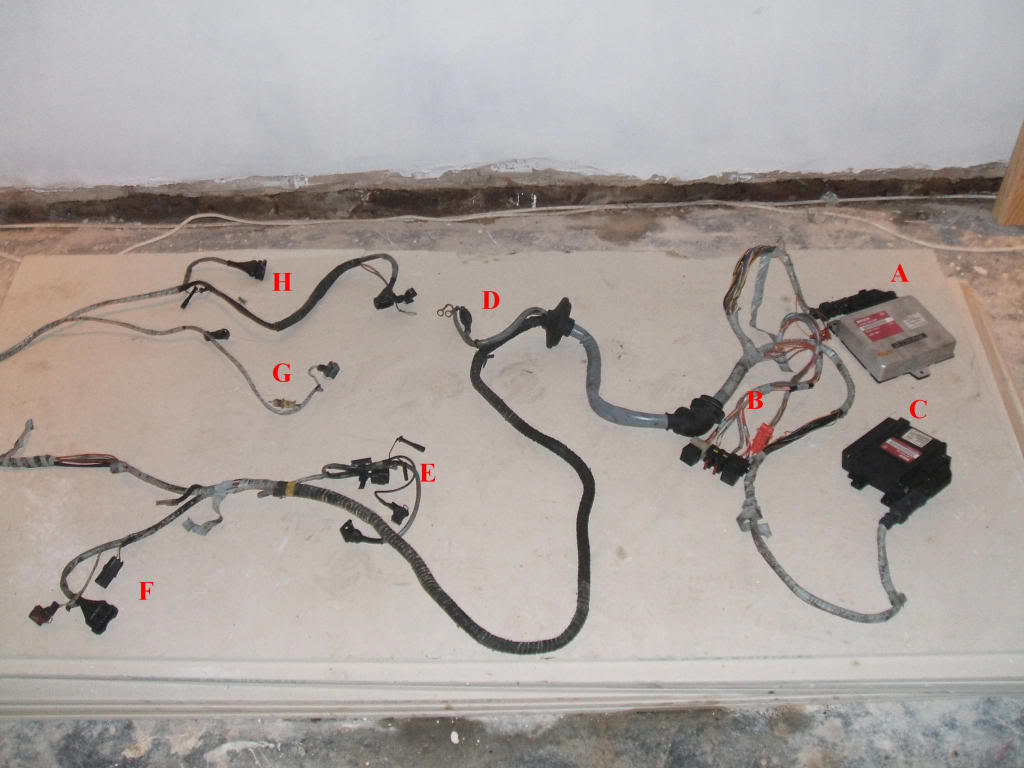

    Right guys this could help all of us, just wondering what sensors are for what etc with pictures, This is from a volvo 480, loom label says its from late 91 and is totaly standard. Tried to list what i think i right, please add to this and i can update these pics. Hope they help

    These pics are from the loom showed moving from right to left.

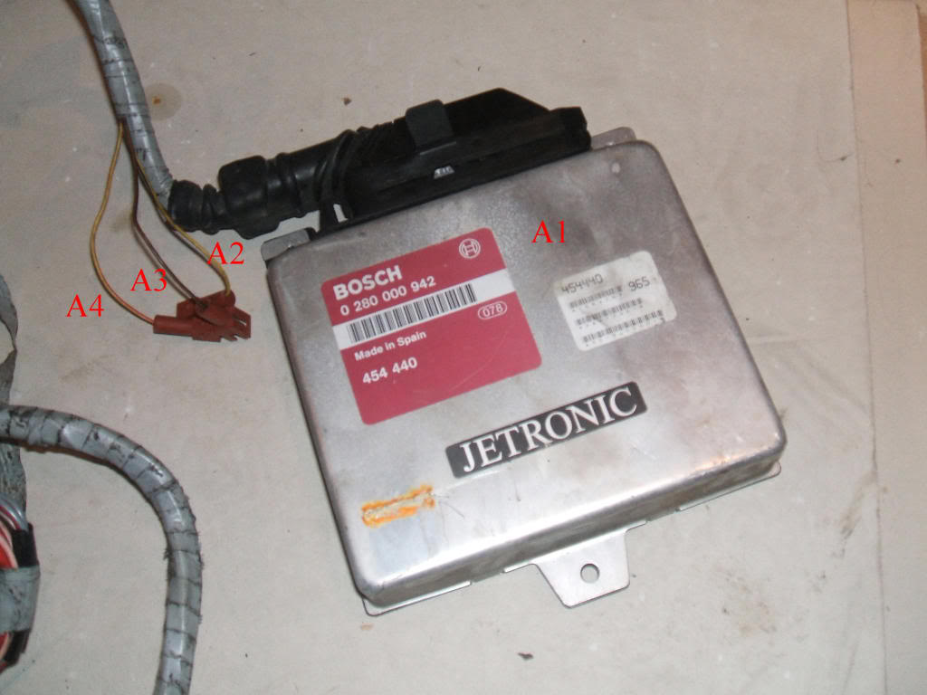

    A1 Jetronic Module
    A2 Test Point
    A3 Test Point
    A4 Test Point

    B1 Connect To R5 Loom From Here
    B2 Fuel Pump relay
    B3 Module fuse
    B4 Fuel Pump Fuse
    B5 Modules relay

    C1 Ignition Module

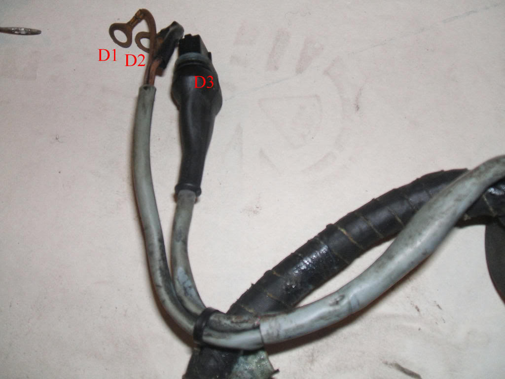

    D1 Earth near to injectors
    D2 Earth near to injectors
    D3 For Injectors

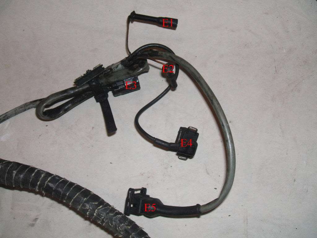

    E1 Test Point
    E2 Test Point
    E3 Volvo Sensor In Sump For Volvo Gauges
    E4 Knock Sensor
    E5 To Idle Control Valve

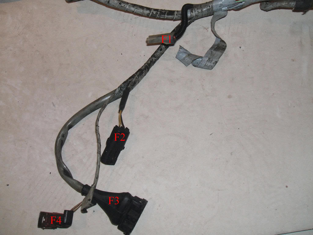

    F1 To Alt Live
    F2 To Tdc Sensor
    F3 Throttle Position Sensor
    F4 Ecu Temp Sensor On Front Of Block

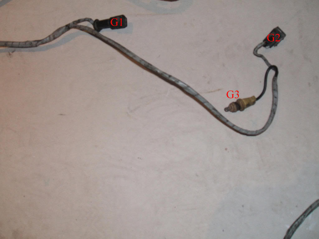

    G1 Air Temp Sensor In Turbo Inlet Pipe For Volvo Gauges
    G2 Lambda Probe
    G3 Test Point

    H1 Volvo Boost Solenoid
    H2 To AFM
    H3 To Coil
    H4 Earth To Dizzy Cap
    H5 Test Point
    H6 Test Point

    unlabelled connectors
    a2,3,4 test points
    e1,2 test points
    e3 volvo sensor in sump for volvo gauges
    e4 knock sensor
    f4 ecu temp sensor on front of block
    g1 air temp sensor in turbo inlet pipe for volvo gauges
    g2 lambda probe
    g3 test point
    h1 volvo boost solinoid
    h5,6 test points
    your better off keeping all the original sensors of the cars original engine and fit with unions etc so that all the gauges calibrate correctly, even sensors from other cars of the same model can read slightly out.

    Quote Originally Posted by Haz View Post
    a2,3,4 test points
    e1,2 test points
    e4 knock sensor
    g2 lambda probe
    g3 test point
    h5,6 test points
    Thanks for that Haz . Pics updated
