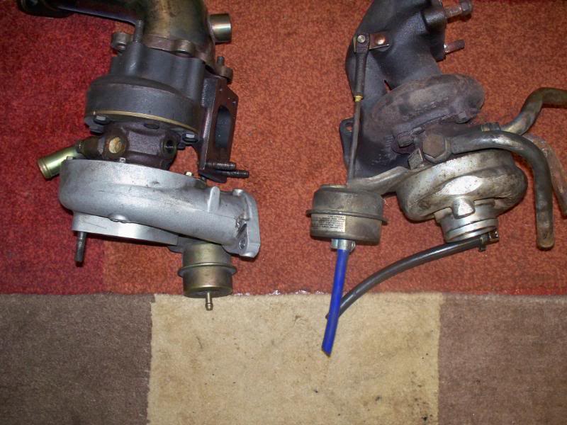

    just swapped my t2 turbo on my engine for a bigger unit 1.7 volvo b18ft engine on my old unit there was a vac pipe going to the map sensor but on my new one there isnt is this just a vac hose heres a pic to help
    old next to new
    Re: t25 turbo
    that black pipe didn't go to a map sensor, it went to the boost control solenoid. the map sensor is built into your ignition module, which is piped upto your manifold.
    you'll either need to drill and tap the compressor cover so you can screw a brass tail in to push the hose onto, or somehow 'T' it into the pipe comming from the turbo. You could drill/tap the intercooler and pipe it into there if you wanted. anwhere between the turbo outlet and the throttle will work fine. You cannot connect it to the manifold though.

    by the way, thats a T28 you have on the left, not a T25

    cheers scoff my new unit is off a skyline one of the two it had
    Re: t25 turbo
    Quote Originally Posted by reevio View Post
    ah right, some of those had T28's. they have ceramic turbine's don't they ? If yours has, you'll need to be carefull with boost, or so I've heard.
    Re: t25 turbo
    Yeah ceramic exhaust wheels. very very fragile, i chipped one removing a turbo, luckily the shaft was toast anyway otherwise it'd be a new v expensive ceramic wheel, not even sure if there available.
    Re: t25 turbo
    yeah, thats it. reevio, you can tell if you have a ceramic turbine by checking for a nut on the exhaust end of the shaft. non-ceramic turbo's don't have a nut, the wheel is part of the shaft.

    mine hasnt got a nut its one complete turbine and is metal
