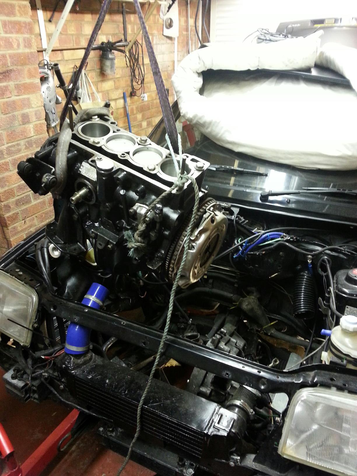

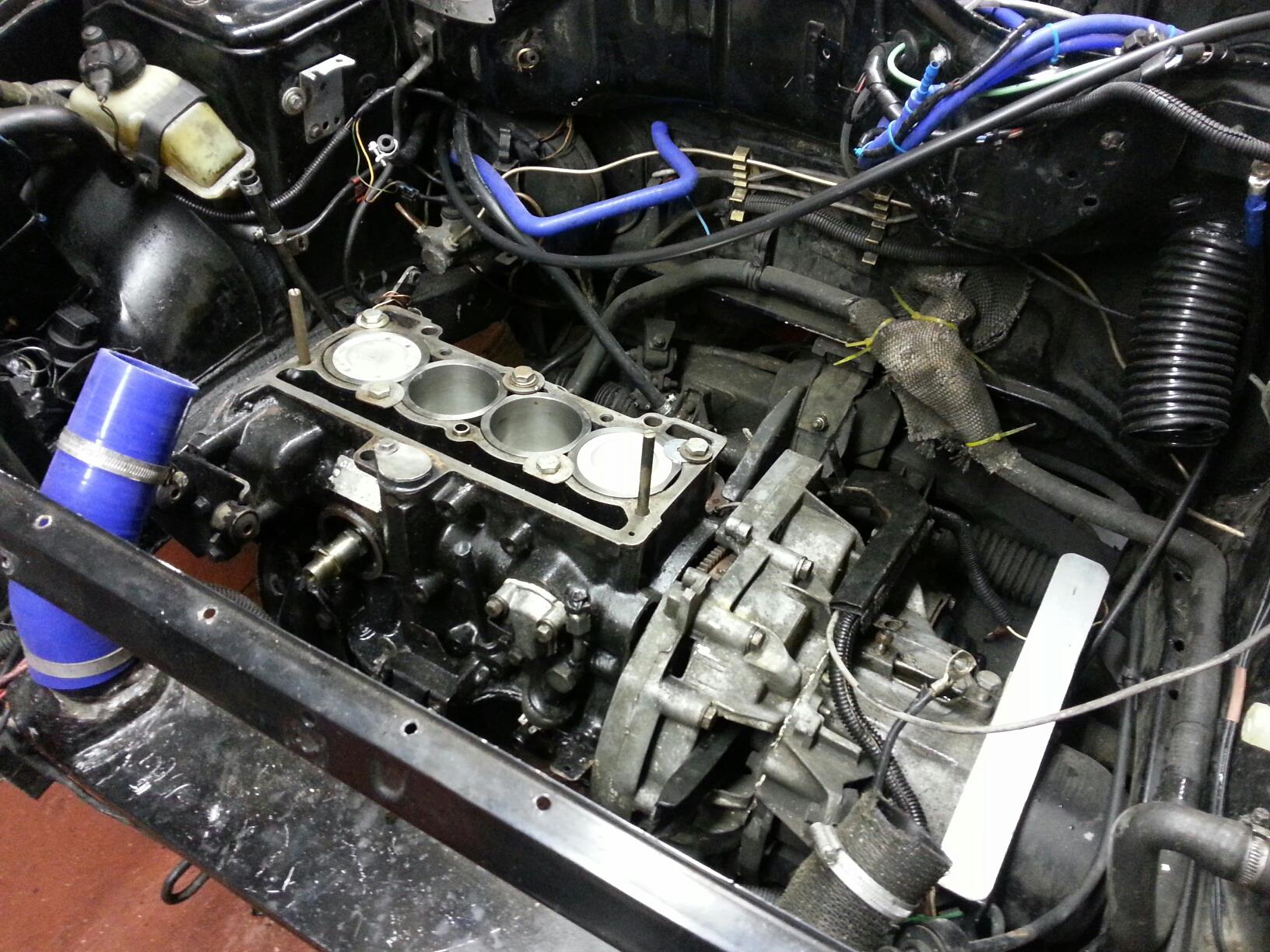

Engine will be out soon so that I can fit my new flywheel and clutch, just need to have the flywheel assembly balanced before it goes in.
Whilst she's all apart, I'll be fitting the new tubular manifold, helix 6 paddle and 172 flywheel to re-locate the pickup for the EFI and get rid of the trigger wheel..

Re: Fluffy is getting on my tits
A bit more progress.......
I thought it was about time the engine went back in....
https://www.rtoc.org/files/Miscellane...35755041_o.jpg
And there she be.........
https://www.rtoc.org/files/Miscellane...02930343_o.jpg
That's it for the time being, a couple of points.
1. Leaving the gearbox in is in my opinion the best way of doing an engine removal but you must ensure that the crank end pully is removed, the front right hand engine mount is totally disconnected, supplementary front steady is removed, both other mounts are loosened off and that the gearbox is supported on the right hand side (as looking from inside the car).
Keep to this and it's a very easy task to both remove and install.
Next up, get the head on and start grafting Dave Reeds down pipe onto my existing set-up. A little bit for tonight.

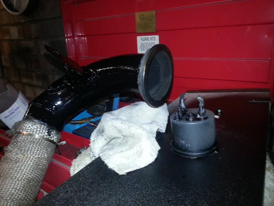

Update
A mixed day really, on positive we got a map on her and she ran (yes I said that right) absolutely fantastic on my brief outing.
However a few things plaguing -
1 - Raceland Manifold is going in the bin - it was glowing up like it was going to melt @ 15psi, it's cracked despite having 2 good braces on it and it kept setting fire to my wrap (fangita:cooter:)
2 - we didn't spot we had thrown the belt after a run and therefore got the water temps upto 118 deg C which I suspect has blown the head gasket as I drove the entire 250 miles on 2, possibly 3 pistons back to Sunny fooking Norfolk. To top it off my headlights packed up as leaving me no option but to blind every fooker coming the other way or have just my side lights on. The good people of England flashed me either way despite me having my Hazards on.
Back to the drawing board again FFS.
That said, I do have a good map on it now - just need to repair the bits from above .
For the record .......
IF YOU HAVE A RACELAND MANIFOLD THROW IT IN THE BIN OR SHOVE IT UP YOUR ARSE, THEY ARE NOT WORTH THE BOTHER

Maybe you shouldn't wrap them?
30 or so other buyers with no(?) complaints.
I heard of standard manifolds that were wrapped and bent and leaked.
Unless it's not weldable, then it'll sell quite easily?

my raceland manifold was cracked after no more than 150-200 miles, i didnt wrap mine but also it wasnt braced, i had it repaired by my mate and sold it on for what i paid for it.
i personally didnt think there was any gains the only thing it seemed to do was make the exhaust note crap and lose the burble
Yeh, I was trying to take out any bottle neck that may exist in my set - up, but tbh, for 200 - 230 bhp, I think it's possibly my turbo now and I won't be changing that any time soon, so the manifold can go. It was quite shocking how easily it glowed up.
It will look good on my garage wall though to go along with the other bit's n bobs I'm breaking and collecting.

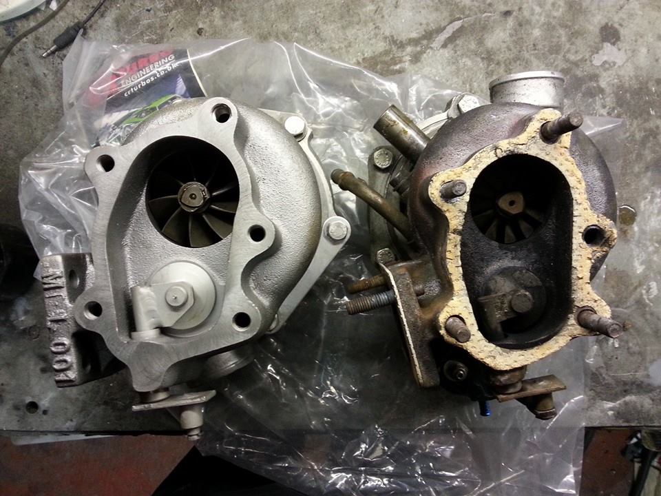

Binks nuts ordered and also turbo gaskets both sides as it was blowing it's tits off. Also worth mentioning, my HT leads look as though they have seen better days and may have been the reason or the '3 pistons only' running issue I had. Fingers crossed, I should be fully up and running by Friday night / Saturday.

All back together again now, going out this morning at some point but seems to to be running fine now. Hopefully be able to get a fair amount of time out of her before going tits up again.
Went cracking - just some adjustments to the downpipe due to interference on the subframe and all should be good.
Only ran 12psi, to get going, but went very nicely - glad to be back.

Cheers fella - just need to have another look at the down pipe, it's knocking on the subframe something cronic:rolleyes: I'll have it adjusted and back on tonight all being well.

Check the flange on the down pipe isn't catching on the inner cv of the drive shaft, mine did that, made one hell of a racket

Not updated for a while, so here we go - I've been happily driving around for about 600 miles now with only 1 minor problem after about an hour the car just cuts out and comes back on immediately. The revs hit the deck and as soon as the needle hits the pin it's back on. It's been doing this for a while but I thought I might have sorted this out with the recent rebuild / relocation of the CAS etc. I've done extensive testing on the car and can't find any sensor / wiring faults ATM, Suppression has been added to the coil feed and I have a few more things to try tonight.
Dwell angle to be reduced to further rule out electrical interference and then thanks to JP trying his ECU to see if it is my ecu for some reason. Hope to get closer to the truth tonight.

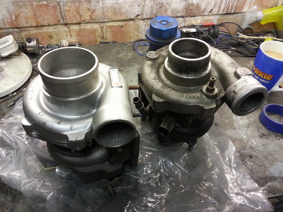

I'm not getting the power I expected, but I think I'm coming round to the idea of a bigger blower, I just don't think mine has got what it takes.
"I'm not getting the power I expected, but I think I'm coming round to the idea of a bigger blower, I just don't think mine has got what it takes."
finally the penny drops:wasntme:, you have been told soooo many times :laugh:
you will also get much better air temps, all though you will have to learn to live with a bit more lag;):cool:
HAndy
I thought that lag may, be an issue, but after Ross put the bigger .63/.64 housing on the back of his, he reported a distinct lack of lag when used on mappable ignition, which he's never done before. We need a session to decide which route is best to go down. I could possibly spend as much developing mine as I could buying a new unit.
Suggestions anyone?
Borg Warner EFR 6258 well that would be my next choice of turbo. Far more advanced than any garrett unit on sale at the moment. Only trouble is they can be hard to source from what I've read and price tag of 1k+ :cry: maybe next year for me.
http://www.turbodynamics.co.uk/shop/...hp-p-4850.html
I wouldn't have thought even as big as a .86 would spool late. I get full boost by 4k with a .86 rear(can't really go into detail about wheel sizes and trim etc... As I don't know) on a b18ft so with the extra capacity and better flowing head you should get full boost a fair bit earlier.
Logg
although the borgwarners do look really good, and have many more gret features as logg has mentioned:cooter:

It really depends on what power you want and the engine can handle and what you want the car to do :) there is no point in having a turbo that is massive and laggy but gives you massive power if you want a fast street car or the other way round you want a drag car and run a tiny turbo and it runs out of steam by 5000rpm. Txt me what kind of drive you are after and power and I will run through some bits and I can look at some compressor maps and come up with a few turbos at different budgets for you ;)

Are you mad, I have a 1.4C1J .86 AR, I think you've lost it. That said, I think you know more about this than I do.
look again andy.......the first turbo is only running a 53.86 turbine wheel with a 76 trim , thats about the same size your running now :sad2: but this has a bigger trim ,so should flow a lot better,aided by a 11 billet blade compressor wheel for maxium airflow, your piss poor turbine is about the same size, but with a much smaller trim , ie your exhaust gases are backing up /reversion/choking your engine, as it cant get rid of the gases quick enough top end, hence your not getting the magic 230 bhp you keep asking /trying to get:sad2::sad2:
you have to purchase the ar turbine housing yourself(exhaust side) prob a .63 in your case.
the second turbo is running a 56mm turbine wheel , hardly world shattering sizes here....:( again you can choose your own ar turbine housing, this maybe a bit bigger laggier than your use to, but you did say rosses was about this size, so please dont **** yourself, if you want bigger whp then you need to pump more air, the turbo is the pump;) the bigger the turbo the more you flow ,the more you get at expense of lag, but as i said both of the above are well within your limits, the turbo logg mentioned had a 58mm turbine, which is bigger than both of the above i mentioned:cartman: you think my turbo's big ... it will prob push around 450 maybe absolute max 500bhp on my engine, without pushing stupid boost and stupidly high air intake temps, to put things into prospective for you:coffee:
also a certain very high powered c1j , was running the same turbo as mine, probabley with a smaller ar. turbine housing, and lot of other mods and managed 405bhp before hitting the wall so to speak, so in relation, the turbo's ive mentioned are well within your scope, stop ****ing around with everything else on your engine, and change the one thing that has been repeated to you, over and over ,for the past 12 months;):cool::D

No need for the .63/64 rear housing.. Mine only ran a .49 rear and that made good power. ;)

Cheers for that Andy - I thought that the trim was the A/R when I read it LOL. what you're saying makes sense, but if I'm gonna spunk £££ I wasnt to do this by calculation rather than, this should do this and this should do that. I need to get in Ross's also to get some idea of the Laggy nature.
I am pretty sure that what you're saying is right now, and it's just a case of getting the right info together now and I should be upto the 230 mark which really is as far as I would like to go on stock internals. I might be pushing it at that.

punching figures ito a calculator and plotting on a compressor map etc will only give you rough figures and will not give you the exact anwsers your looking for only a "rough ball park figure" if your happy with the results ross has had with his , then get the turbine wheel dimesions/compressor wheel dimensions/ air ratio of his housings, and go from there :)

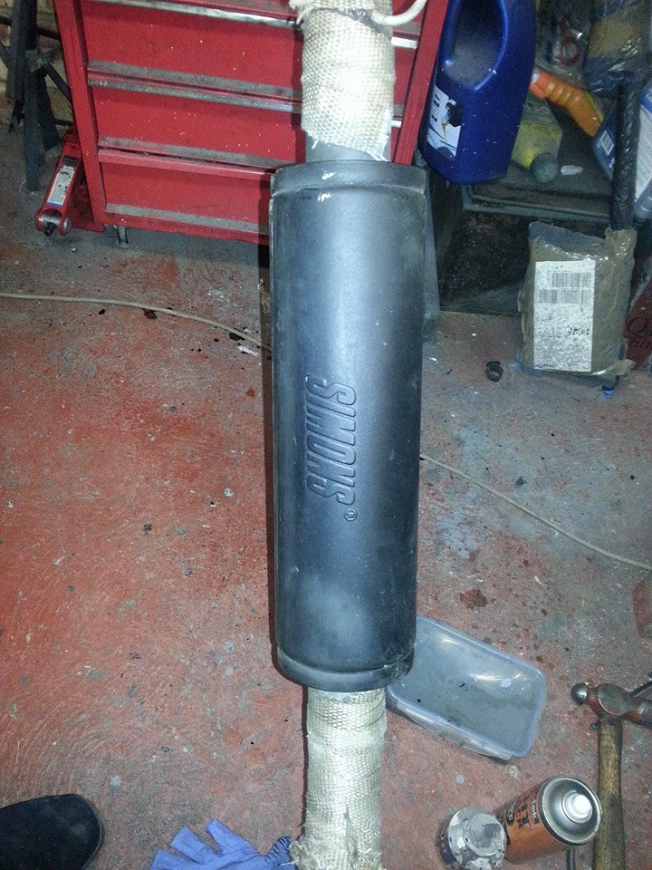

And in a stupidly timed event, I've decided to chop the bottom half of my primary silencer off to try to get me the ground clearance I would like. I'm fed up with hitting speed bumps:mad:This is going to give me about 25mm height.
So I've got the middle bit folded in, but it's now too late to cut through the end flanges. Another day perhaps.

Well the Turbo and BMS downpipe are on, and hanging off that lot is the Dave Reed Sidey which I'm very excited to here on ol' Fluffy. I'ts all just mocked up at the moment as there is a fair amount of adjusting to be done on the exhaust in so much as very small adjustments to the bottom bracket, and adding a few mounting points as I make my way back.
as always, no hurry's at this end. Just waiting for some bit's n bobs to turn up, Heli-coil kit for the Turbo so that I can fix the studs in place on the bottom 2 fixings and just waiting for Hel performance (Hose solutions) to to get back to me in respect to my AN-4 oil feed which needs to be made up.
Then off to Scoff again.
https://www.rtoc.org/files/Miscellane...66589743_n.jpg
https://www.rtoc.org/files/Miscellane...79250787_n.jpg
Just a few of the old and the new - I'll get some more photo's up once I'm back in the garage.
Each wheel is bigger by 5mm and the front is billet, the back end is .49 the front end is quite large @ .80

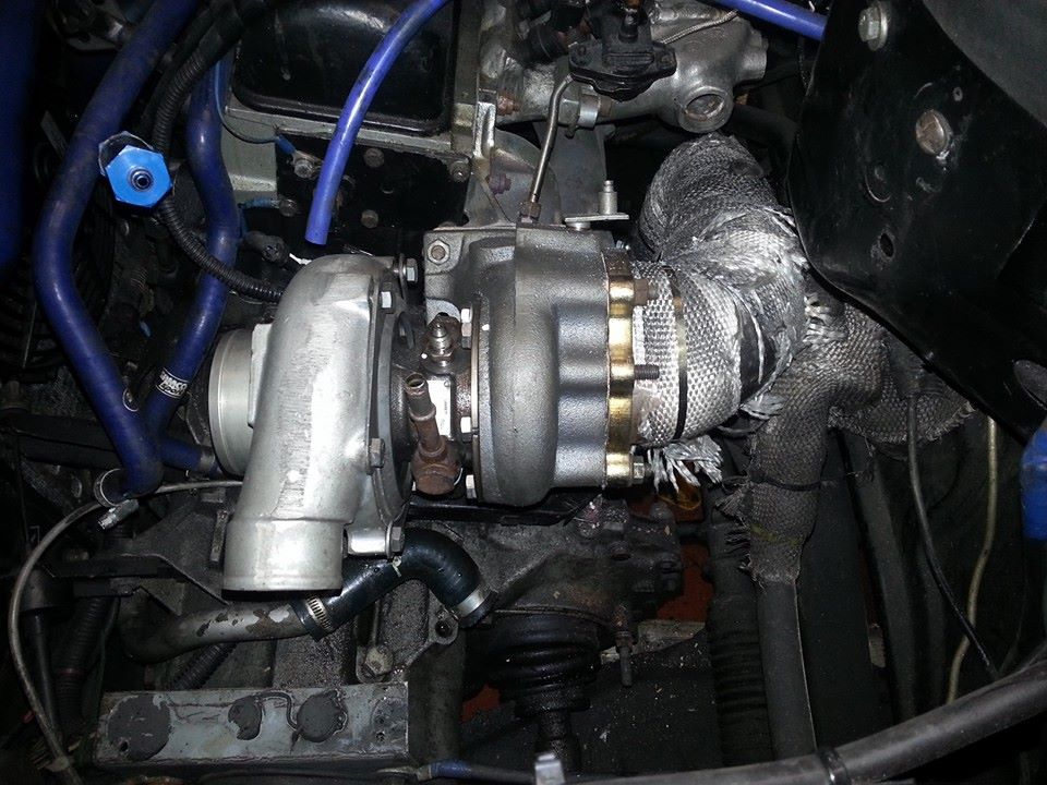

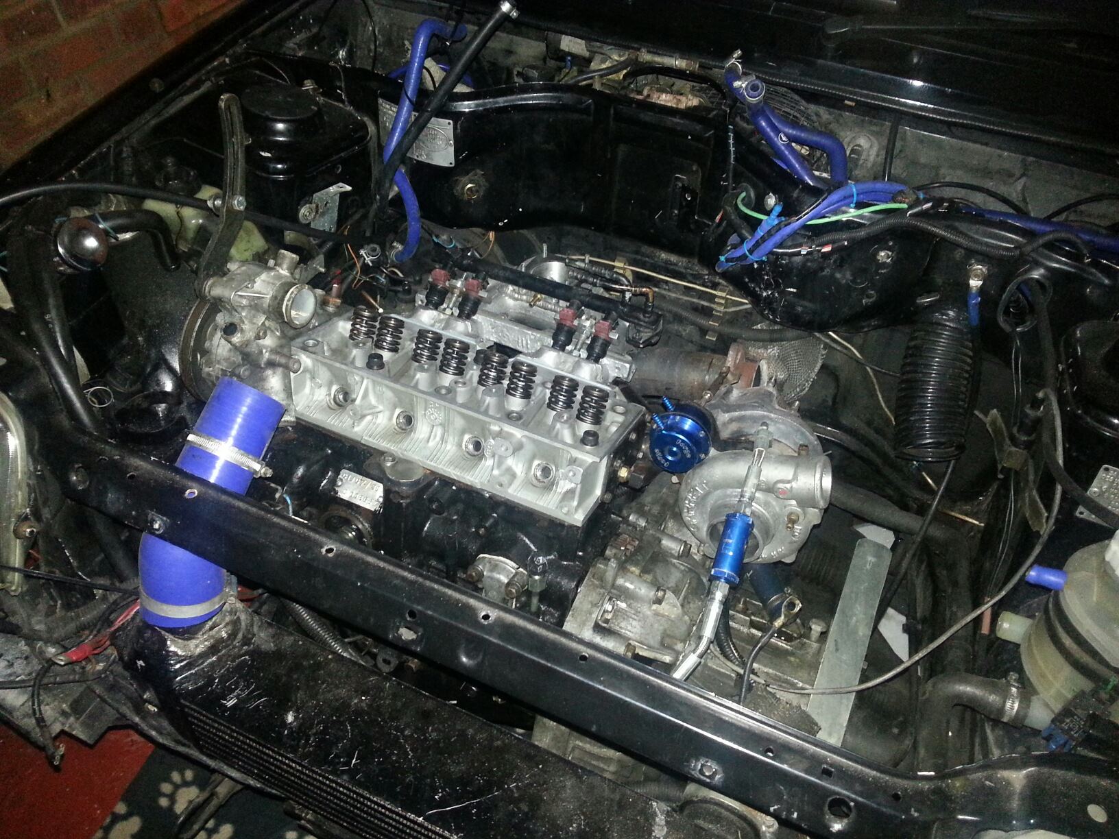

Got the T28 / bms downpipe mocked and hanging on there -
https://www.rtoc.org/files/Miscellane...19758263_n.jpg
Hopefully the silencer will keep my trackday scrutineers happy
https://www.rtoc.org/files/Miscellane...00838907_n.jpg
Also a great and simple mod is the lower exhaust bracket that came with this exhaust (Dave Reed) which replaces the original awkward and bulky item, I'll get some better pictures up once I get back in the garage.
https://www.rtoc.org/files/Miscellane...08_n%20(1).jpg

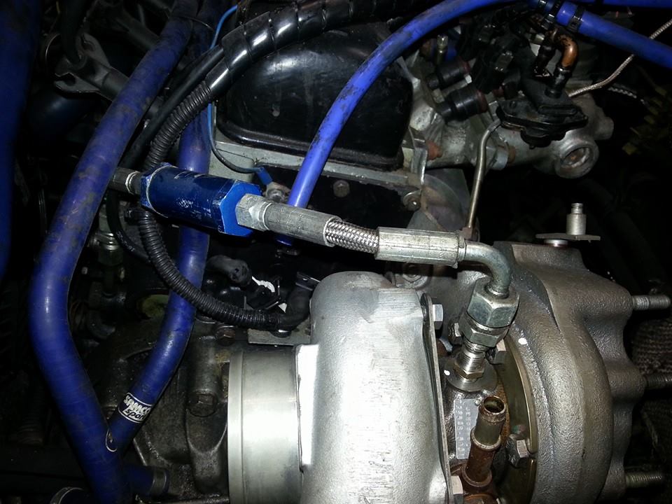

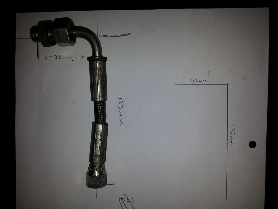

And the last piece of the jigsaw is the oil feed which I'm just waiting on Ben at Hel performance - Formally hose solutions to come up with a short pipe from -4 to -4 with a 90 degree bend on it.
https://www.rtoc.org/files/Miscellane...69641134_n.jpg
https://www.rtoc.org/files/Miscellane...03329258_n.jpg
So all is good.

Why not go on the bay and order up the parts you need for your oil feed from ASH ?
Don't forget you need a resrictor in your oil feed on a dollar bearing setup.

Hope the turbocharger won't let you down mate! As i said it's a bit big for a c1j but the .49 housing will help!
What base housing did they use as .49 rear as it isn't a standard supplied housing.
One thing i'm sure about though, it will be able to deliver 300bhp!
I bought all my AN couplings at Torques UK
