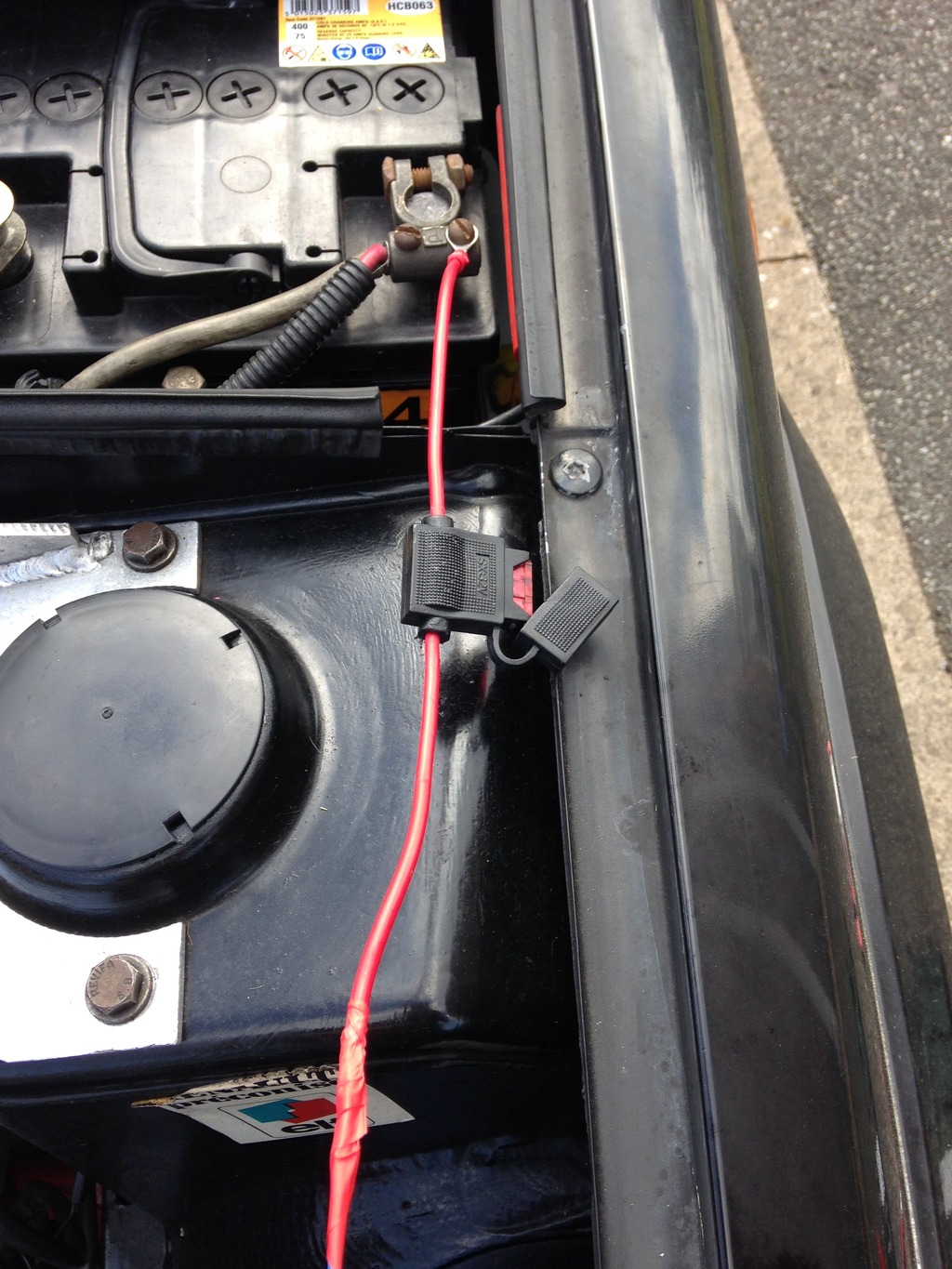

Is either to clean or replace all the contacts or, better, run a new, and large enough to cope with the 33 Amps, wire from the battery +ve terminal to a new 40 Amp automotive type relay which you install just before the under coolant bottle connector behind the left headlight.
Remove from the battery the -ve wire to chassis.
For access I removed the intercooler, air box, short boost hose and moved the coolant bottle.
Bear in mind that the new wire from battery +ve is not fused.
You can, if you can be arsed, remove the left front road wheel and plastic inner wing cover and run the wire through the scuttle panel drain hole and through the inner wing and out under the coolant bottle. Take car to protect or sheath this un-fused wire from long term chaffing and sharp metal edges.

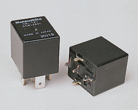

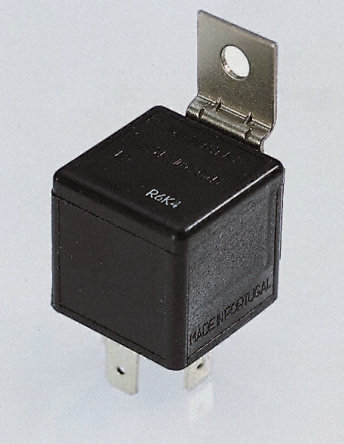

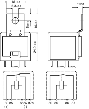

Solder the wire to the normally open contact of the relay. (contact numbered 87 in the diagram) A suitable relay can be bought from www.Maplin.co.uk, part number NO2AW, SPNO (Single Pole Normally Open contacts), 12V, 40A, automotive relay, £1.99inc.
Cut the large white wire a few inches back from the connector block and solder the end from the key barrel to either of the relay coil terminals. (85 or 86)
Solder the end that connects to the connector block to the centre contact of the relay. (30)
Get another new and thin wire, as it only carries small current, and join the remaining coil terminal (85 or 86) to a nearby chassis ground.

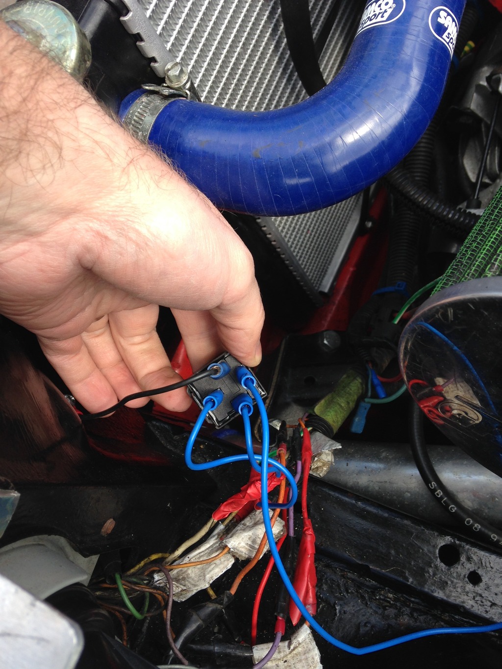

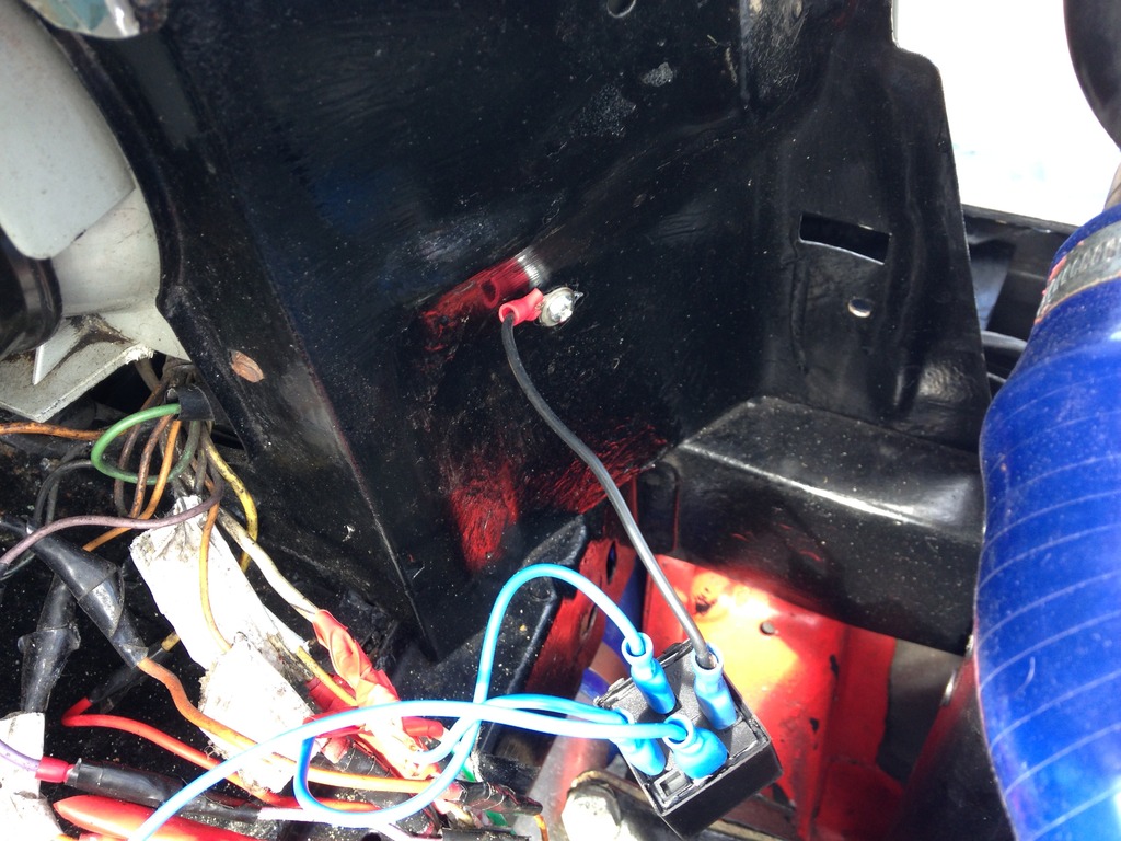

Today, in Dec 2014, I was asked if I had more photos of this as it was confusing. No, I did it maybe 8 years ago, didn't have a digital camera back then, tried to describe everything as well as I could.
Reading it again now for the first time in years I can see why it might seem a bit confusing. It's not so difficult when you buy the relay and start to do the job, it becomes obvious, probably.
Basically, you run a new big red wire from the battery +, via a fuse, to the new relay that you fit just before the white multi pin connector behind the passenger side head light.
Then cut join the white wire that was feeding the white block, run both ends to specific contacts on the relay. Another wire earth the relay coil.
