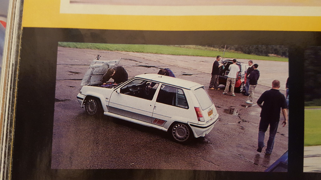

    I first owned the R5 GTT that was known by members at the time for being the login page image, before moving onto a white R5 GTT Phase 2 that i still currently own (and haven't not driven in years ). I was surprised to see my it's 1/4 mile time still on the leaderboard after all this time.

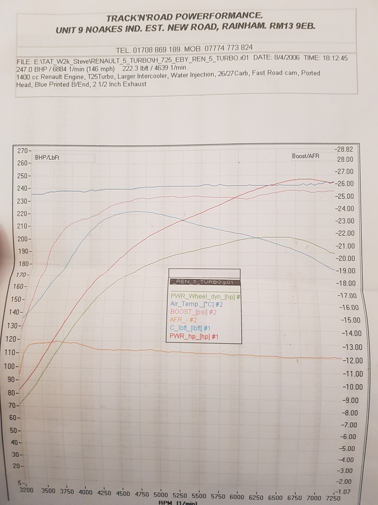

    That was an impressive 1/4 time you managed back then, may I ask what spec was to achieve that pass?

    The spec was exactly this running something like 26-27psi from recollection
    What i would say though is that the car probably wasn't pushing the same sort of peak power as other making similar times back then as the terminal speed was lower by comparison. I suspect the smaller turbo played a role in that, but on the flip side i think smaller turbo that helped the 0-60 time as in reality that was what made a sub 12s time possible.

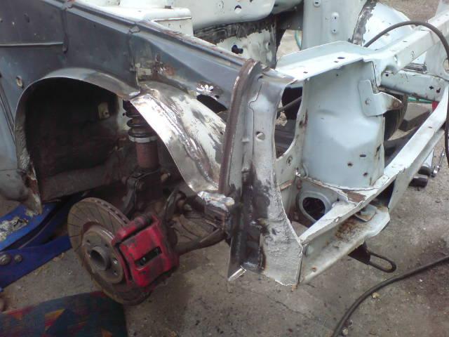

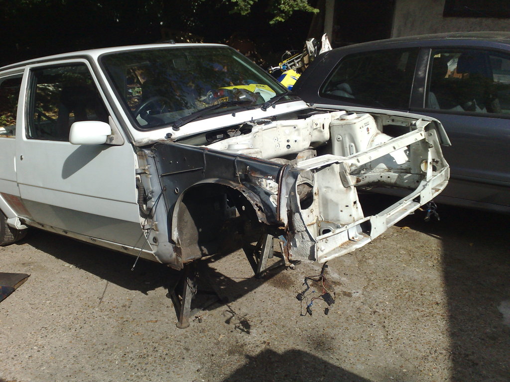

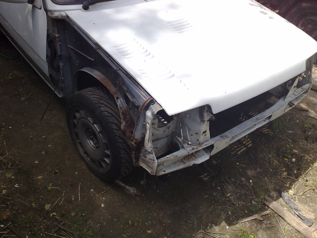

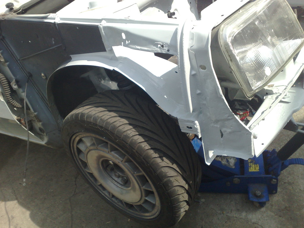

    I may well have posted some of these in the past, but on the basis that was likely 8+ years ago and you asked I've dug these out which basically depict what has happened since it cam off the road.

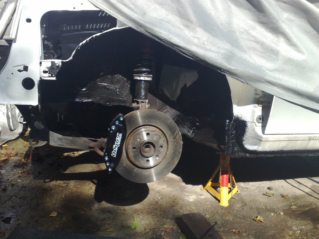

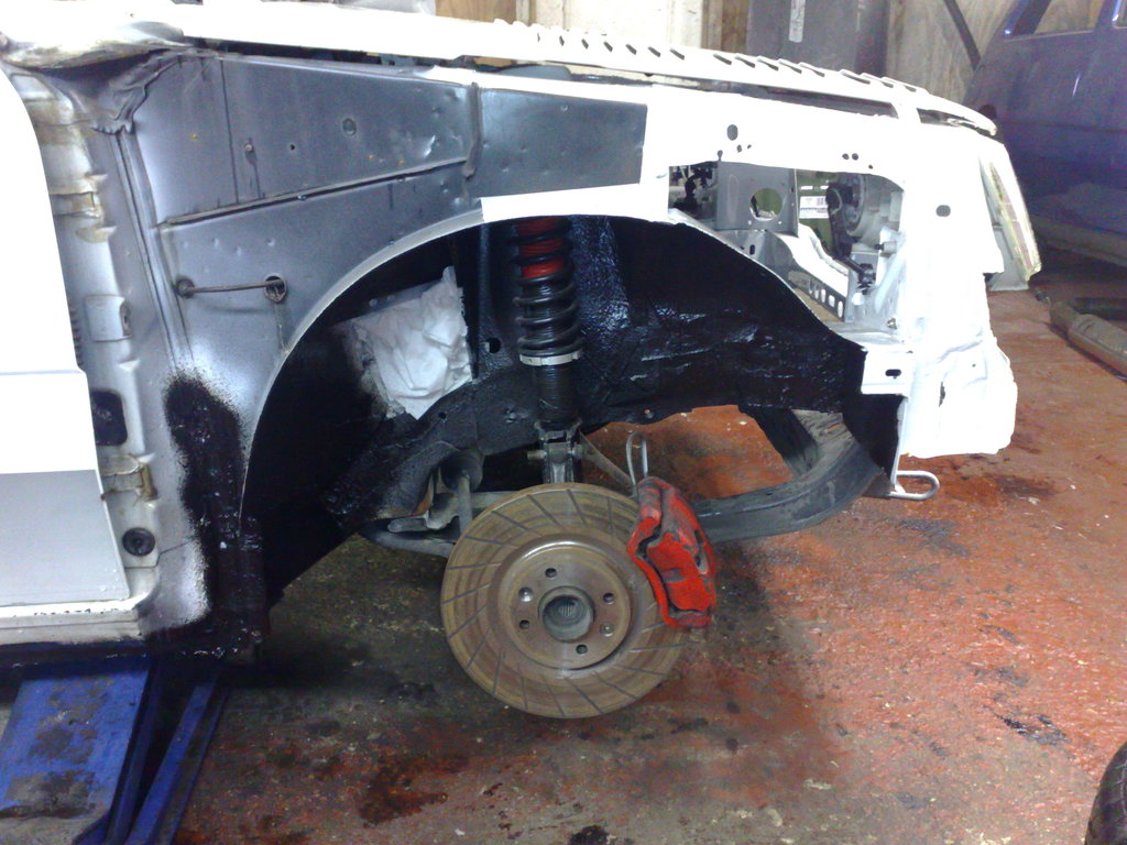

    New Suspension
    New brakes

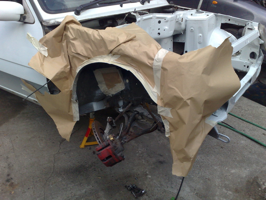

    More rust protection

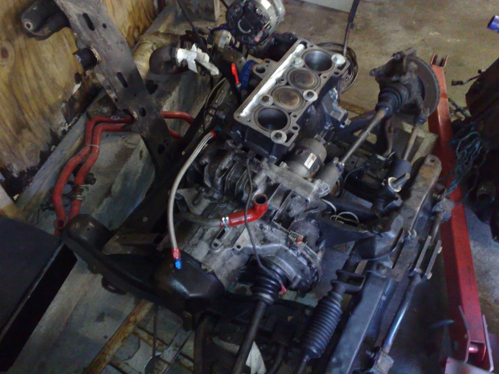

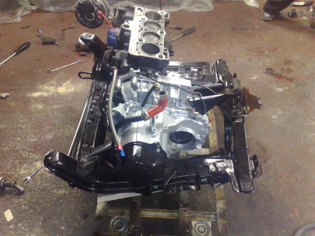

    Engine as it came out of the car

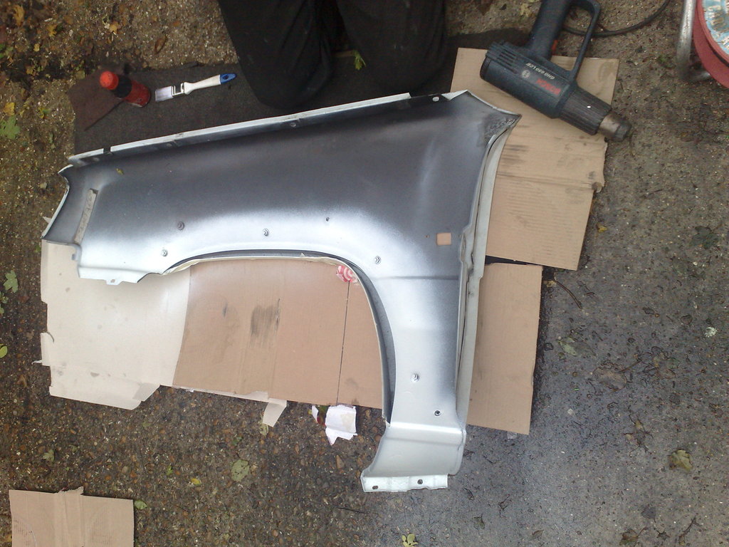

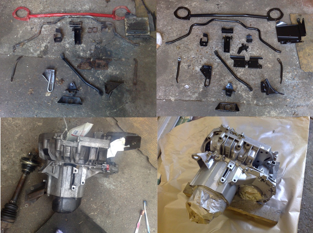

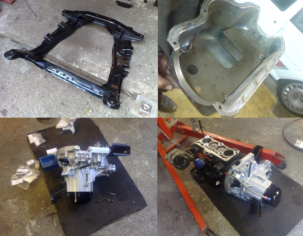

    Bit of powdercoating and painting + LSD Gearbox

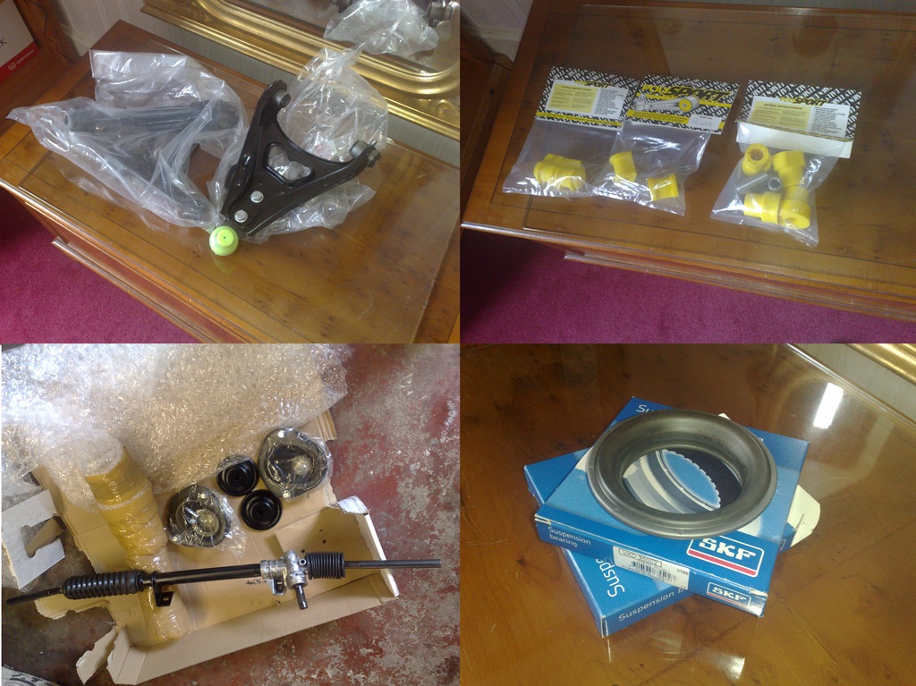

    Some new parts inc. quickrack

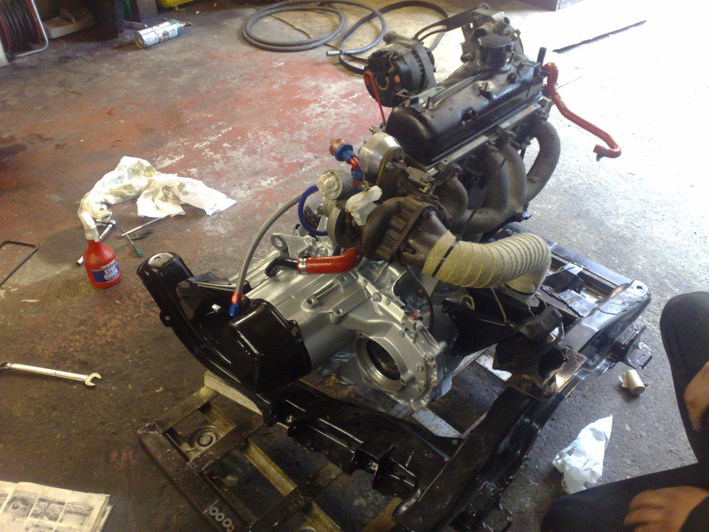

    Baffled sump and powdercoated subframe

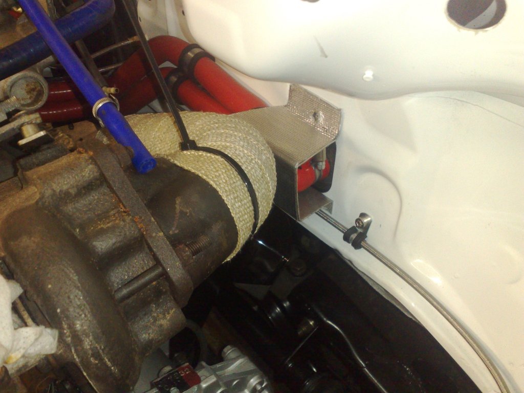

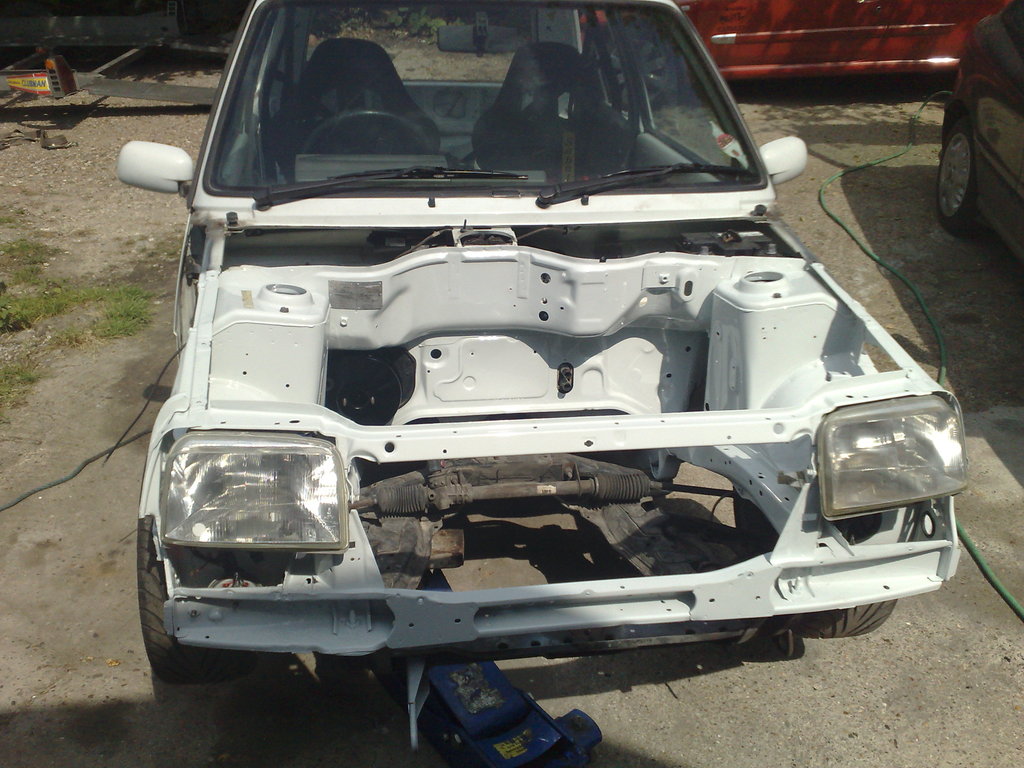

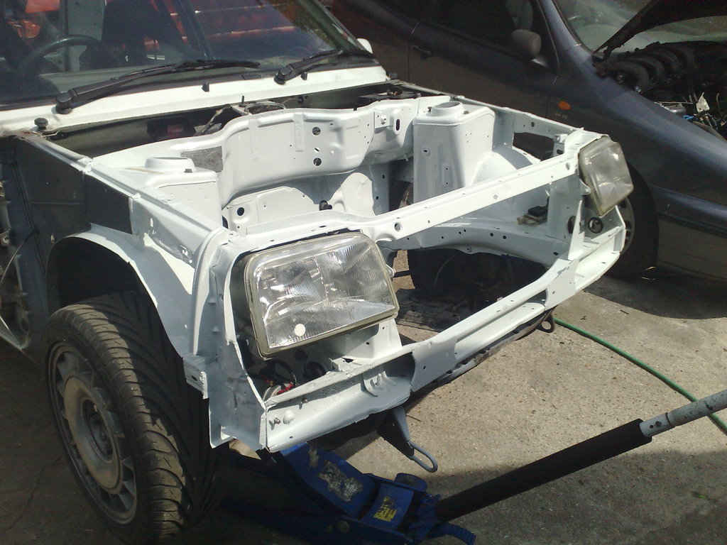

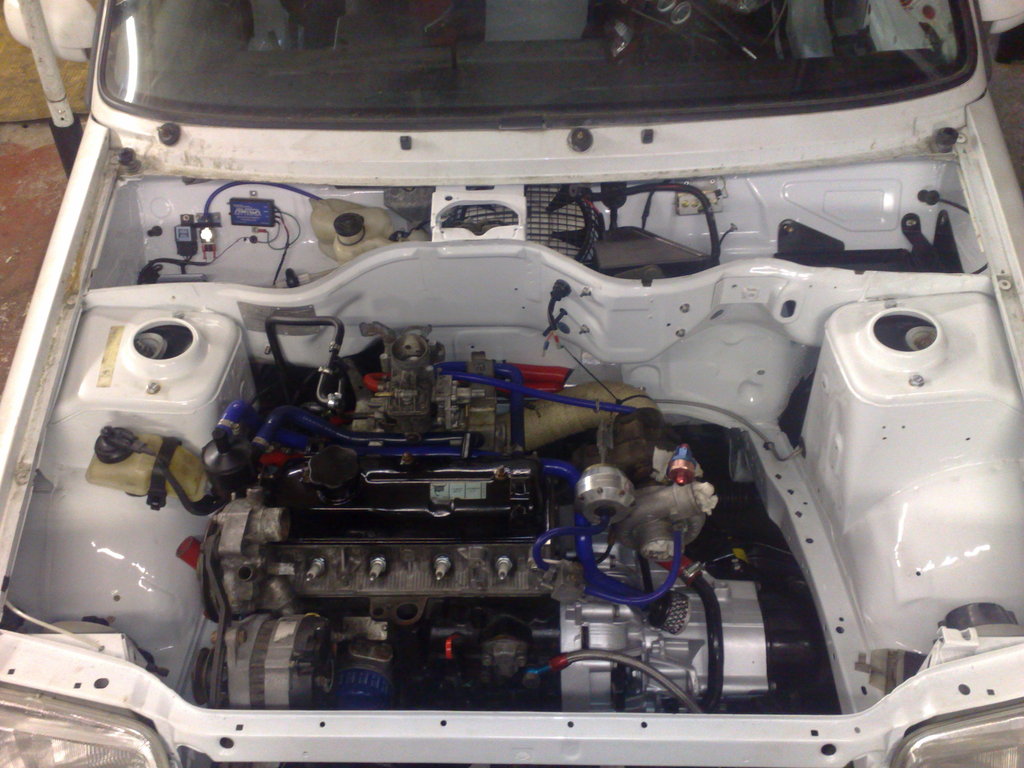

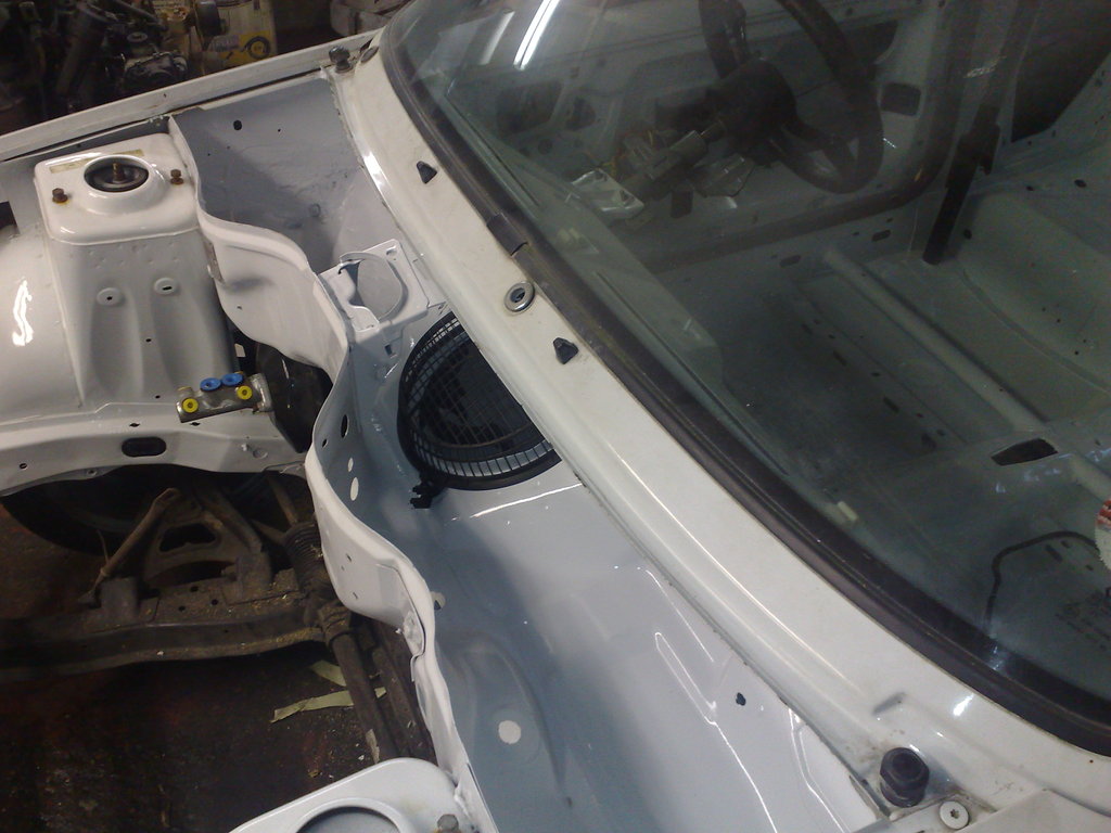

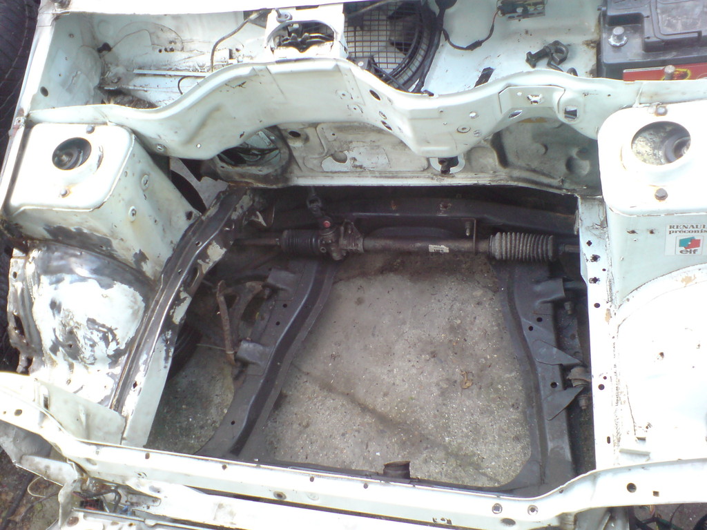

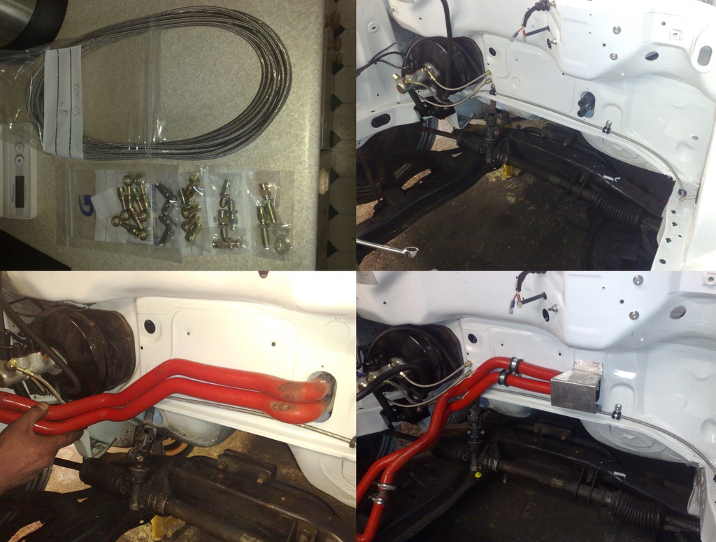

    Running new brake lines and tidying up the engine bay (Heater Matrix pipes used to fail slightly on the downpipe!

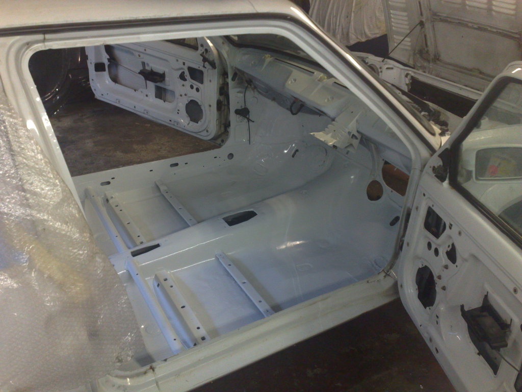

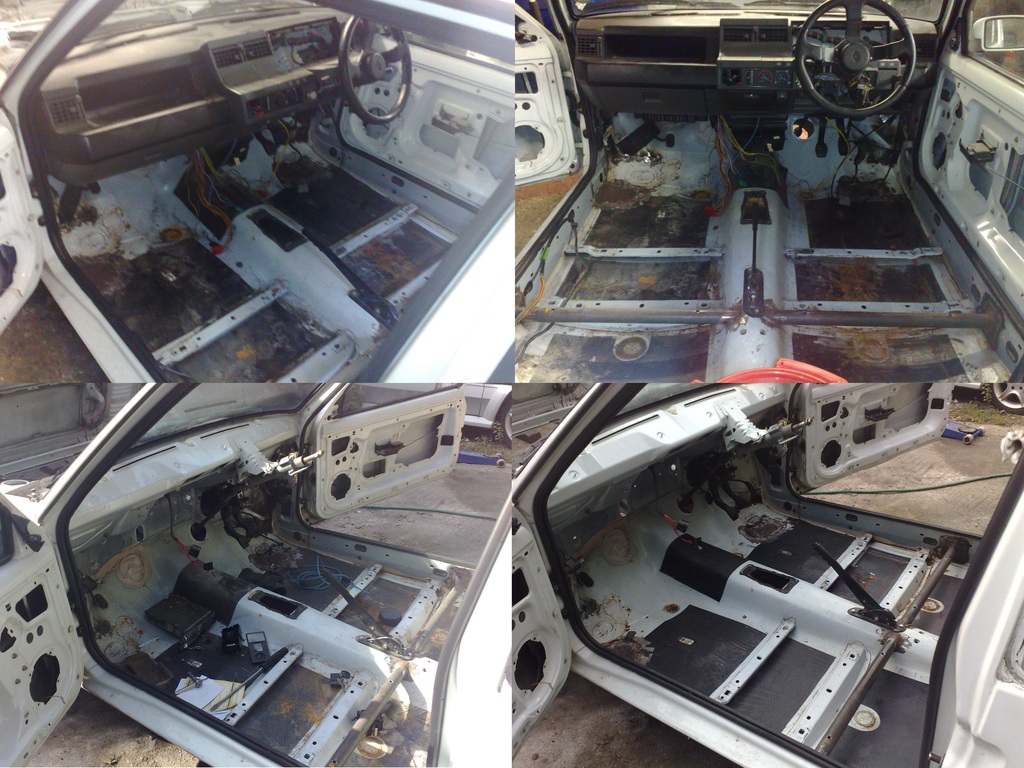

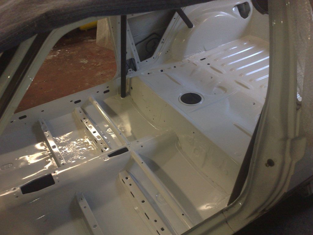

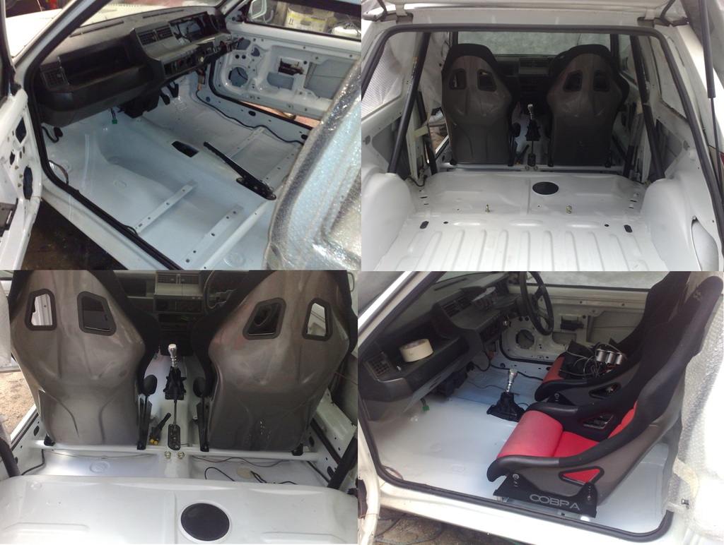

    The inside was a bit of a mess, and added a half cage
    Might notice the addition of an AP brake bias valve tucked next to the handbrake in this one

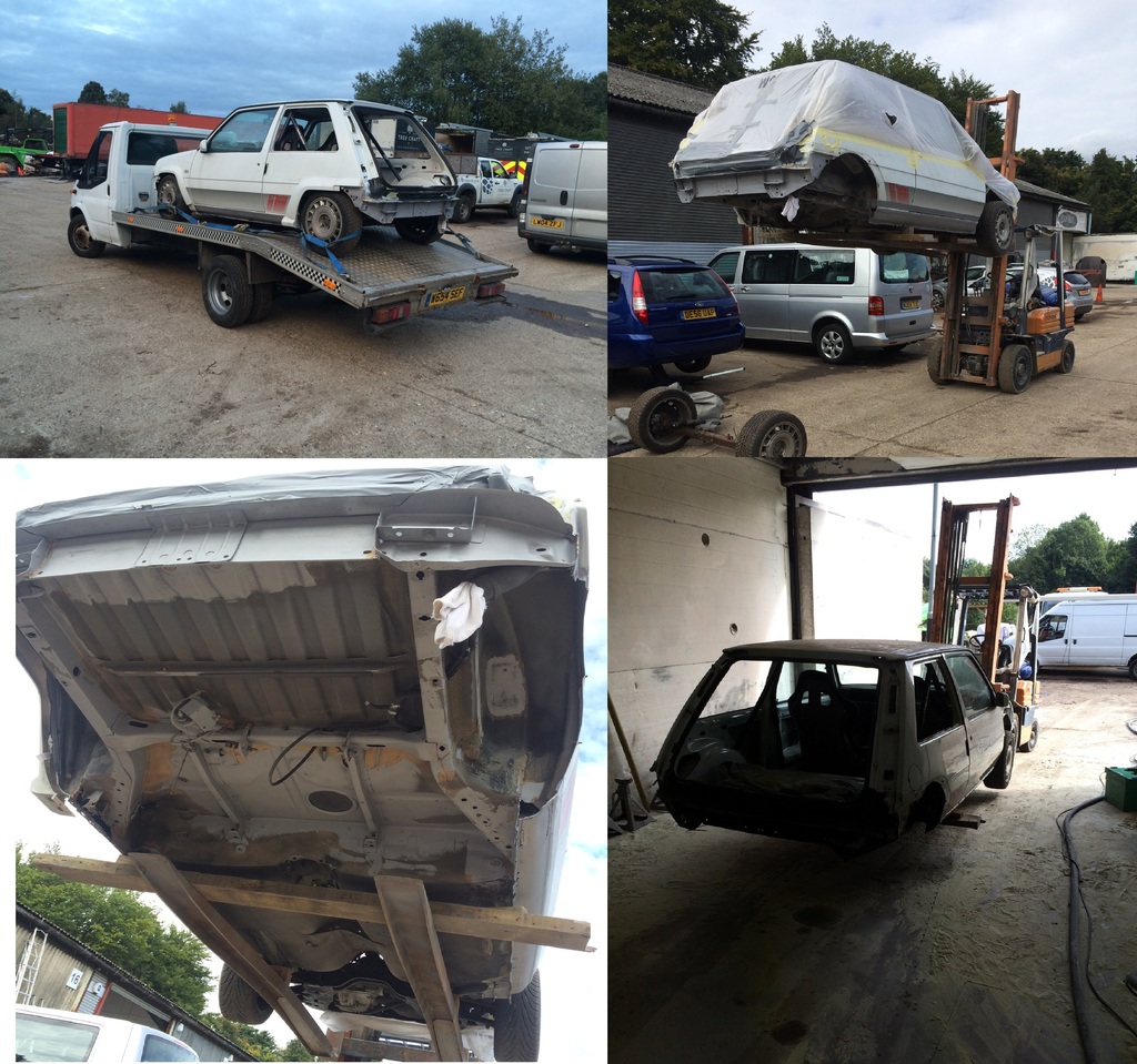

    Underneath has been sandblasted to remove dust and be treated (if you've never seen a 5 on a forklift there it is!)

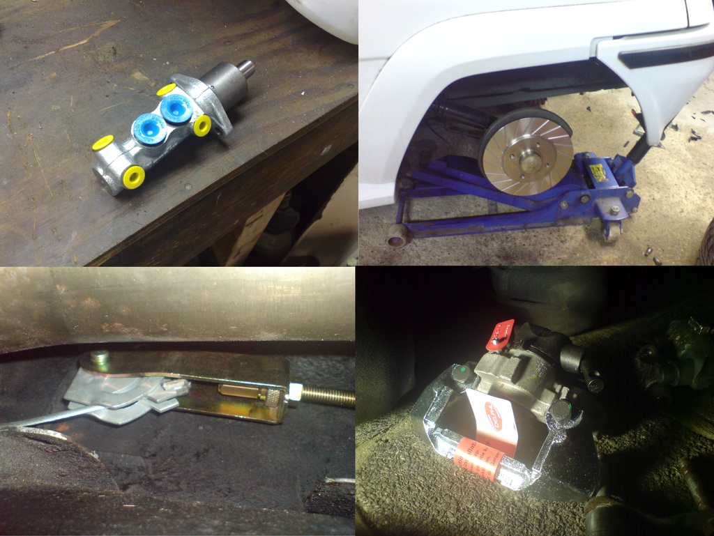

    A couple of other new bit including rear brakes, calipers and handbrake cables etc
