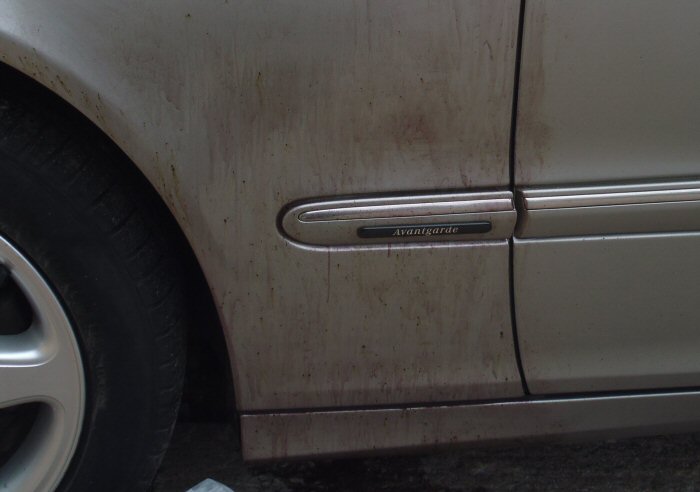

I didn't take many before pictures, but this one gives a pretty good idea
of the car's 7 to 8 month interim neglect...
On my arrival on the farm at the beginning of May 2012, the car, though
quite filthy, still looked like it had some protection on it. A quick jet wash
with plain water confirmed this. I didn't have time for any polishing on this
visit, so it would only receive a pre-wax cleaning treatment.
