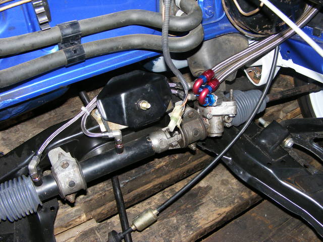

    Lewis,
    I'm very taken with this photo
    Are you able to identify the rack?
    Regards,
    Re: R5GTT Power Steering Options
    Mark one clio rack! Same as I got for my R5.
