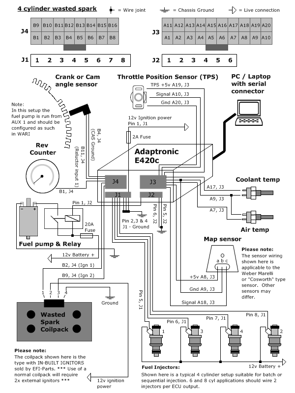

    I've been slowly converting my car to EFI now I'm on the final stage fitting the manifold. I've been using the very handy wiring diagram from scoff website. but Im not sure what way round the wires go on the injector plug as everything else has been numbered so far.

    It doesn't really matter matey.. Just keep it uniform across them is all I'd say, even though that shouldn't really matter
