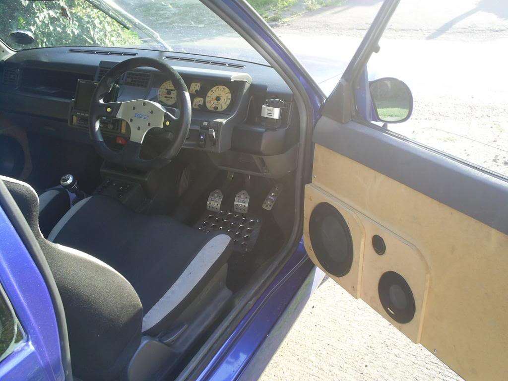

    Non-member TNT Tricky Nicky's Avatar
    norwich
    754
    Re: dvd headunit
    not the best picture, fairly simple to do though

    Non-member modfather's Avatar
    in the park next to sewage works
    1,092
    Re: dvd headunit
    i done that to mine. when you do it make sure you leave enough sapce for the screen to come out. i just cut the hole part out where the heater controls are/was. quite easy to do
    1,092
    Re: dvd headunit
    when i done mine i just cut the panel out where the heater controls are then made up a new panel to hold the dvd player in place. then i put my heater controls down where the stereo should be, but found the original cables for the hot cold flaps etc where a tad short so never reconnected them. i kept mine to the left more rather then in the middle due to the screen catching the indicater stalk when it opens up
