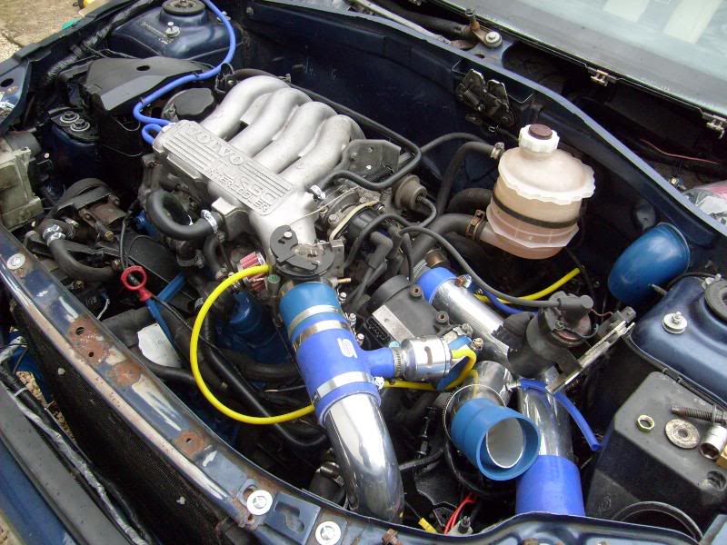

    Re: any pics of complete b18ft conversians
    Here's a pic of mine, its the lastest pic i got but have completed more of it now so looks little different.
    Quote Originally Posted by Markey Mark (BD) View Post
    Markey that does look nice and tidy shame about the tatty strut brace , get some paint on it
    Quote Originally Posted by philg View Post
    Its already being done mate.
    Its a different colour scheme under there now too, air filter is on, boost hoses's done, water pipes started throttle linkage almost finished and vearious brackets also done for all the components.
    is that the manifold that big jim made ya markey?
    Quote Originally Posted by SCHWARTZ View Post
    Yes its the one he made for my car mate
    looks smart, like the fact you can get to the turbo easily. did the gtt down pipe bolt up to it in the end?
    I'm not using a gt exhaust system mate, its a home built exhaust on there so the downpipe is home made too using an adaptor plate Jim made for me to secure the exhaust to the turbo.
